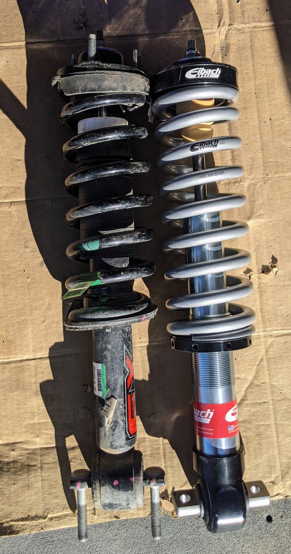

So I've run Bilstein 5200s in my previous trucks (F150, Ram 2500, Titan). They made a big difference in ride - in all cases a more controlled compression stroke and a much better rebound. I only have a few km on the Eibachs, but initially the feel is very similar to the Bilsteins. A more controlled compression and rebound, giving a little stiffer feel. Not uncomfortably stiff, not at all. As I've said before, the stock suspension was bump, bounce, settle, and with the Eibachs it's more like bump, settle.
The stock shocks give a bit of a mild wallowy feel, like the back end is not as connected to the road as I like. I think the Ford engineers may have been leaning more towards slow-speed rock crawling, maybe thinking that the softer valving would also help make the ride a little more plush on the highway. It just didn't feel quite right to me.
I'm glad I popped for the Eibachs, although my wife and non-car guy friends all think I've lost my mind for replacing the shocks on my brand new truck!
As you can see from the photo, the Eibachs are about 1 1/2" longer than stock, and the springs are longer as well. I like the threaded shock body, which will allow me to make fine adjustments in ride height from side to side. That will let me actually match ride height on each side.

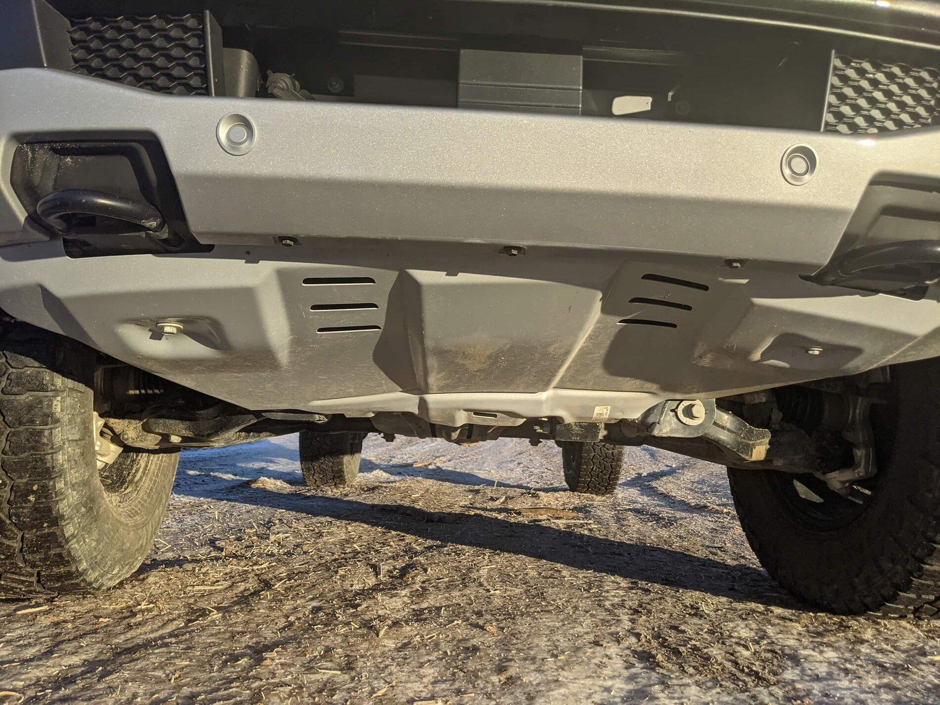

Well, now we know why it's called a bash plate. Took the hit dropping into a runoff that cut into the ice/snow/muskeg at work. I was alone and didn't want to have to fetch a dozer to.pull me out, so I approached slowly, and as the tires dropped into the cut I hit the gas to create some momentum to carry me through. BANG! bounced down, hit the plate, bounced up and across, then another hit when the back tires crossed. The hit on the back was on the flag mount I have mounted in the hitch receiver - no damage out back. No damage to the balance or the bumper, no damage to the suspension or steering.

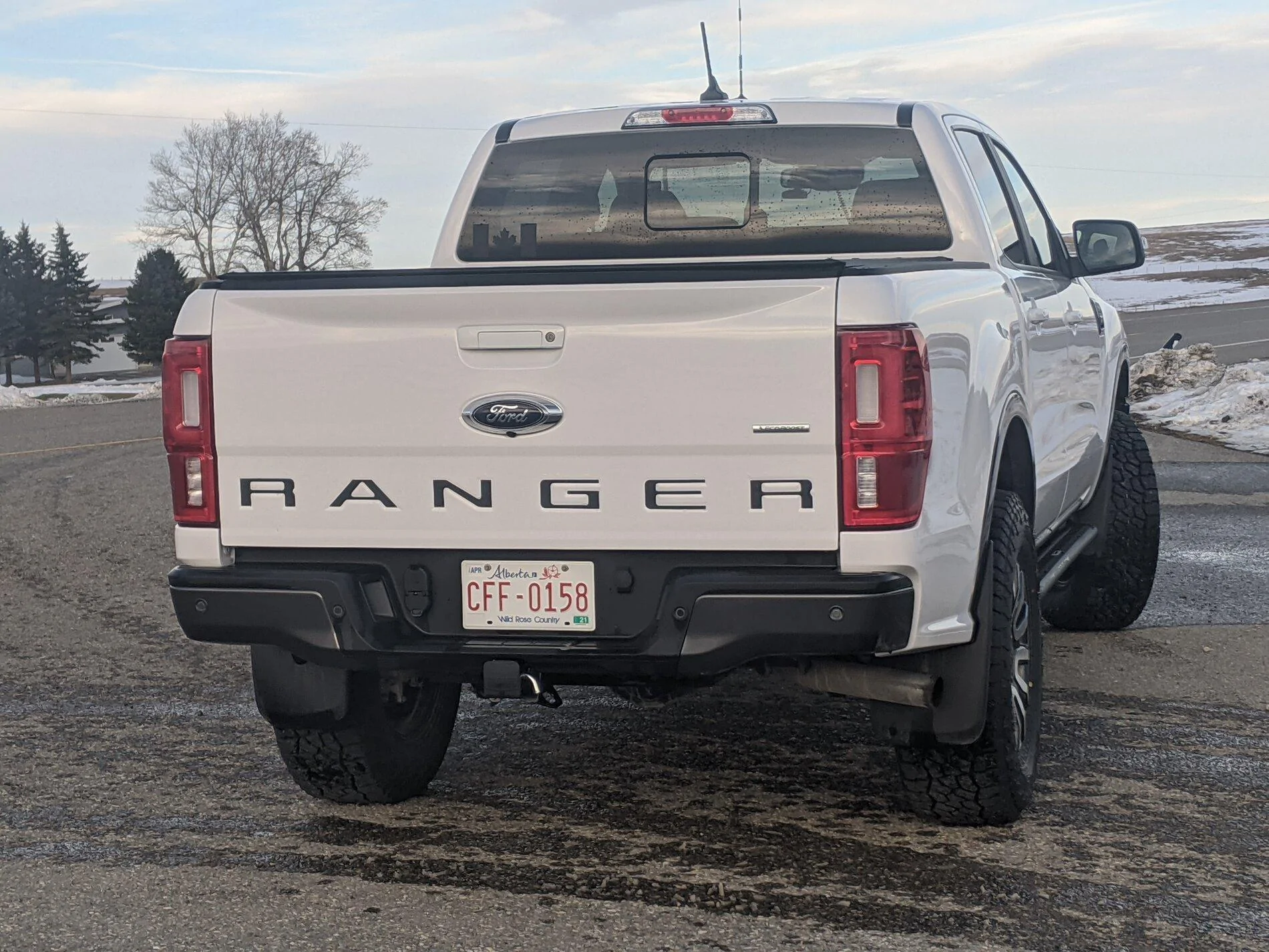

The view from behind. This is with 1" spacers andn275/70R18 tires. I like the stance!
