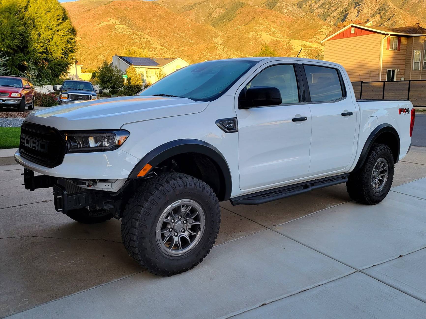

Looks like next on the list is a new battery. After the truck came back from the repair shop I didn't move or start it but noted the next day that the fob wouldn't lock the doors. Didn't think much of it until it still wouldn't work after changing the fob battery. Then I tried the spare fob. Nothing. Crap.
It started fine when it was loaded on the truck both going to the shop and when they loaded it for the trip home. But sure enough, the battery was dead.
The charger jumped to 15 amps and stayed close to that only going down to 12 amps after about 15 minutes, and staying there. I freaked because I don't believe in coincidence and thought somehow the new/used steering rack was drawing excessive current. Disconnected the negative terminal and tried the charger again. It stayed at 12 amps.
So, good and bad. Good because that means it isn't a draw from the vehicle. Bad because that means a new battery. This one probably has a shorted cell. It's likely the original.
Read up and apparently all models use the H6 size except the Lariat, which uses a slightly larger H7. I've always had excellent luck with the Everstart batteries from Walmart so that's what I'll get. Ordered a new insulator jacket for the slightly larger battery.
Also decided the black textured Bushwhacker flares make it look like a utility vehicle. Took a new set of Husky smooth flares (which I'm pretty sure use the same mold shape as the textured Bushwhackers) to a reputable local body shop to have painted the original dark metallic gray trim color, Magnetic (J7). They also said it shouldn't be a big deal to pull the passenger side frame rail down slightly to even them up.
Told my wife I feel like I'm 9,500 miles into a 10,000 mile journey. She suggested I'm probably still around 9,000. She's right. Perspective is a bit skewed these days.

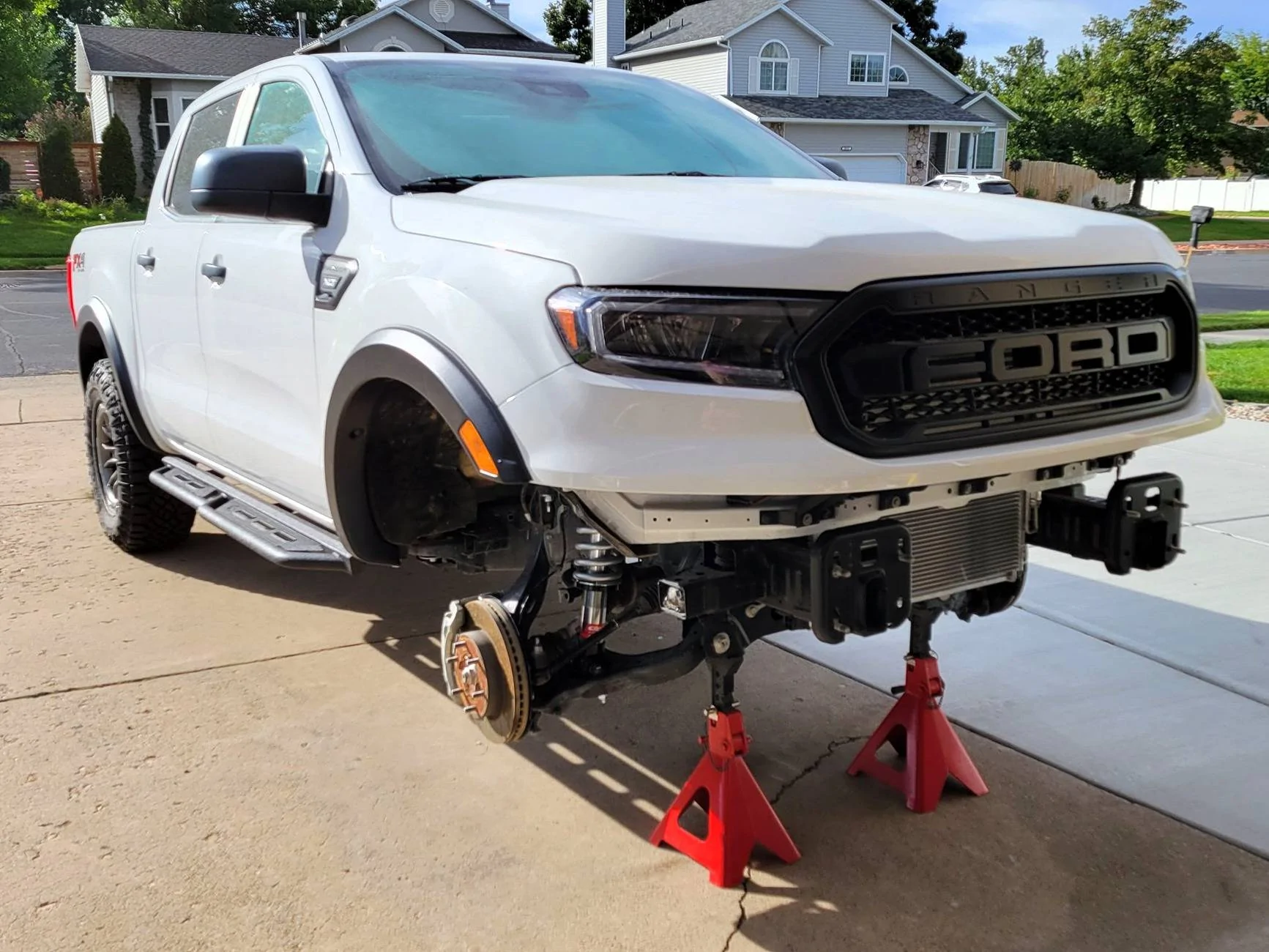

Thought I was ready to finish the front suspension after getting the Eibach struts installed. But could something actually go right? Of course not. This is "Whitemare," the salvage Ranger rebuild project from hell.

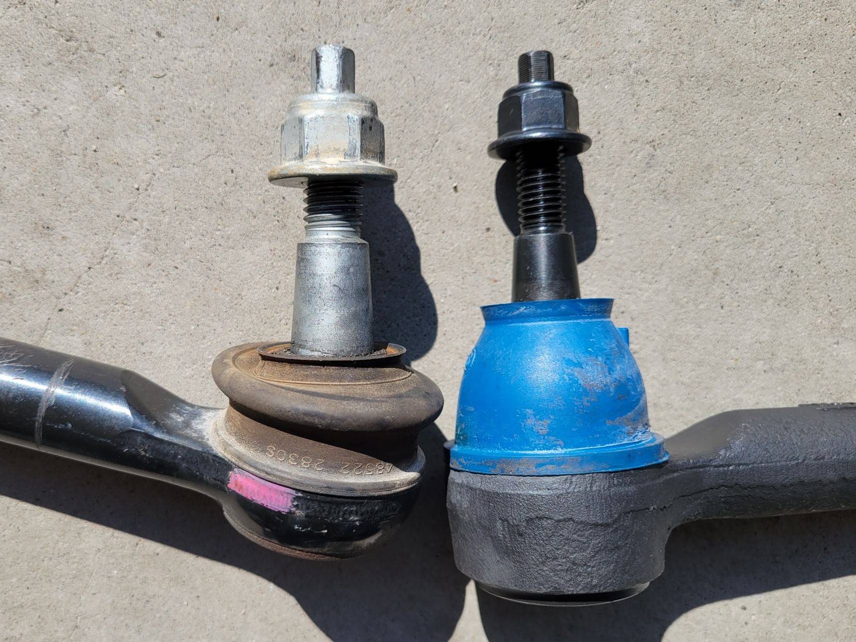

The shank and bolt on the Mevotech tie rods I ordered are smaller than the OEM tie rods. When Ford Parts tie rods were then ordered, which I should have just ordered in the first place, they were spec'd for 2020-2023. Most aftermarket parts, including the Mevotech tie rods, are spec'd for 2019-2023. So it's possible the ones on the 2019 are slightly different. Still waiting for the correct tie rods to arrive.
The alignment of the front driver side components isn't terrible, but not great. For some reason the totally incompetent body shop installed new hood hinges, which I did not supply to them and were totally unnecessary. The original hinges had not been compromised in any way. The new hinges they installed is the only thing I can account for the hood being about a quarter inch too far forward. There is no additional range adjustment available. The hood latch receiver hits the plastic pieces at the front of the latch. The only way I can see to properly adjust the hood at this point is to elongate the holes in the hinges.
With the front of the hood adjustments made such that the gap around the grill is uniform, the hood-to-fender gap on the driver side is wide enough to almost make it look like the hood has been released. And then this morning I noticed a big crack in the paint where the damage from shipping was repaired.

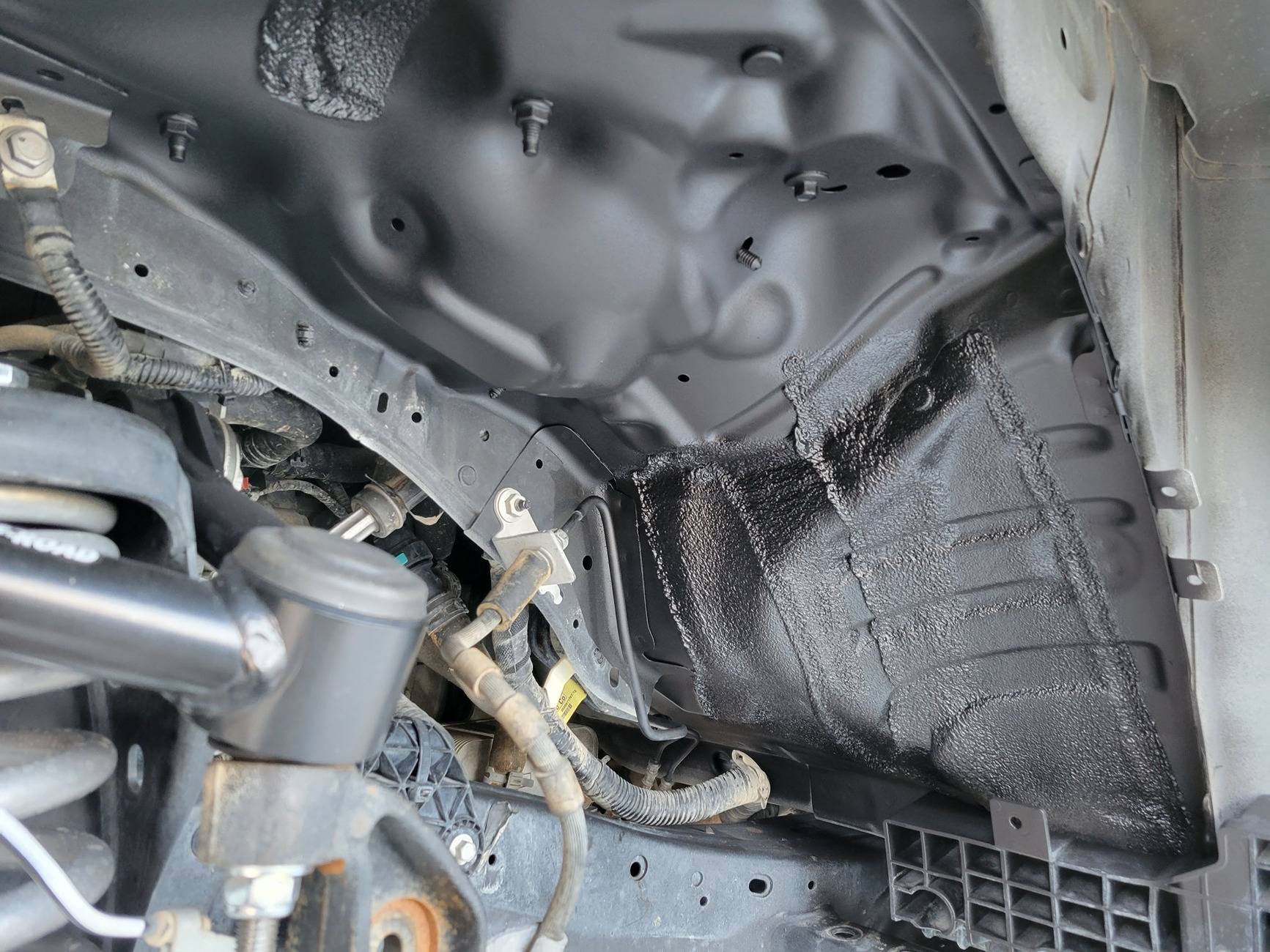

Because the fender liners are mostly rigid and the trim mounts are hidden above the liner, I thought the trim would pop out when pulled. Nope. The fasteners that secure the trim are one-way. The only way to get them out properly is to squeeze the pins from the back. But the pins are hidden above the fender liner, and the liner can't be removed without removing the trim because part of the liner is attached behind the trim. Ended up breaking several of the mounts on the trim trying to remove it last year. The liner would have to be folded down and each push pin squeezed from the back to remove the trim without damage.

Well folks, Whitemare has smacked me upside the head once again. The OEM tie rods arrived. The passenger side is correct, the driver side is not. It's the same smaller shank and bolt as the Mevotechs I received and returned. However, as irritating as it is, this mistake appears to be my own.
I did not notice on the original ordering page that there is a parts split in Rangers manufactured before and after 6/2020. I had mistakenly ordered the driver side for a Ranger manufactured pre 6/2020. Mine was manufactured in 8/2020. It appears I just got lucky on the passenger side.
Just sent in a request for a return. Also just ordered the correct one along with a couple of nuts. They don't even come with nuts, which is stupid because you aren't' supposed to reuse the nuts. New nuts should always come with new tie rods. They do with aftermarket.

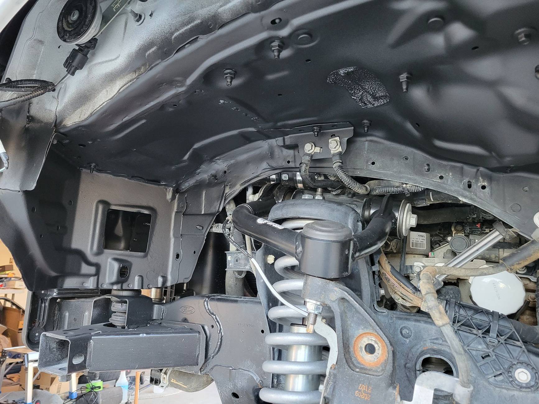

Tonight I sprayed some bedliner in the fender-wells to clean those up a bit. Still need to cover the big square opening at the front of the driver fender well, but the spray-on bedliner looks really good. It's some Rustoleum advertised as super tough and impact resistant. Put on two coats. We'll see how it fairs after some of my 70 MPH sprints on desert roads. Of course by the time I get it ready for that there will likely be snow on the ground again so...
Yes, the trim on the wheel wells are hard to remove. I made a tool out of hard plastic similar to a trim tool and drilled a beveled hole in to use on backside to depress the clip. By accident I discovered the middle ones 3 or 4 not sure on exact number, those slide off without removing clips. Sort of like a keyhole shape.
I was lucky, and removed all 4 of mine without breaking any. Then had bed liner sprayed on them. First time removing trim without breaking a clip or 2.

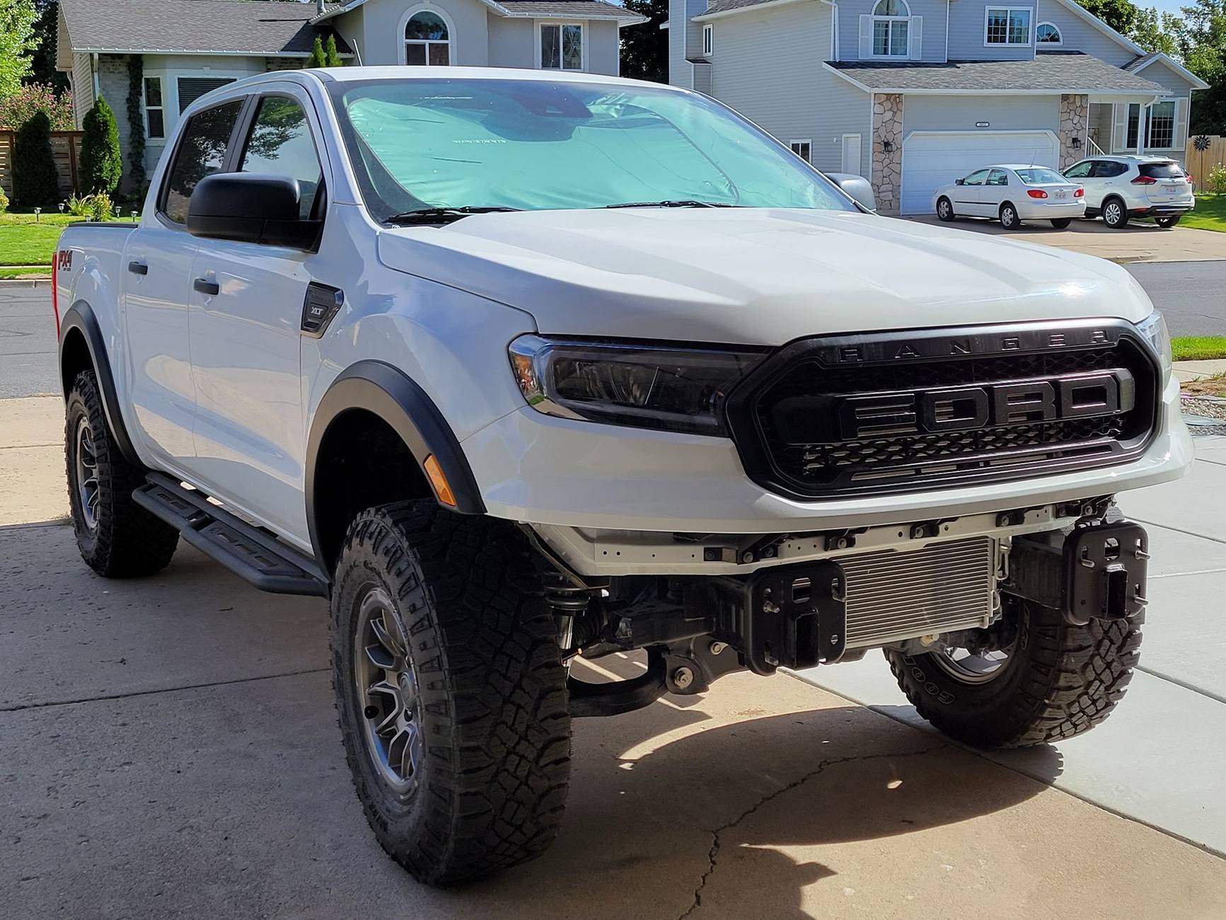

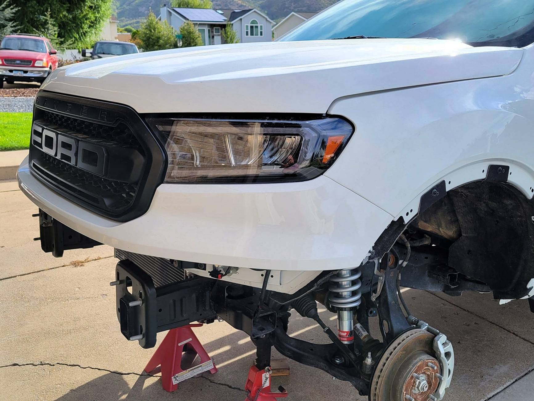

Finally got the correct driver-side tie rod yesterday and spent a good part of today putting everything back together All the fender splash panels, flares, shorter sway bar end links and so forth. Set the camber bolts on the lower control arms so they're out as far as they'll go, put it on the ground to load up the suspension and tightened the upper control arms. I had lowered the front Eibachs by 1 turn but will probably lower them one more turn. Loading up the front end with the bumper will drop it slightly as well. It's a balance of lift vs. CV joint angle. Don't want to have more than I reasonably need.
Cleaned the rust off the rotors, added a little grease to the mating surface and used anti-seize on the studs. Might install the 1" BDS shackle lift and rear Eibachs tomorrow. Changed the oil as well.
Here's a good one. Obviously a person isn't supposed to drive on the road with an unregistered vehicle. Where I live I need an emissions test to register the thing. It's had a total of maybe 10 minutes running on the new battery. No driving. It will need to drive for probably a good half hour before the ECU will be ready. Keep in mind it won't get the front bumper until the front mounts are evened up as well.
So, I'll insure it then take it to the emission center where they'll fail it because the ECU won't be ready. Then I'll have the paperwork that will give me 30 days as I recall to finish the emissions, just in case I get stopped. It will go to the competent body shop to level up the bumper mounts, then back to the emissions center to get the emissions certificate. Then off to the DMV for registration and to the glass shop for a new windshield. Somewhere in there it will get an alignment.
Something I didn't really notice until today is the headlights have side-markers built in. I have some smoke markers so may install those.
Oh yeah, and figure out the programming for the new/used steering rack.

Is that the default Eibach lift height out of the box for the front end? I thought they were set to 2".
How much does one turn lower the height?
Oddly, the preset lift height is not listed in any of the material that comes with the shocks. I watched a review before purchasing them in which it was stated that the shocks are set at a 3" lift. They come with a detailed installation guide and at the very end it's listed that 1 (one) full turn of the collar is equal to approximately 3/16" height change. So two turns is close to 1/2".
I'll finalize the height adjustment after the bumper and the rest of the parts are installed. That will be done by measuring the height on each side at the top of the fender lip and making sure they're both the same.
