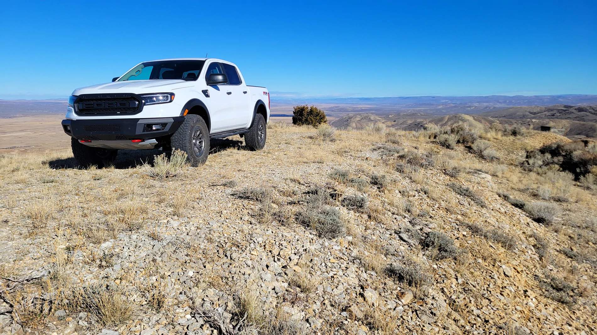

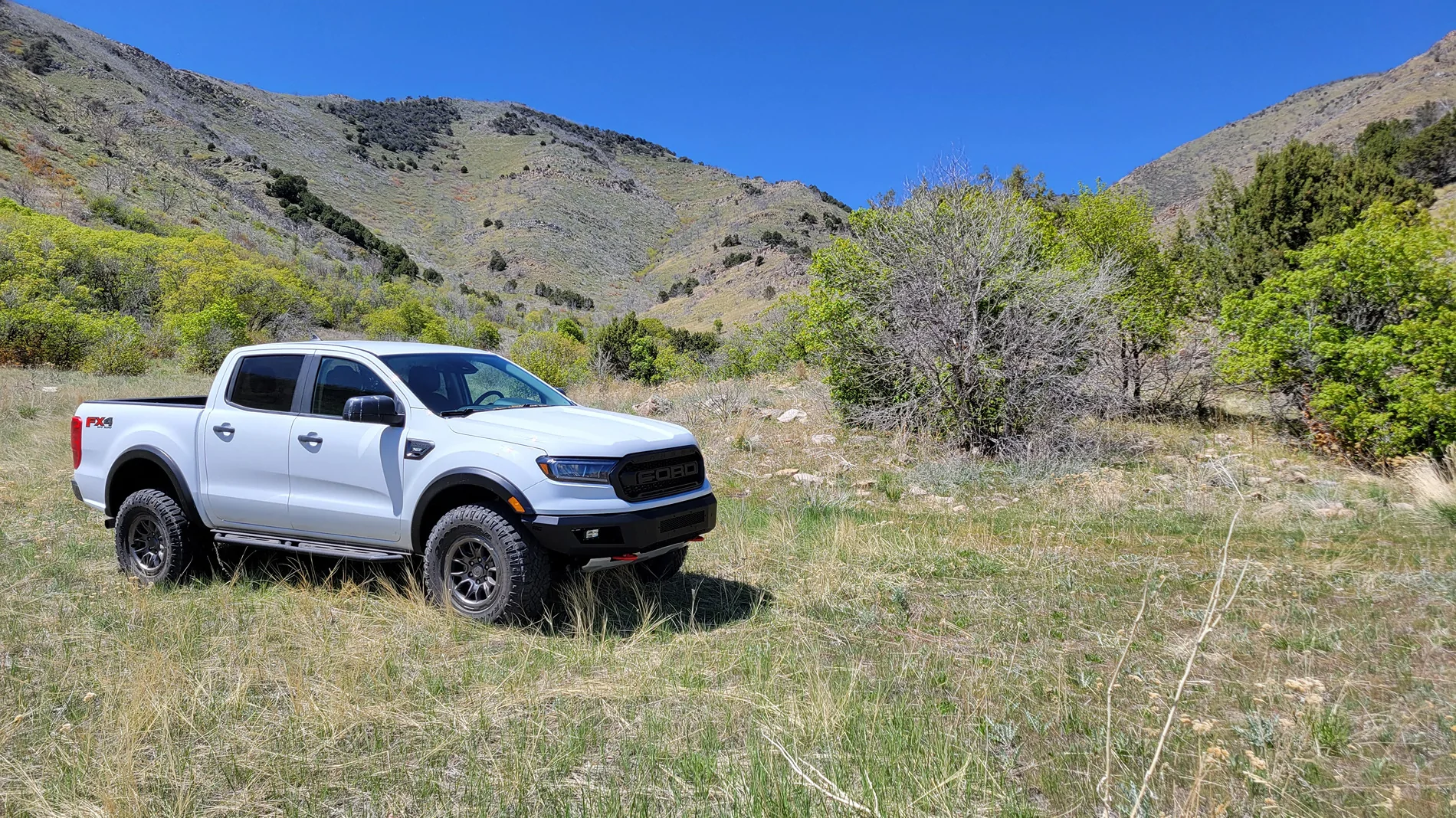

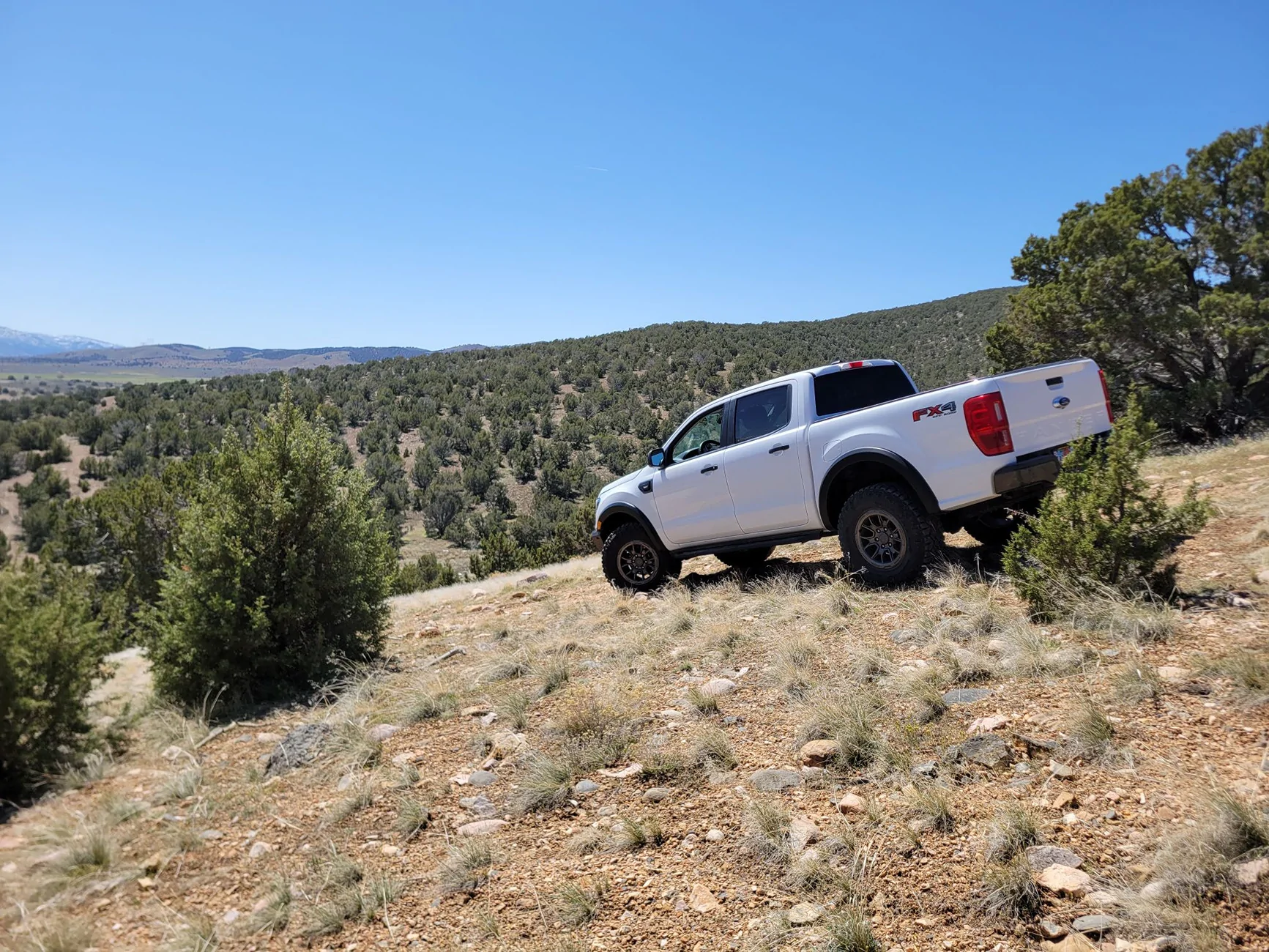

It's been a few thousand miles since getting the salvage Ranger back on the road, and off-road as it were. It's a great vehicle for what I use it for. One thing I've been very impressed with is how well it handles on pavement. It almost matches my Q5 or Touareg for sporty handling. Off-road it also does well although the Eibach Pro Truck 2.0 shocks are pretty harsh over rough terrain. This is with 35 PSI in the AT4W 285/70-17 tires. Recently I put together a mobile air compressor to lower the pressure a little for those longer trips on desert roads and trails.
One thing I really do like about the Eibach front coilovers is the adjustability. Currently running about a 3" level. The BDS 1" lift shackles were removed from the back because they weren't necessary. The "Off Road" version of the FX4 actually has decent lift in the back already. I thought it would need a bit more with the front level but it doesn't unless a monster lift is being installed.

Bottom line, I like the truck. I like the size, the look overall with the Bushwacker slim flares, Roush weels and Rough Country front bumper, the handling and the decent power. Now, since it averages only about 17 MPG, which sucks for a turbo 4-banger, what would be really nice is a small-block V8. Wishful thinking.
