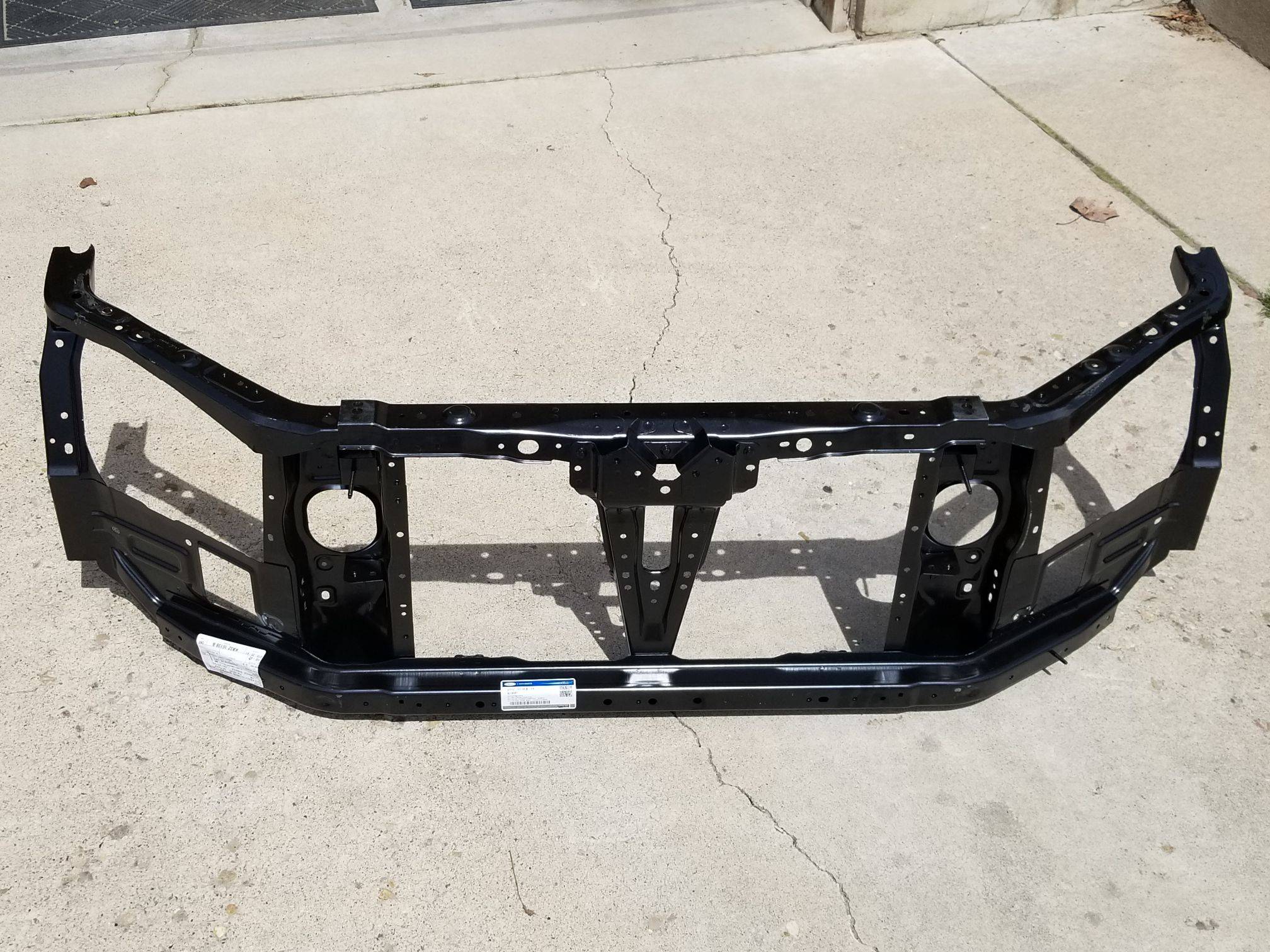

At least I now have the OEM radiator support. The construction appears a little more precise than the CarParts version, although it still has scratches, rubs and other areas of bare metal, not to mention a minor bend here and there. I'll sand it, shoot it with some automotive paint, let it cure for a few days and schedule the truck for the frame shop first of next week. Fingers crossed I'll at least get that far.

Got the radiator support prepped and painted. Looks good.

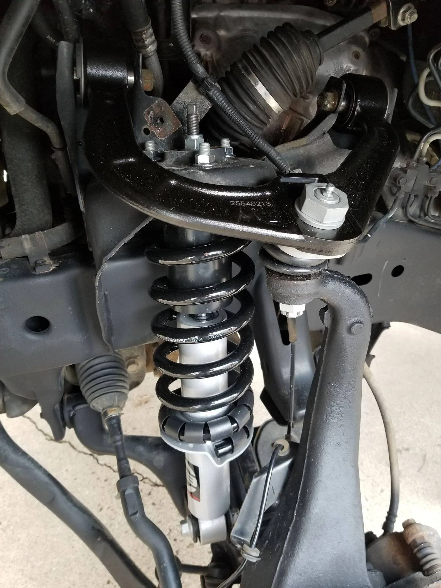

Removed the front forks on my CRF250L to have them rebuilt. Used to do forks but they're a hassle. Have a suspension shop do them now. Ordered a Race Tech spring kit for the damper fork and a Hyper Pro progressive spring for the back. Then there's the Pro Taper bars, new hand guard mounts and so forth.
But the best one is the Nissan Frontier. Holy crap what a pain. Won't get into all of that only to say I installed a 2.5" Rough Country strut lift to get rid of the 2.5" lift spacer and leaky cartridges. Installed adjustable upper control arms to help reduce the negative camber. Had to remove part of the steering just to get one of the bolts out. No issues installing the bolt the other direction (roll eyes). Took an hour to get an ornery steering junction back together. The strut towers will get trimmed for clearance to move the upper ball joint farther in.
But the best part is installing the new camber bolts. Or not installing them, as the case may be. Front bolt on the driver side lower control arm is fused stuck bonded to the sleeve that's bonded to the rubber bushing. Even tried a sledgehammer. Won't budge. The only way to get the bolt out is cut it out, which means cutting up the lower control arm. They're rusty anyway.
Ordered a heavy duty pair from Z1 Off Road and in the description in red letters it states that the 'hardware may be seized and cutting the control arms may be the only way to remove the bolts.' Yep.
And Rough Country put the wrong rear shocks in the "Frontier" box. Bottom mounts are way smaller than the original with about 3 big washer's worth of space between the shock mount and axle mount. Picture on their webpage looks correct with larger mounts than I got. Emails to Rough Country customer service over the past week have gone unanswered. Time to start calling them.
Have used two cans of Rust Reformer on the Frontier so far. One more can should do it. That spindle used to be dark red.

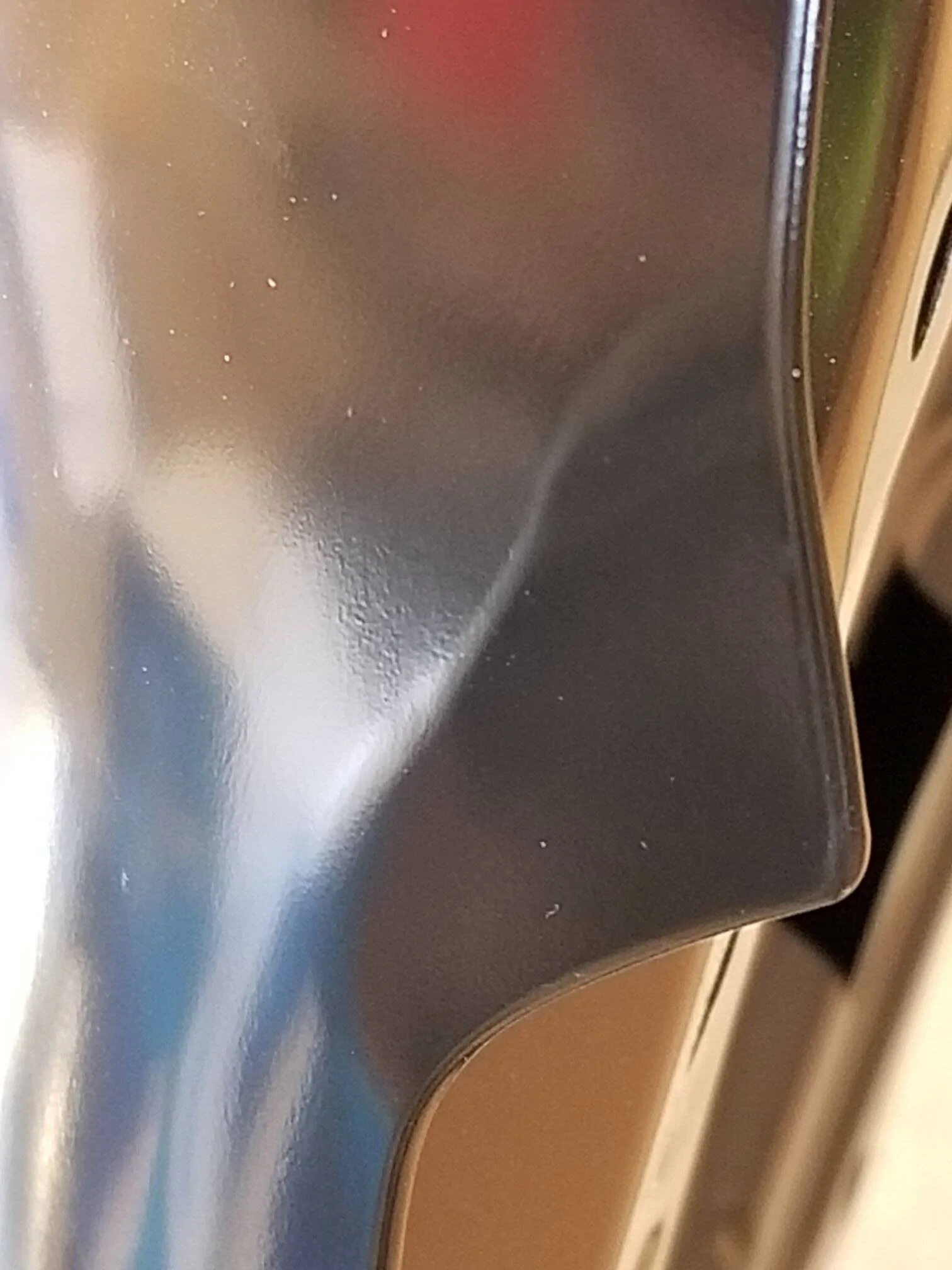

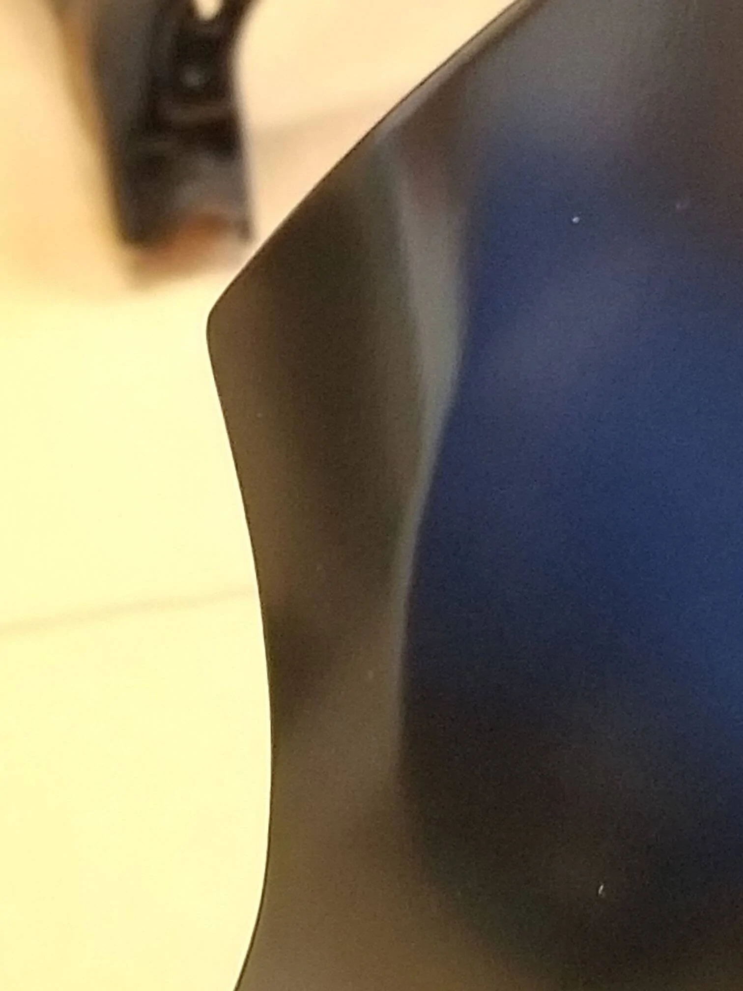

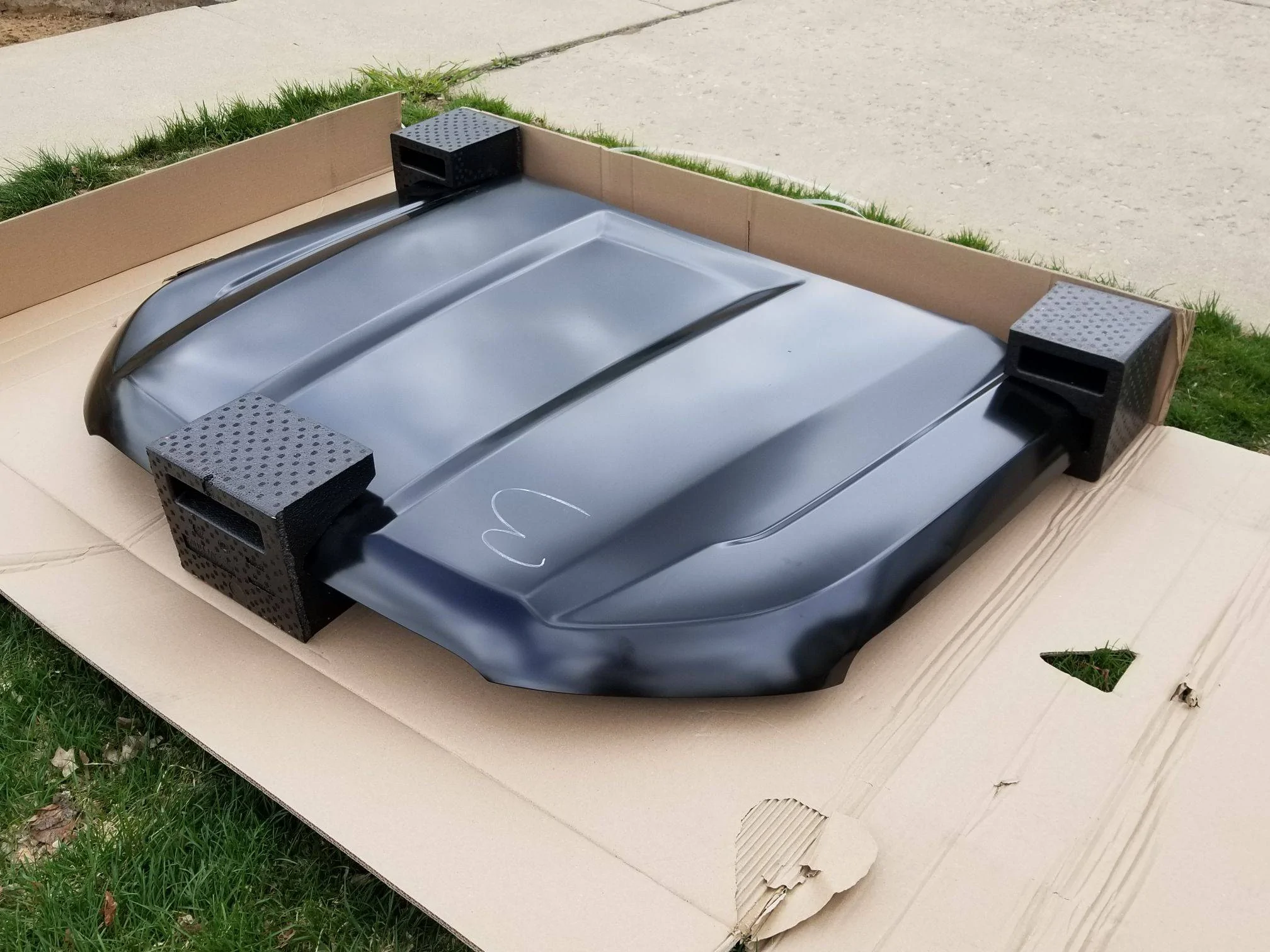

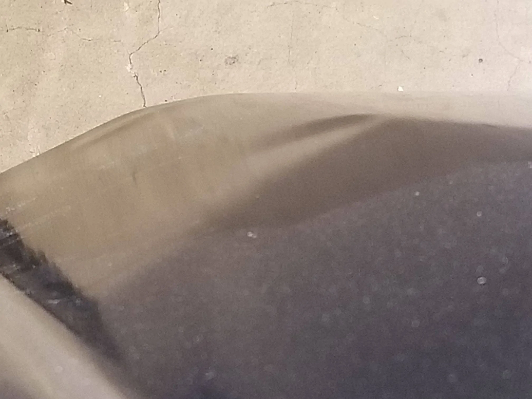

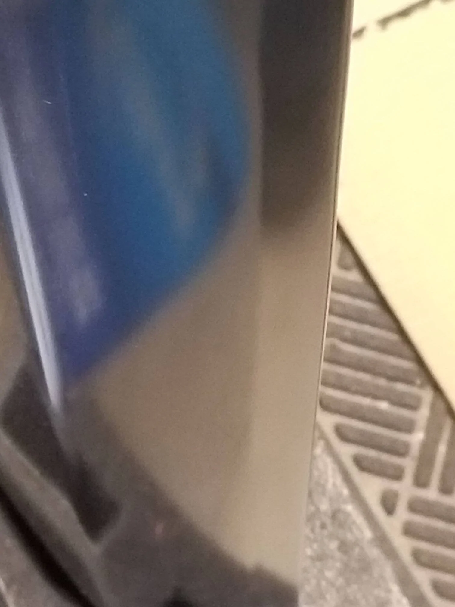

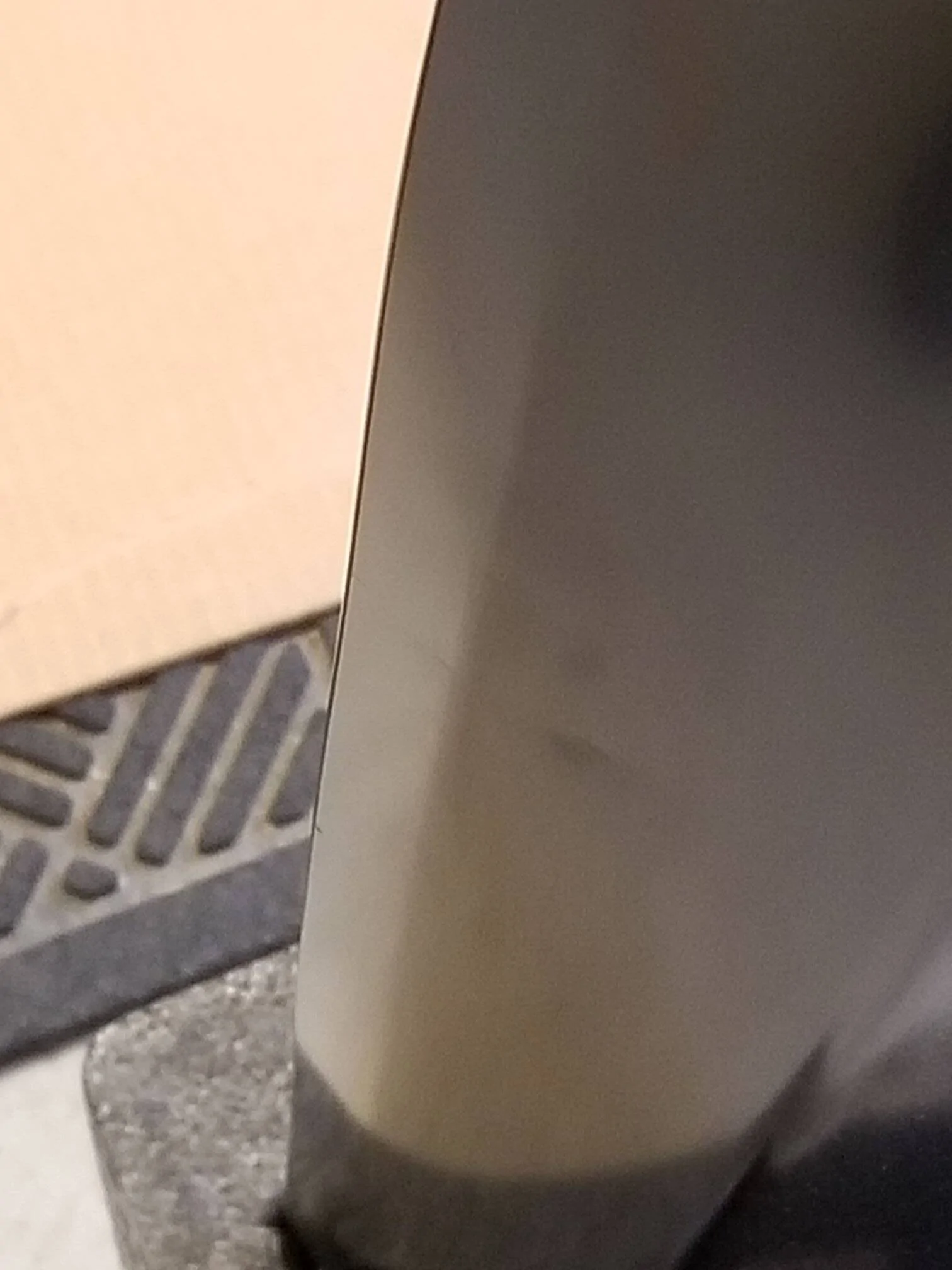

The last two big pieces for the Ranger were the fender and hood. Fender is on its way. Hood arrived Friday. While the driver was pulling the box from the trailer he said, "You'll want to make sure you inspect it because a lot of these hoods show up damaged." Great.
Sure enough, both sides of the hood from about the mid-point forward are bent under slightly where the hood banged against the edge of the box. It's made a crease where they've folded against the edge of the support underneath. There's also a ding on the left side and shallow bowl dent on top near the back right side. Body shop estimates about $450 to get the hood cleaned up. This is an OEM Ford hood.
The driver even commented that he doesn't understand why the people who pack the hoods for shipment don't do a better job. He documented the damage on the receipt and I've sent the information to the shipper.
The problems and hassles just seem to never end with this thing. My wife has told me I should cut my losses and get rid of it. But of course if I do that now it would be a huge financial loss. So I'll soldier on. But this will most definitely be the last time I do an automotive project of this nature.
Saving money is one thing, but there's a point where the frustration isn't worth it. I'm at that point.

A little good news, finally. The Ranger is at the body shop, and the fender showed up today. Amazingly it doesn't appear damaged even though it was in a stupid-big box with no packing inside. It was wrapped in some cute little cardboard clothes held together with string, like the flap on a manila envelope. Otherwise it was free to bounce around inside the giant box. Even the delivery driver thought it was odd to use such a huge box. Guess that's why the shipping was overly pricey at $200.
But hey, it's aluminum, mount is attached at the front and it appears to be damage free. At this point I'll take it.

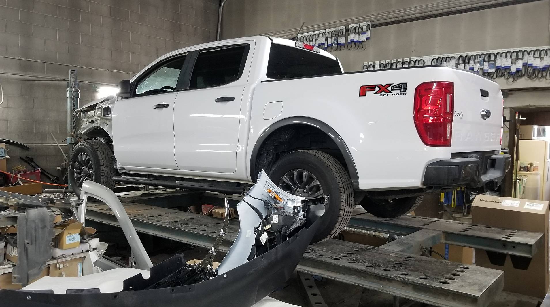

On the rack. Took the hood and upper bumper cover down today. Originally the plan was to have the fender, hood and upper bumper cover painted and I'd install them. But to get the radiator support and other pieces aligned correctly, they need to hang the fenders and install the hood. Since the fenders are glued to the body at the door sill, it makes more sense for the shop to just install them. They also said it's easier to paint the parts on the vehicle.
Originally I was thinking of painting the pocket flares white to match the body color but now I'm thinking of going with the metallic charcoal grey like the original accent color.
