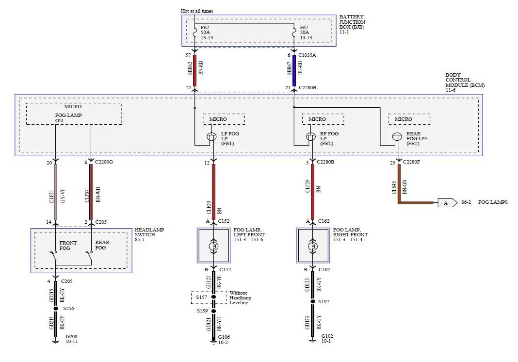

Would you be kind enough to check your wiring diagrams to see if your version is different than mine? Mine shows a brown wire for both left and right positive fog light wires. My wiring has one brown and one yellow/pink for positive. Both black/yellow, black/gray are ground as shown. Obviously one pair is supposed to be left and one right.
Since both black wires are ground, it doesn't really matter which positives are which. But me being me, I'd like to wire them correctly with the left pair on the left side and right pair on the right side. Thanks.
The 2019 wiring diagram shows:
Left + BRN
Left gnd BK-YE
Right + YE-OG
Right gnd BK-GY
LF - Fog
Pwr = Brown
Grd = Black / Yellow
RF - Fog
Pwr = Yellow / Orange
Grd = Black / Grey
Left + BRN
Left gnd BK-YE
Right + YE-OG
Right gnd BK-GY
Perfect. Thank you, guys.
But where did you get the correct wiring diagram? My manual is supposedly a Ford manual but you can clearly see in the wiring diagram I posted that it shows both left and right positive wires to be brown, which is obviously only half right.
I have the 2019 Ranger shop manual with wiring diagrams on a CD from Helm as well as the printed wiring diagram from Helm.

Wonder if your manual is for Euro spec Rangers? As it is showing connections for a rear fog light. Not something we have in NA.

That is the difference (ROW) Ranger diagram, as that is something highly useful for our ROW Ranger members as the wiring and pinouts are different, same basic operation just different colors and connector pinouts (mostly)

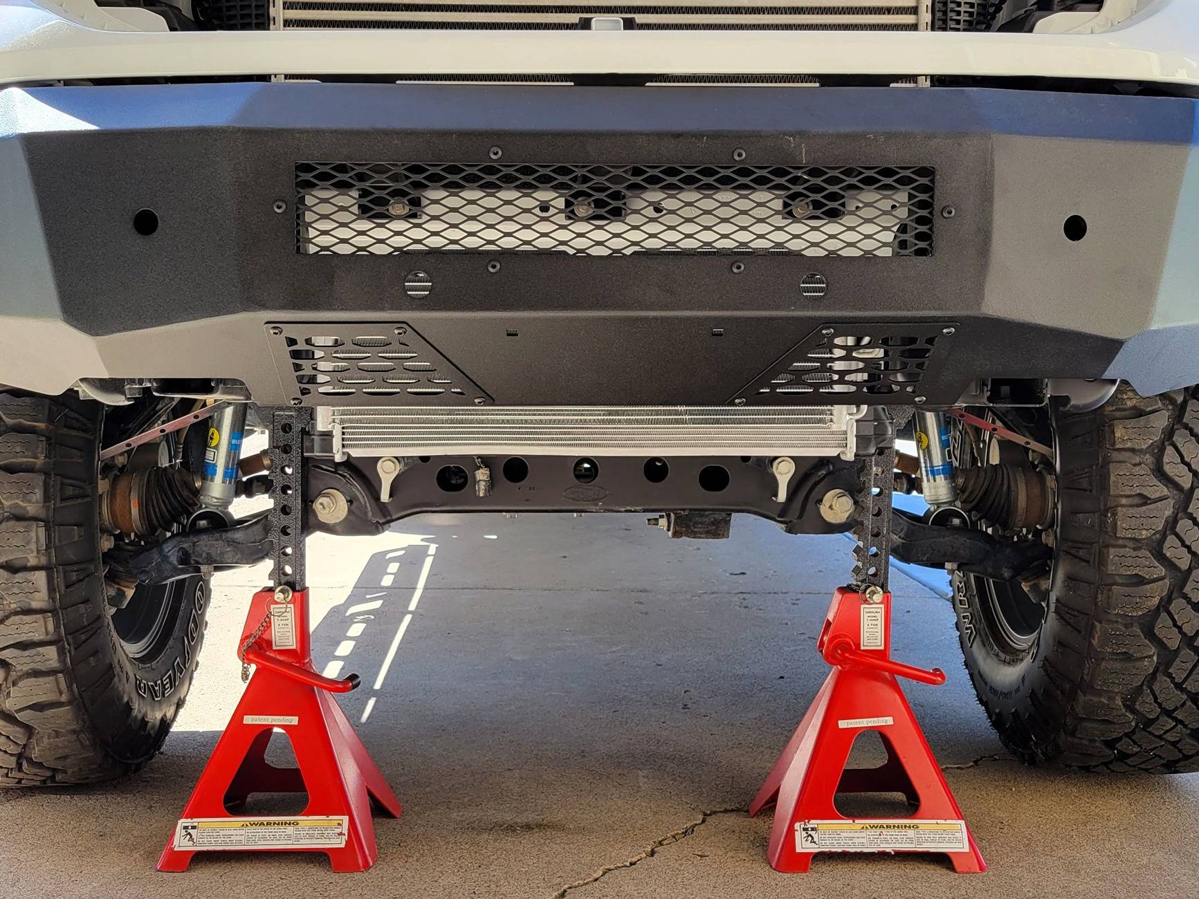

Got both of the 5100's and upper control arms installed. Not all warm and fuzzy about them though. Height clip is in #5, or the top groove for 2.5" lift. With the jack stands under the frame rails, and a bottle jack next to the lower ball joint, so it's only an inch or so from the face of the rotor, the frame lifts off the jack stands with less than a quarter inch of lift at the jack.
This is NOT good. What it means is the shocks will be riding very close to the top end of shock travel under load. That means on the road any time the suspension is unloaded, even slightly, the shocks are going to hit the top of their travel.
You want at least a few inches of sag so the shocks will have enough travel in normal driving conditions as to not hit their end limits. I can see this setup hitting the top travel limit constantly.
The new 5100's are basically the same length as the OEM Fox shocks. So creating lift by moving the bottom spring mount higher just pushes the piston farther up the cartridge substantially reducing unload travel.
I just assumed that a company like Bilstein would have accounted for this. Apparently not. In order to lift the front end and keep enough travel both directions as to not hit the end limits, you need to move the center range of piston travel a length equal to the amount of lift in order to maintain full, equal piston travel. So if you don't have physically longer shocks, then a spacer is the only proper option to lift the front end and maintain proper shock travel.
I bought these from Stage-3 and will contact them to see what they say. But the only logical solution at this point to use them and still lift the front end is to move the lower spring seat clip down to the #1 groove, which is 0.0" lift, and install a spacer.
Removing the shocks, compressing the springs, changing configurations and reinstalling them is not a simple or easy job. I fought with the individual spring compressors because I figured this was a one time job. Just another smack in the face for the Salvage Ranger rebuild. I'm going to blow another $200 and get a professional spring compressor stand this time. After all, it's only money, blood, labor and time.

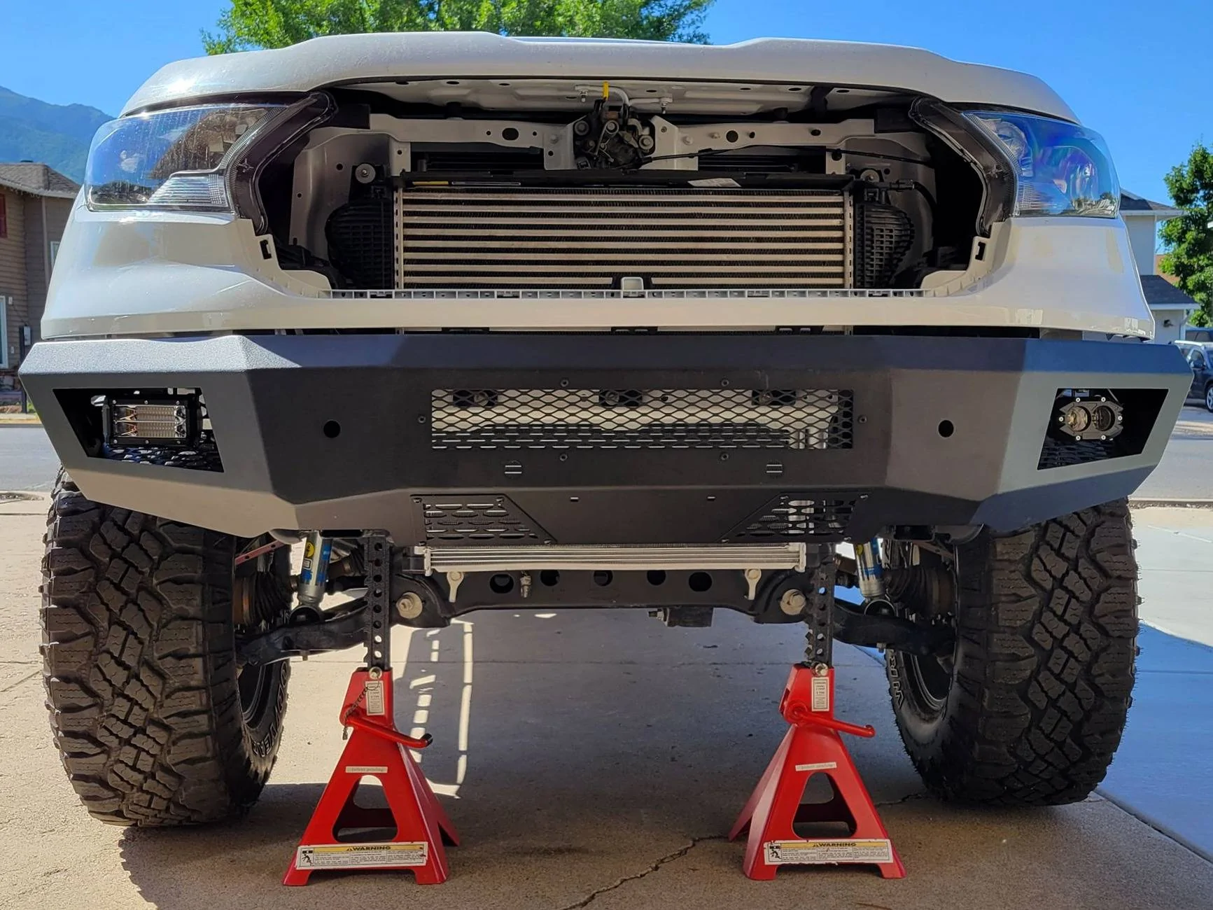

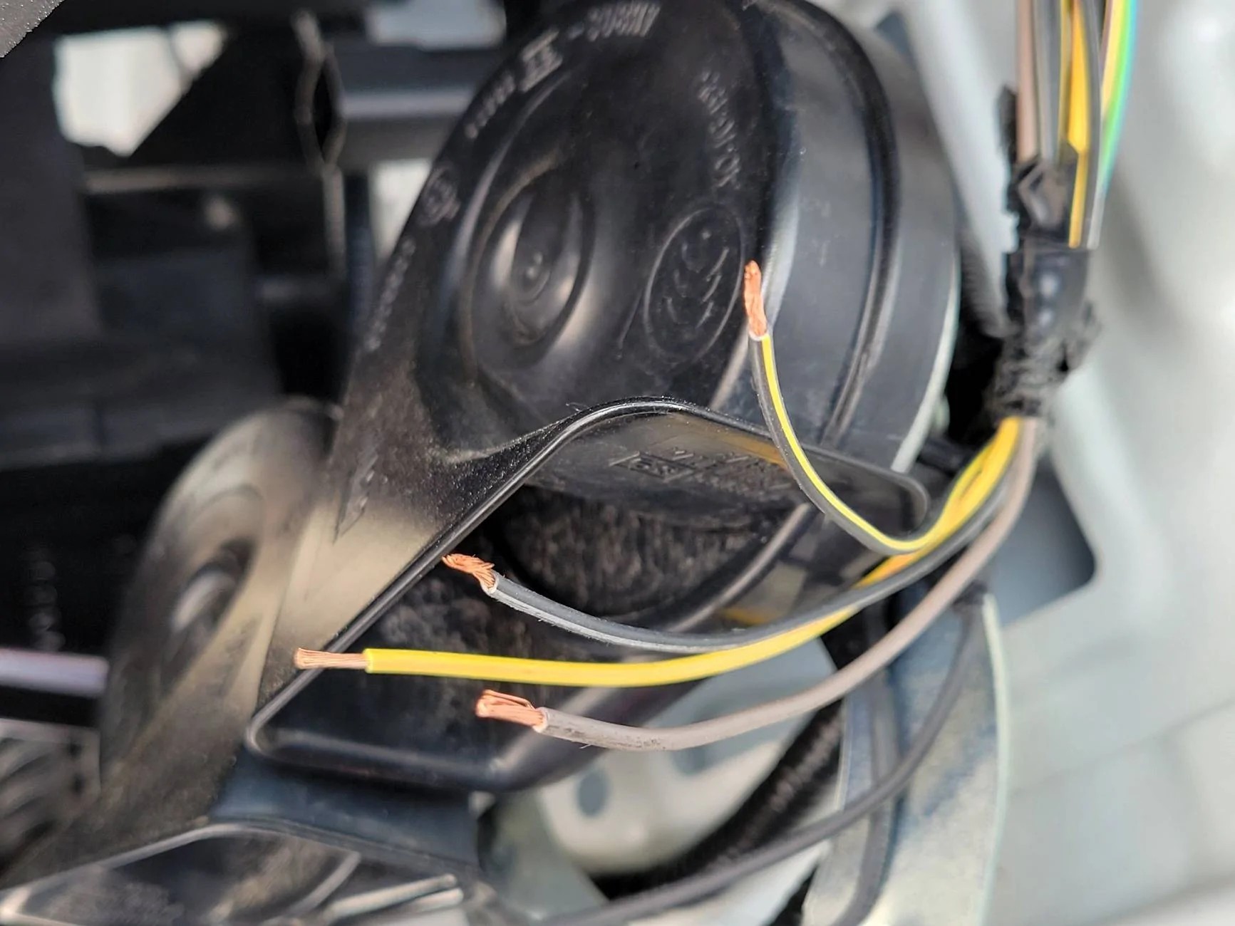

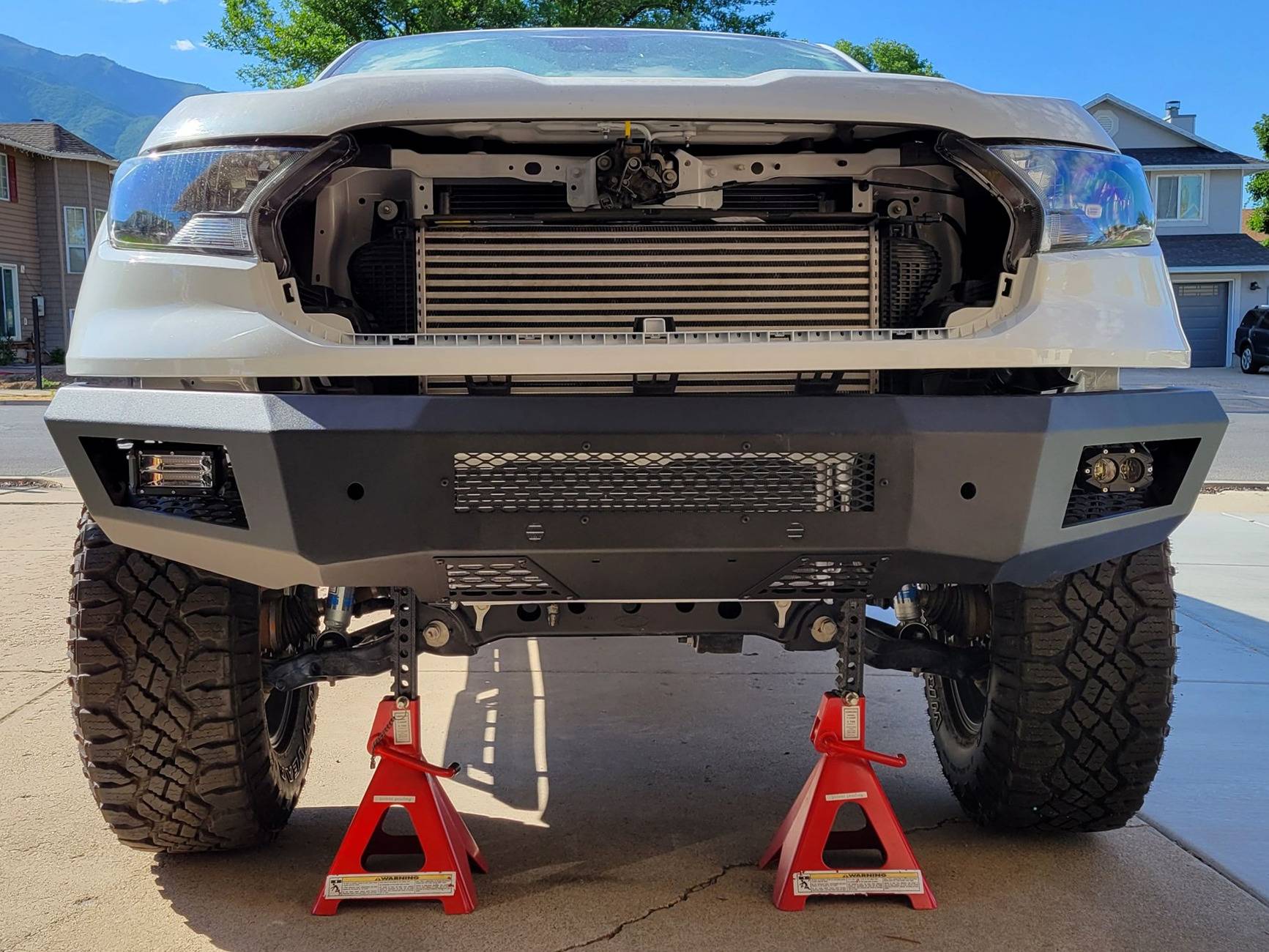

Got the wiring and connectors sorted for each fog light then hung the bumper. As soon as I backed up a little it was obvious that the new frame rail on the driver side is lower than the passenger side by close to a half inch. More incompetent work by the body shop. The problem is pretty obvious in the close up picture.
To keep the pretty new red tow hooks aligned with the bumper, as well as the skid plate, I'd have to put a spacer in the hook mount on the passenger side. Just seriously pi$$es me off the unbelievably unprofessional work that I ended up paying $5,500 for. That was labor and paint only. I had supplied all the replacement parts.
Going to talk to another body shop that I know is professional and see if they think the driver side rail at the front can be tweaked up slightly. Might need to split the difference and tweak the driver side up a quarter inch and the passenger side down a quarter to level them. I'd rather do that than put a spacer in the hook. But we'll see what they say.
Cut, painted and fit expanded steel screen in the bumper center opening. The new lower OEM air deflector is obviously intended for use with the stock bumper so I'll have to modify that to work with the Rough Country bumper. Mainly the front of the stock air deflector ends up above the bottom of the center opening in the bumper. The bumper also has two vent openings near the bottom which would otherwise be completely below the air deflector. Minor stuff to figure out after the bigger stuff is sorted.
The driving light on the driver side is the original set I've had for a while and was mocked up to see if I wanted to use them. The one on the passenger side has a flood pattern, so not a true fog light. Still looking at options here but am leaning toward finding some true fog lights with a vertical cutoff so they can be used on the roadway when desired without blinding other drivers. Fog light options for an F150 look really good but I'd have to make custom mounts to use those. Doable but meh.
I don't drive off-road at night on purpose so I have no desire to light up the dark side of the moon with a bunch of LED lights on this Ranger. The LED Sealight bulbs I got for the main headlights should light up everything sufficiently. Proper fogs are just nice for lighting up the near sides of the road sometimes.

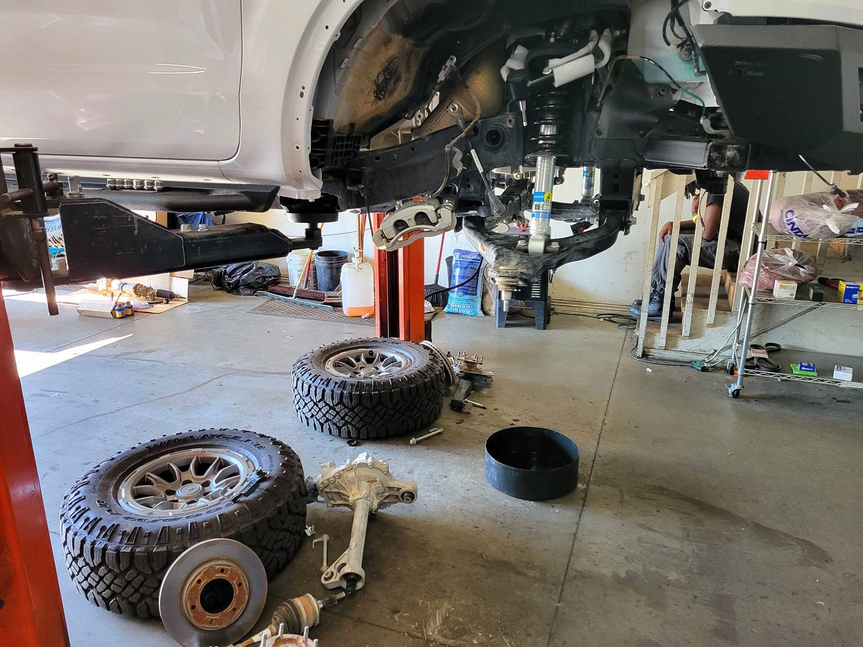

Here's a shot of the Ranger I took today with the front diff out. Just got a call that it should be done tonight.
They won't be installing the new shocks or charging the AC though. I was quoted $540 to charge the AC because the R-1234YF refrigerant 'is so expensive.' Did some research and while it is expensive, couldn't see $540 worth for this job. Specs show the system takes 1.49 lbs. of refrigerant. That's just shy of 24 oz. Found a refrigerant distribution company that sells a pack of four 8 oz. cans of genuine Honeywell-branded R-1234YF refrigerant for $105 plus tax free shipping. Also just ordered an R-1234YF compatible recharge kit with gauges, connectors and vacuum pump for about $140 with tax and shipping.
I had been contemplating getting a gauge kit and vacuum pump for years but never really needed one before now. Pretty much all my AC work on anything to this point has just been to top-off a low system.
For anyone who might not know but care, genuine R-1234YF cans have a left-hand thread to distinguish them from R-134A cans with a right-hand thread. Apparently there are people out there selling R-134A cans with stuck-on labels stating that it's R-1234YF, which it isn't. So there you go.
Even though the shock is totally exposed and would literally take 10 minutes each side to replace as it would be a piece of cake with the spindle out, the mechanic quoted an hour labor. I told the owner that it would take maybe a half hour if they were slow, but the owner said they had to treat it as a separate job with a 1-hour minimum at $150 an hour regardless how much less than that it might take.
This is the best rated shop in the area and I trust the mechanic's work but I just couldn't justify spending another $150 for something I could do reasonably for free. That and I need to do more work on the suspension anyway. At least installing them myself I can make sure the top-hat bolts get thread-lock.
