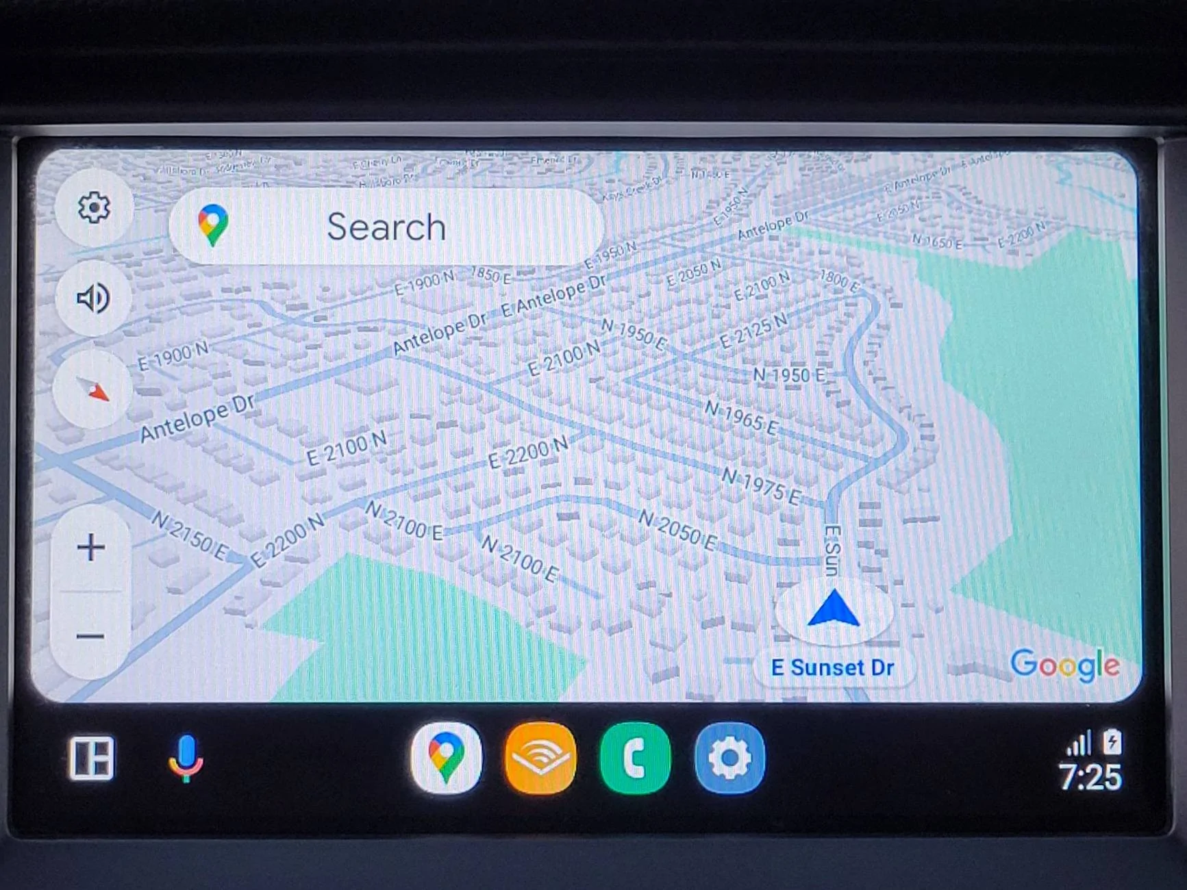

You guys aren't going to believe this.
First though, the new body shop got the frame rail angle corrected. There went another $547. When first looking at it, they mentioned that the rubber cushion between the frame and body mount looked stretched. After they adjusted the rail to its correct position, they said the cushion settled correctly on the mount. Nothing else moved and everything else looks good.
The guy also said he thought I did a great job selecting the shocks, flares, tires and wheels and so forth. He was especially interested in the shocks since the Eibachs are twist-collar adjustable. He also said he might want to purchase the other flares I have that are like the ones on the Ranger now but smooth and can be painted.
Second, I got Android Auto to work. Believe it or not it was the cable. Was it a charge-only cable? No, it isn't. I probably have 8 or so USB-C cables for various applications - drones, tablets, cameras, phones... They all transfer data fine. I immediately took the suspect cable into the house, plugged it into my desktop with my phone and it's connected and transferring data fine. Why it wasn't working in the Ranger is a total mystery.
Bottom line, no need for an upgrade. I'm good, for now.

For me it adds navigation, which my Ranger does not have. I've found navigation very useful in my other vehicles.
Many carmakers no longer include maps and navigation in their vehicles unless it's a requested option because Apple CarPlay and Android Auto are popular and include navigation along with other features mentioned. Waze, for example, is quite useful and popular.

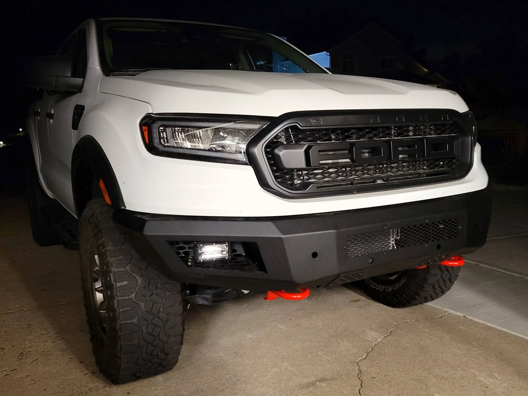

One more small step. Got the bumper adjusted decently and the fancy red tow loops mounted.
Next will be to try and see if the OEM lower air deflector can be mangled to work with the Rough Country bumper. The bottom front of the opening aligns at about the middle of the grill I made in the bumper. Might be able to make it work. Might not. We'll see.
Skid plate after that.
The driver side suspension is about 3/8" lower than the passenger side. I read somewhere that the Ranger has a slight tilt to one side. Is that what it's about? I'll crank the driver side Eibach collar back up two turns, which should level it out. Even the guys at the new body shop noticed the slight tilt.

Side to Side (Variation) Specs are 8mm or 5/16. (Both Ft & Rear), so at 3/8 you are just a smidge over specs by about 1 mm.
The tilt is due to the weight of the gas tank which is about 124 lbs fuel weight. (Full)

What are the holes in the bumper for?
In that case you would think the sag would be on the passenger side. My measurement is with a quarter tank of fuel and no driver. So with an additional approximate 90 lbs of fuel, there will be additional sag. Then add a 200 lb driver to the same side (obviously a passenger would help balance that but I drive alone 90% of the time).
I usually keep my vehicles at least half and usually closer to full so definitely need to level up the driver side. Fuel will be run down close to empty because it's at least 1 1/2 years old.

My Eibach have me at 3/8 low on the drivers side. Your rear height might be different as well. I put tremor springs in mine and I am low in the back drivers side as well.
