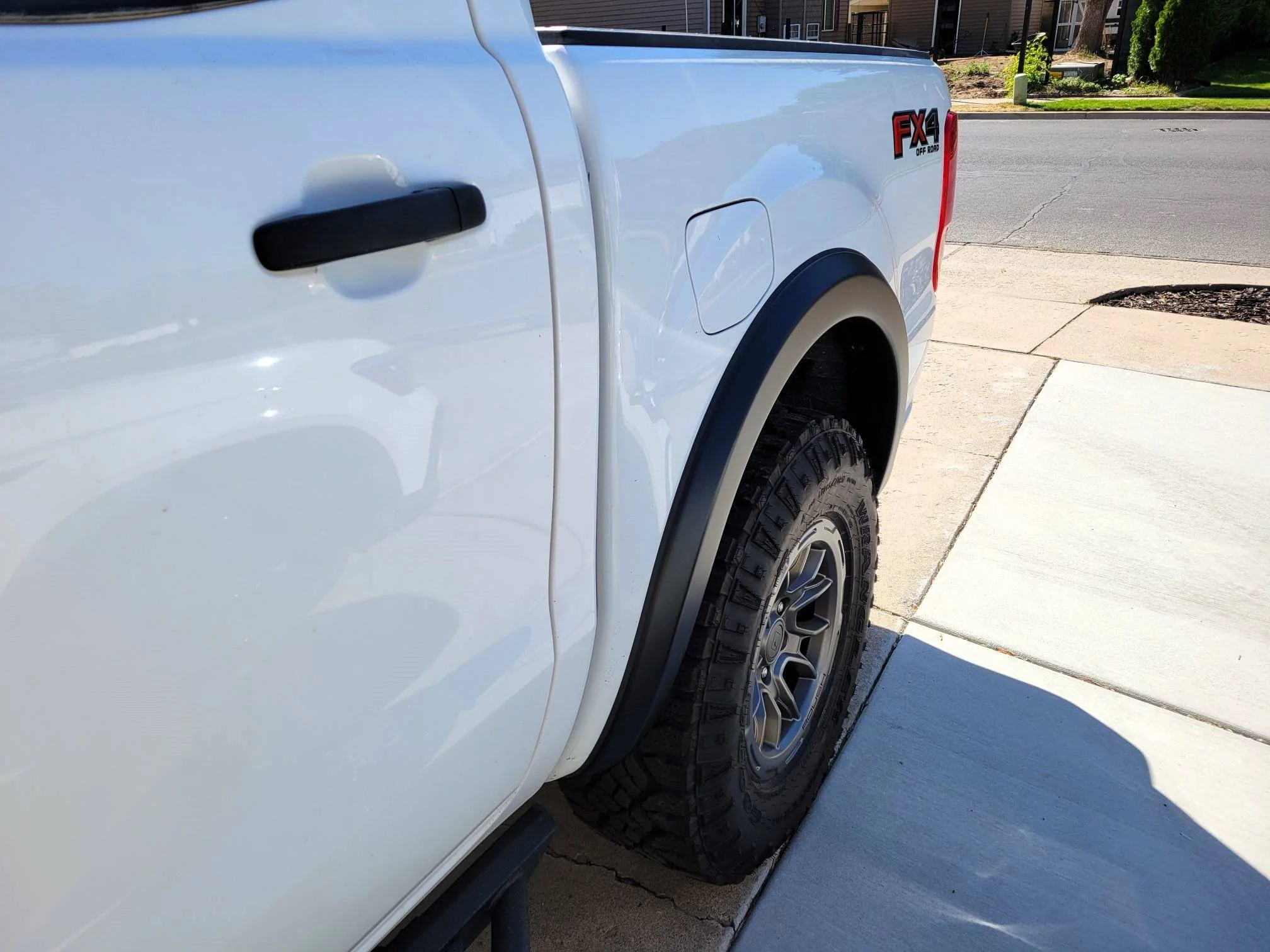

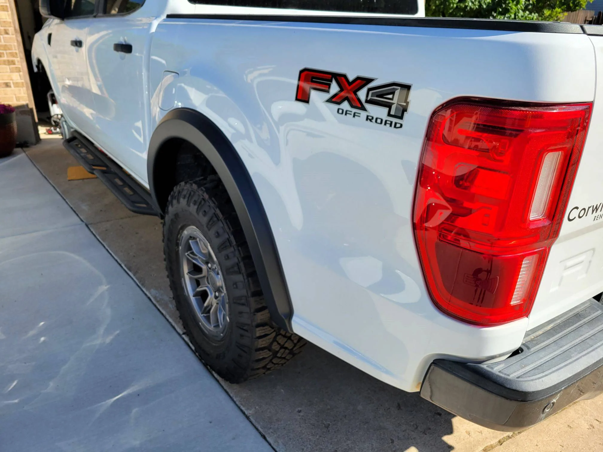

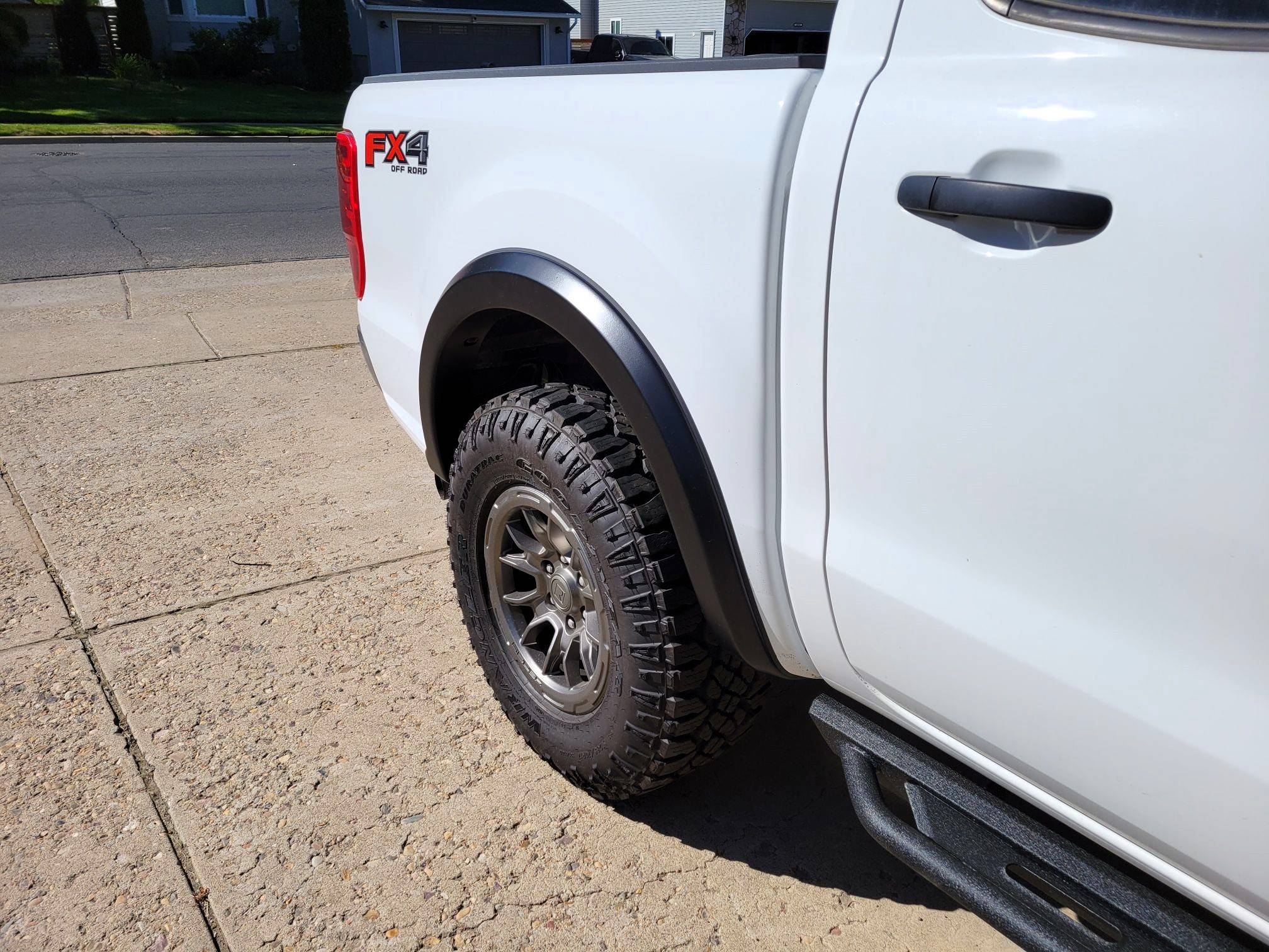

Sealed the fender insulators with black polyurethane foam first thing this morning before it got stupid hot. It was about 85° in my garage by 9am.
Installed the rear Bushwackers while waiting for the new OBDII/FORscan cable to arrive. The slightly textured black isn't as classy as the dark metallic grey, but they fit well and will do their job deflecting debris. I went back and forth between getting smooth ones and painting them either white or the same dark metallic gray as the OEM trim, but in the end settled for what was simplest. There's enough open space where flat mud guards can be attached and maybe only need to drill one hole into the fender near the inside.

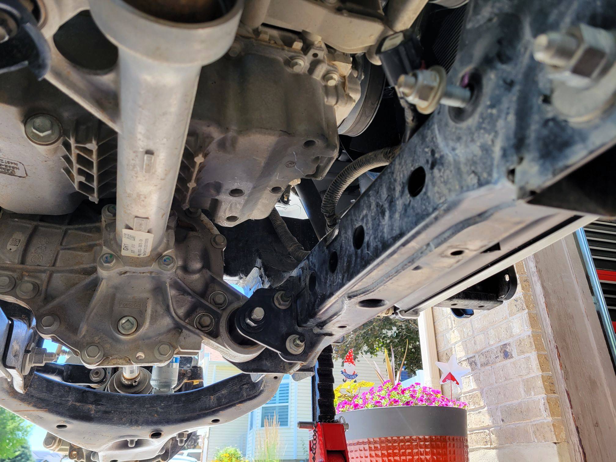

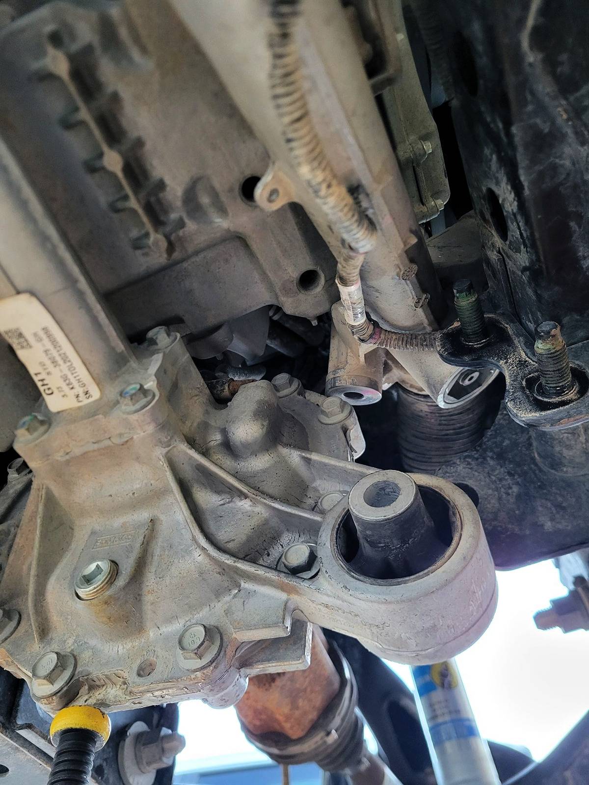

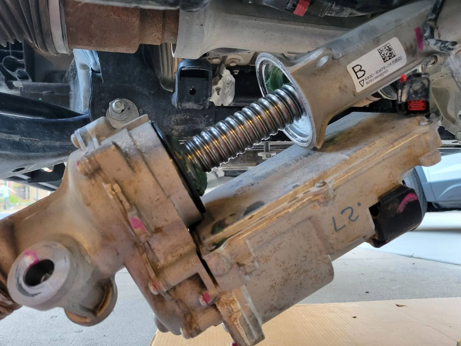

Welcome to my nightmare. Well, another one.
Steering rack won't clear the front differential. If it was 2WD it would be no problem. Lowered the diff against the frame and it still won't clear as part of the rack hits the oil pan as well. Tomorrow I'll loosen the driver side motor mount, lift the engine slightly, and also remove a retaining bolt that holds the back of the diff and see if I can tilt it more and between the two get enough clearance to wedge it out.
The split is where the case broke in the wreck, obviously.
Never, ever, ever, ever again.

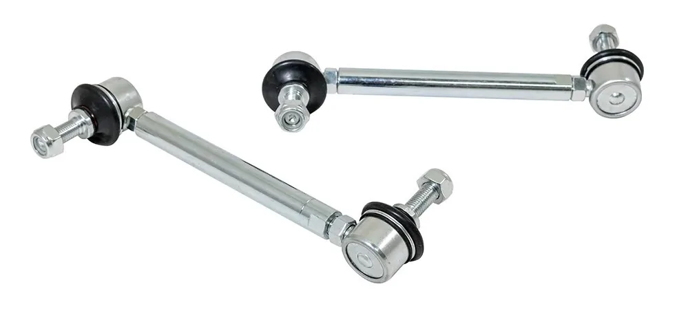

The stock swaybar end link length is 12", or about 305mm. From what I can see, the bushings in the swaybar mounts are fixed so they can't be rotated. That means the links need to be about 1.5" shorter for a 2.5" lift in order to rest at a neutral position. A 10.5" link is about 265mm. That length is a best guess at this point but I'll get some adjustable links in that range.
The stock link stud is 12mm. Many of the adjustable links have 10mm studs with a sleave adapter for 12mm. I'll try to find a good set with 12mm studs.
If you loosen the bushings on the sway bar they can be rotated to the appropriate angle. It's just a round bar clamped by those rubber bushings, so it can be moved. It's just unable to be moved while clamped to the truck since the mounting bolts preload the rubber.
Be very careful when changing the sway bar link lengths from stock. Even in the stock configuration at full flex there isn't much clearance between the sway bar and the LCA. If you extend this length there may be interference that won't be readily obvious unless the front end is flexed out.
I've changed the ride height on a few vehicles and am familiar with needing to sometimes change the links to keep the sway bar position in check. I was thinking of loosening the clamps but decided I didn't like how close the sway bar was to the lower control arm, which is why I'm installing shorter links. Stock links are 12" and with the new ride height the neutral point of the sway bar as is should be around 10.5" to 10.75". The shorter links will move the bottom mount farther away from the lower control arm.
Ordered these from ZZPerformance for $100. 12mm studs with minimum length of 265mm (10.43") and max length of 325mm (12.8").
Per the manual - The Front Axle has to be removed to replace the Steering Gear, but there are always shortcuts around that (hopefully the plan) you have with the motor mount will provide enough clearance.

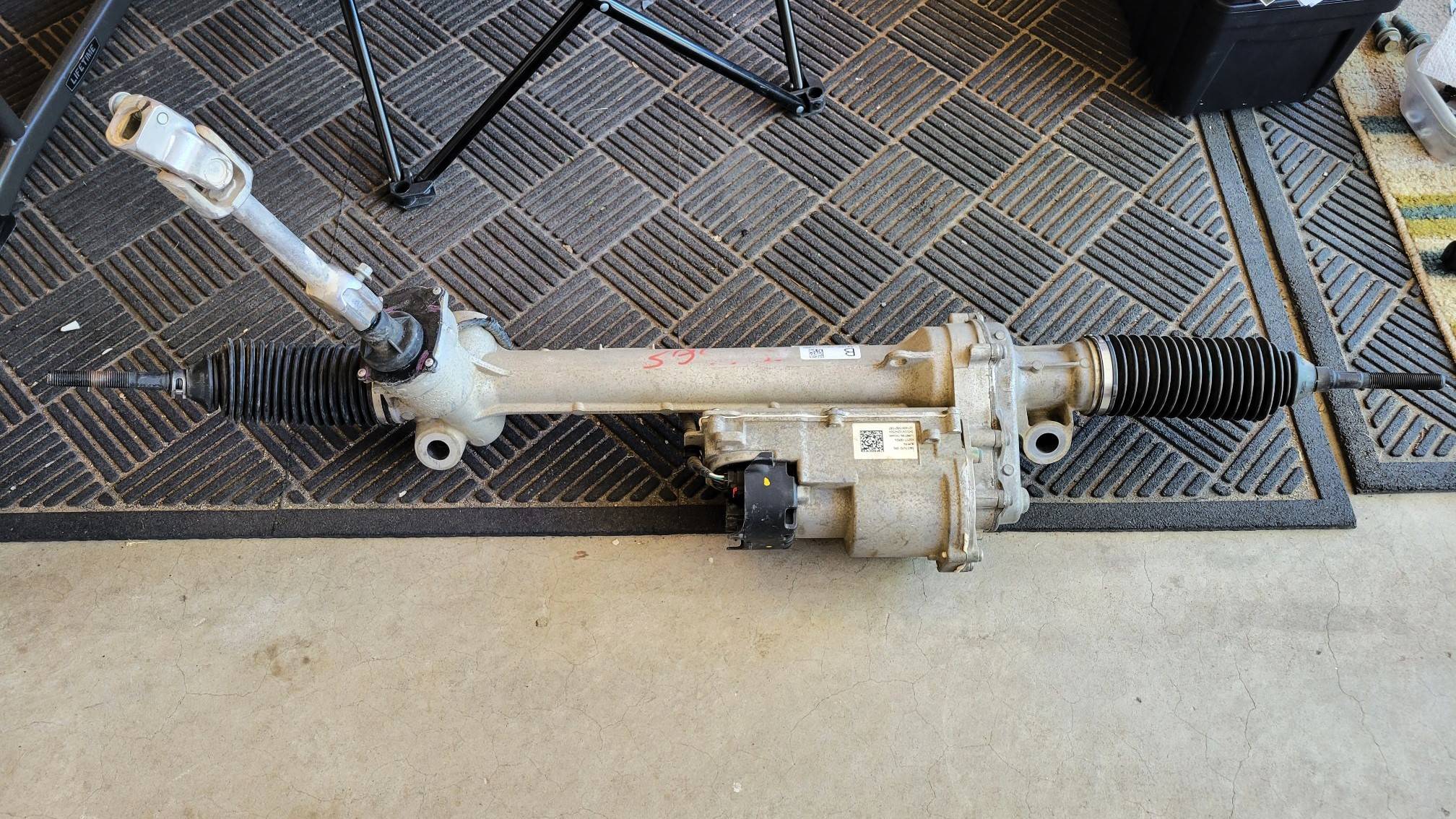

Finally hit a wall. There's no way to install the steering rack on the 4WD model without removing the front diff. I tried for about 2 hours doing everything I could think of, including raising the driver side of the motor as far as I felt comfortable to try and clear the oil pan, about 2", but it just wasn't going to happen.
I was able to get the other one out because the side with the motor and module was hanging free downward so I could rotate the other end to clear the diff. With the case intact, there's no way to finagle it around to clear both the pan/diff and frame/axle housing at the same time. It would be a piece of pie on a 2WD model. It also would have been possible if the crossmember had been bolted instead of welded and could be removed. Welded is better for strength though so...
Just got back from talking to a local family-owned repair shop with excellent reviews that's been around for quite awhile. Told the owner my story and what I needed done. He said it shouldn't be a problem for his techs to remove the diff, bolt on the new/used steering rack and reinstall everything.
Won't be cheap though, which I already knew. The job will involve removing the axles, disconnecting the front driveline and then lowering the diff and axle housing. Estimate is $1,400. Given that all the lower components are already removed and I'll be paying cash, the cost should hopefully be a little less. But at this point, who's counting.
Of course with no steering rack installed, there's no steering. I used some thin angle steel and secured the tie rod mounts to the frame so the wheels are mostly straight. Wheel dollies will have to be used to move the front end around when necessary.
Appointment is for July 9th. That gives me two weeks to sell a kidney. Sigh...
Yeah I'm afraid there are no cheats on this one. I definitely gave it a solid go.

Just curious if it is possible that at the mount point , can the case be split (separated) from the left half.
If the right inner tie rod is disconnected it appears that you could possibly separate the halves and slide the case off of the worm gear (rod)
