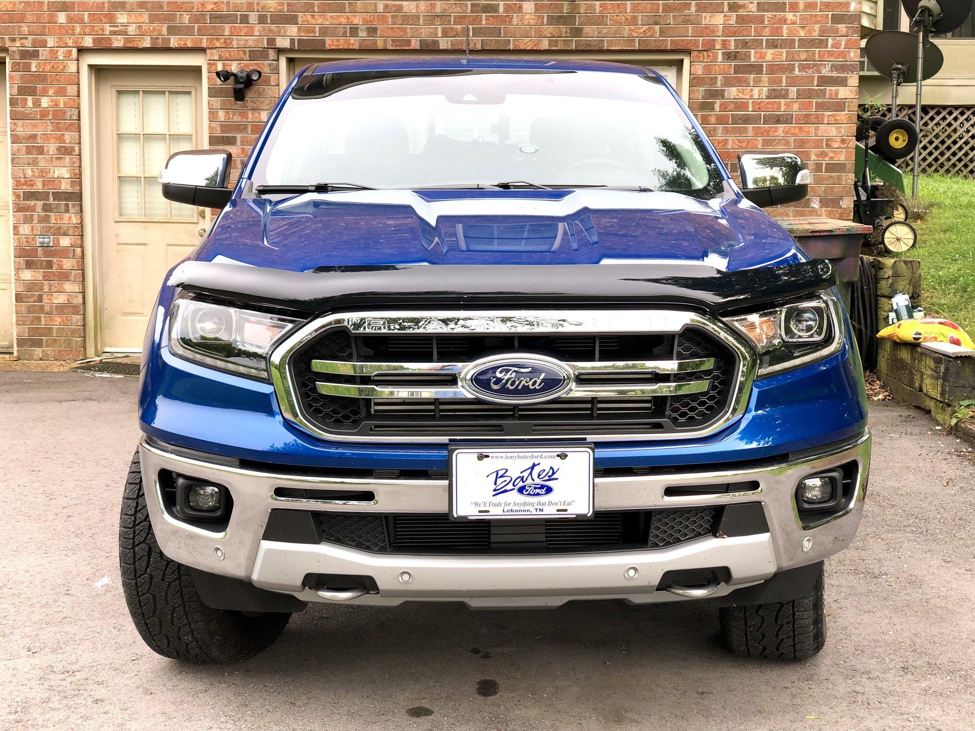

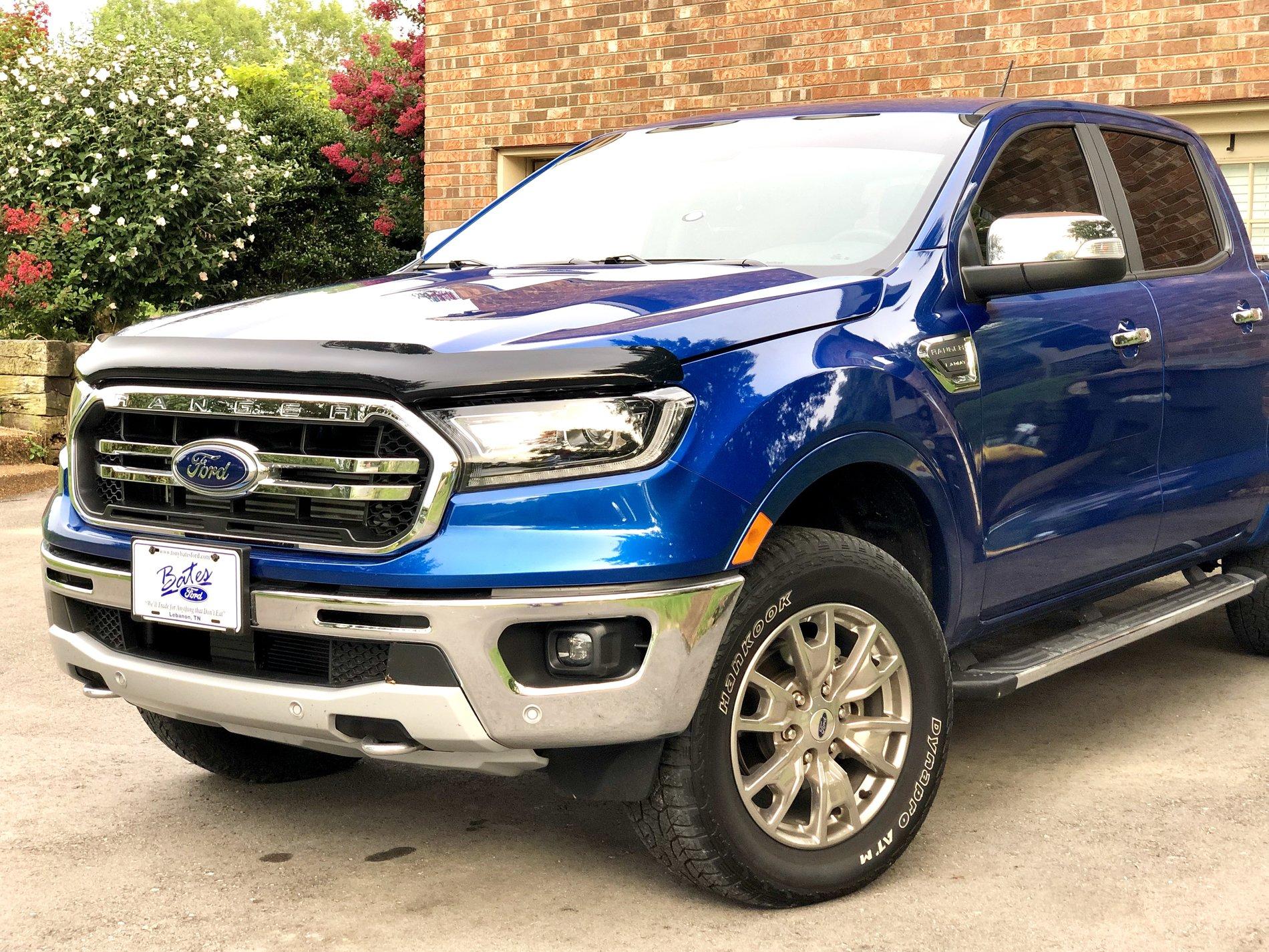

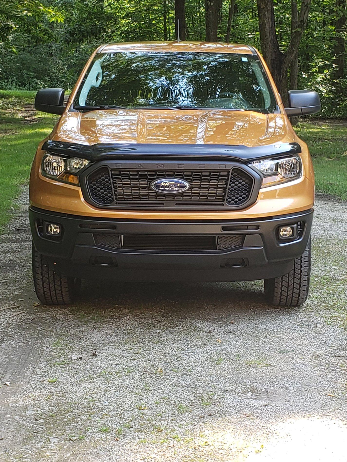

I added the AVS Bugdeflector II to my Lariat today. I used the AVS pins and they seem to hold tight. I do like the lip and the overall contours.

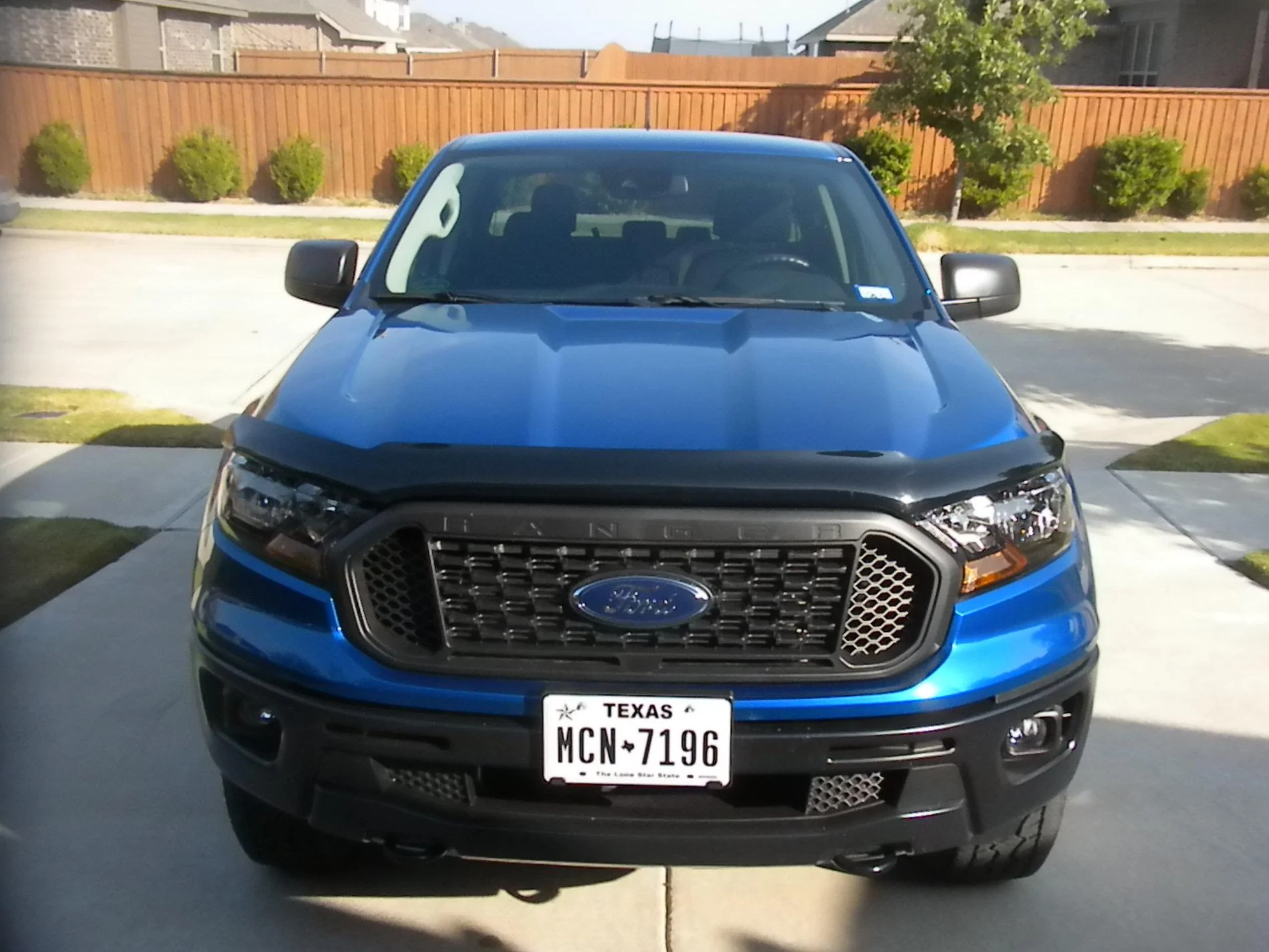

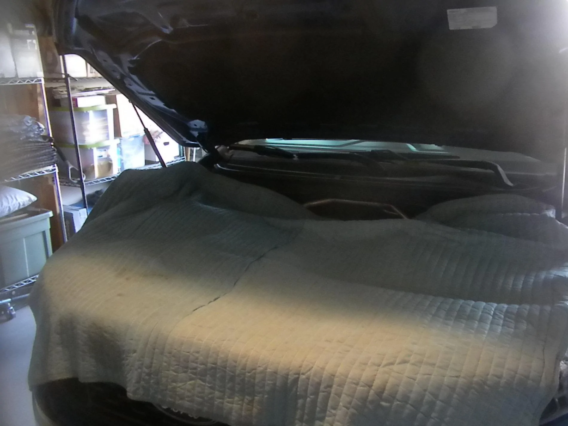

Ordered my AVS bug shield Tue 23rd estimated delivery 7-30/ 8-2. Received it yesterday. Did the install this morning time to install less than 1hr. This is my procedure.
1 deburred holes in bug shield
2 cleaned leading edge of hood
3 placed a moving blanket over engine bay, if you drop a pin it may be hard to locate if ever located, they only supply 8 that are needed
4 test fit bug shield and mark hood with chalk to locate pins that need to be removed
5 remove pins
6 reinstall bug shield under rubber and locate holes rubber will hold it in place
7 insert new pins be sure pin is fully inserted before setting the screw
8 clean chalk off hood

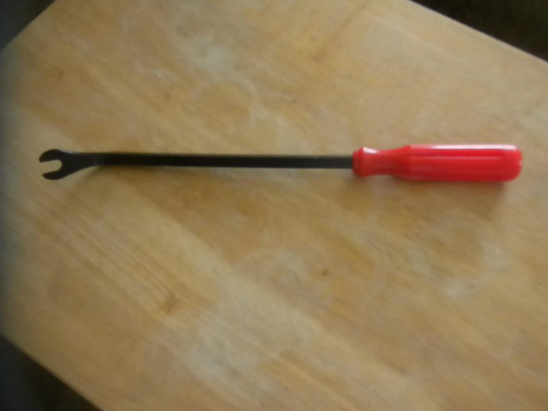

As far as I am concerned the pin tool remover is a must have
That's my story and I'm sticking to it

Where did you get the tool??

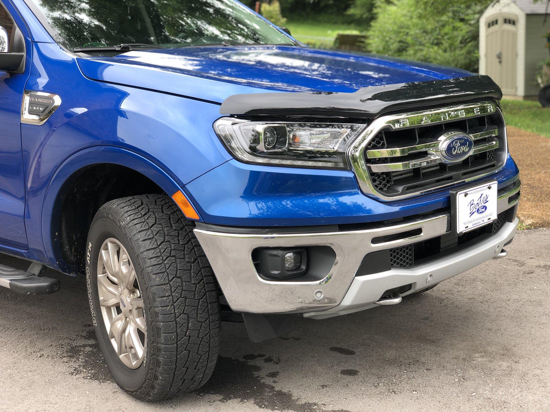

I purchased and installed the Ford deflector. Took a little over an hour. Have to admit, I was nervous putting those clamps/brackets on the hood lip. I was afraid I’d scratch the hood. Ended up looking really nice.

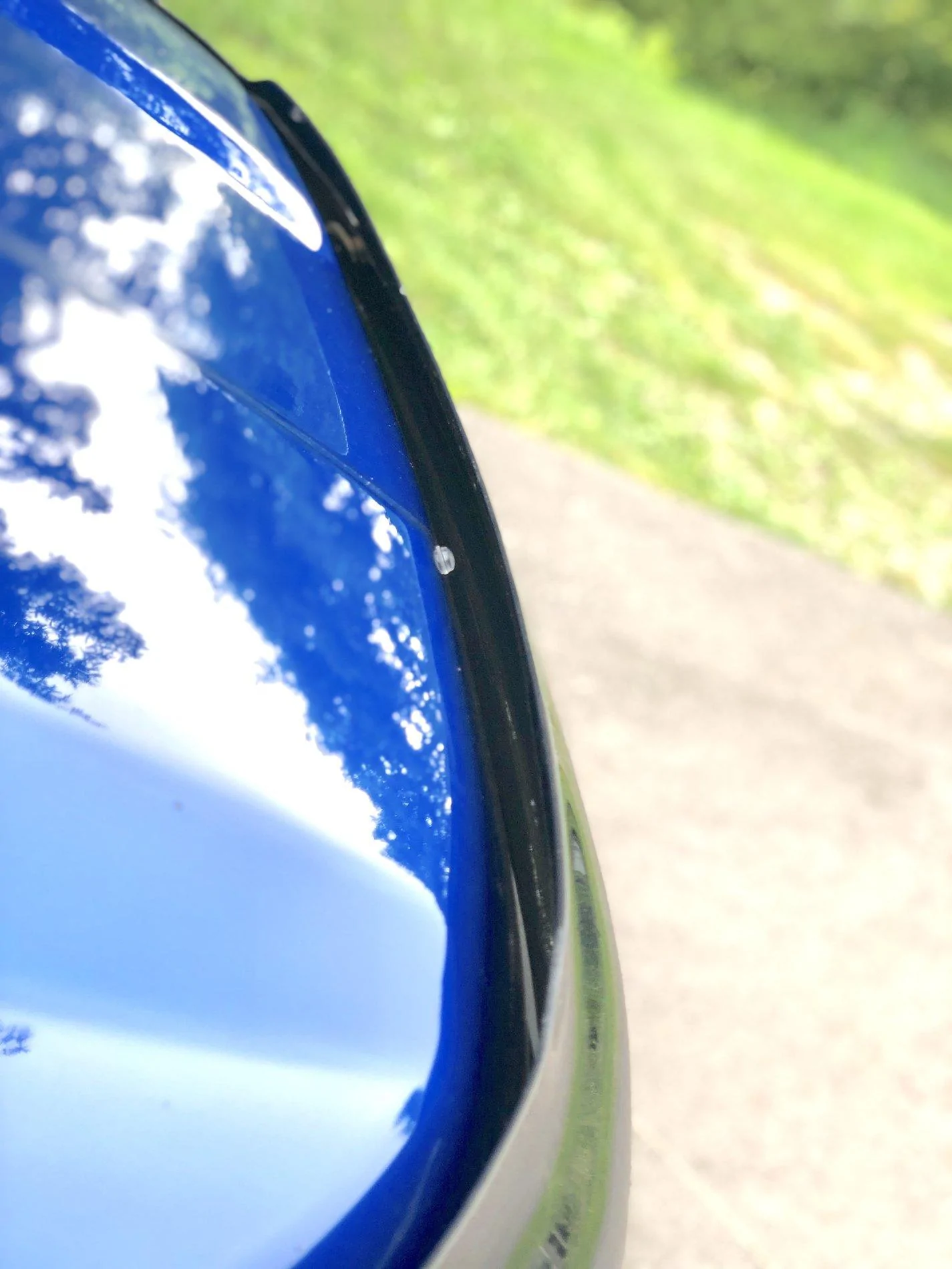

Installed the AVS Bugshield II today. Took all of
15 minutes using supplied fasteners. Key was a removal tool. Pops the OEM right out.
Tod. Looks good. It looks like yours from what I can see has an AVS sticker on it like others I have seen. Mine did not have a sticker but it has the AVS engraved. Yes the tool is a must.

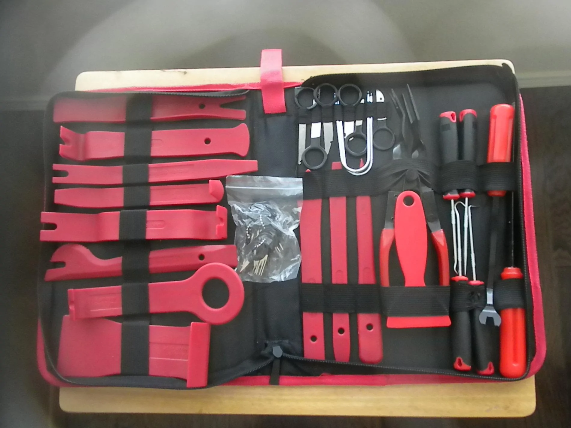

I got the tool at the local autozone for like 9 bucks. Called a door panel remover. Green handle.
