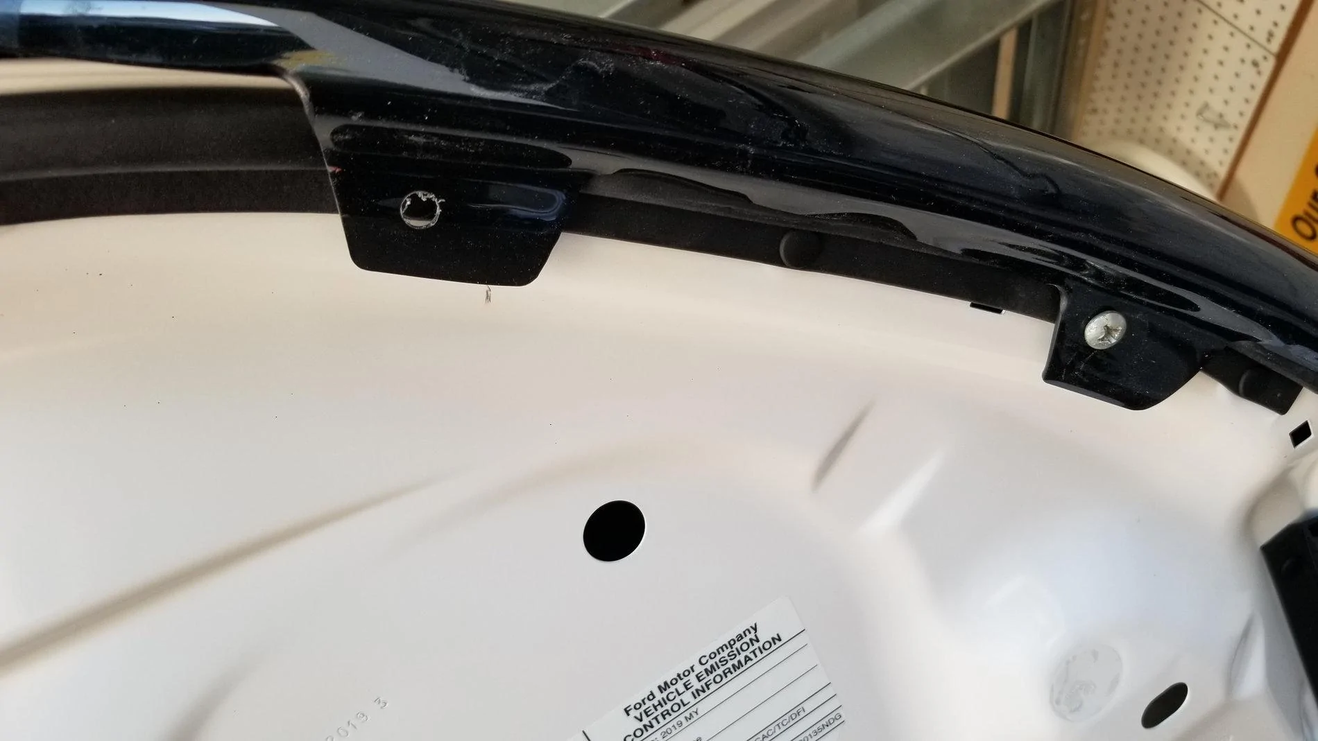

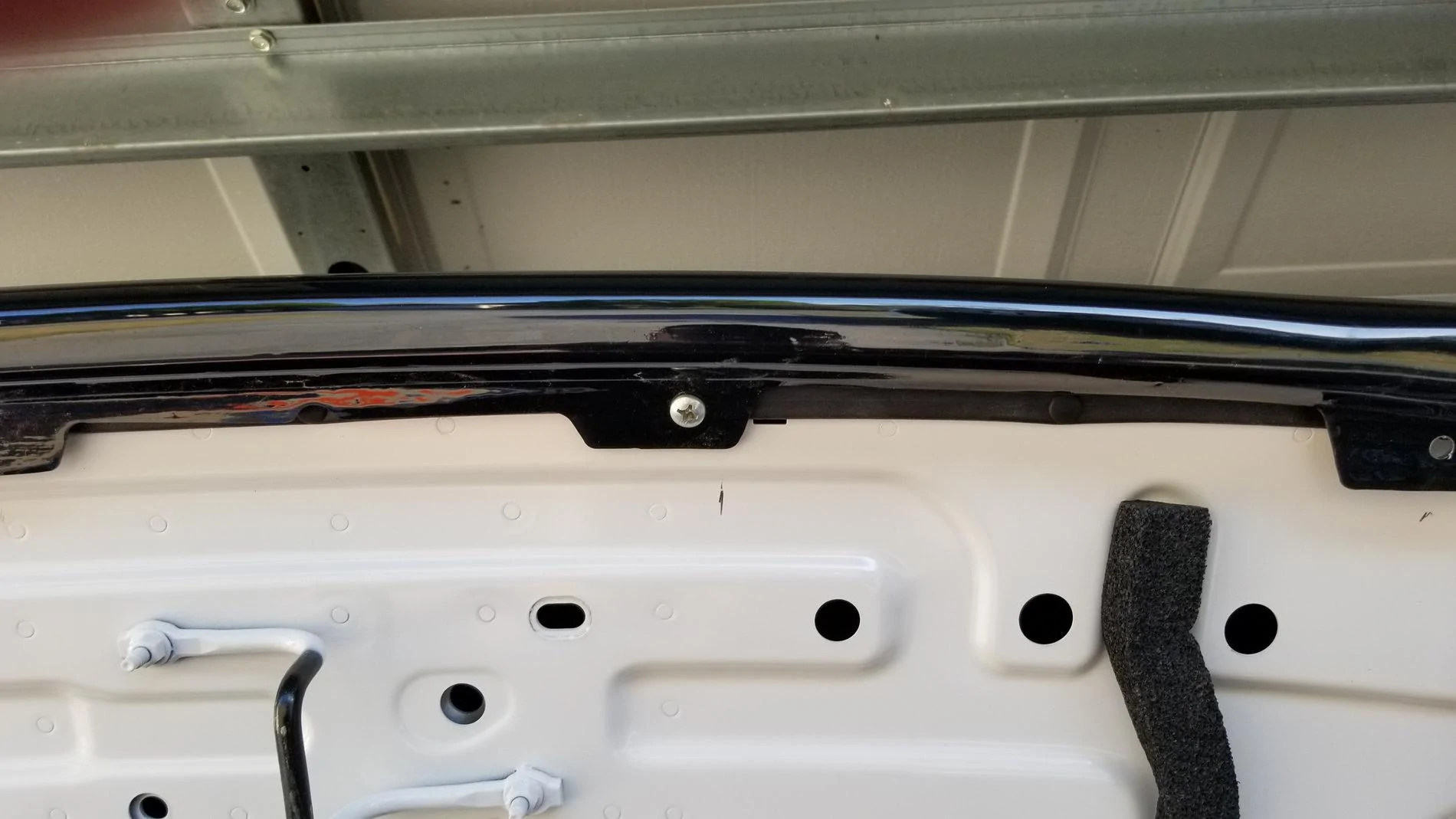

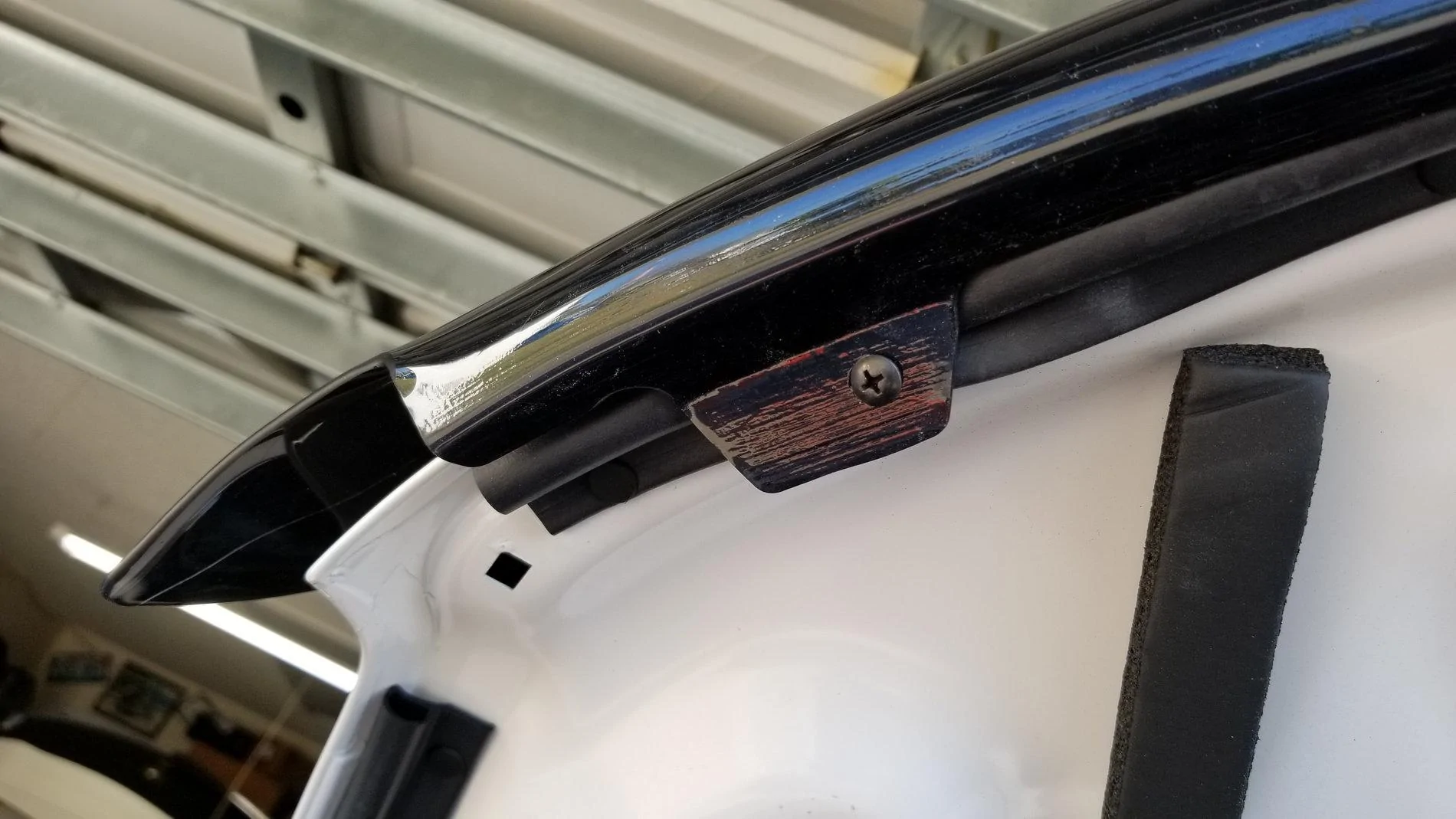

Could you take some pics under the hood at your mount points?

I used four sheet metal screws. That's all I had on hand. I will put a few more in after my next trip to Lowes
Should take about six. 1/2" 14 gauge, https://www.homedepot.com/p/Everbil...ips-Sheet-Metal-Screw-8-Pack-806651/204596414
That all said if you keep the seal outside the mounting points the pins that came with may work. I was worried about the screw coming through the hood. But 1/2" screw clears it.
Check your hood latch before installing. I had to go to Ford to adjust it as it would not close easily without the AVS!!

Thanks for the pictures it is helping me to plan my installation. I ordered the AVS Bugflector II (25954) full height from Rockauto out the door for $62.83. I have a 2019 XL Ranger. I don't think I want the attachment points (tabs/screws) on top of the hood gasket as it appears to be in your photos. I was thinking tabs should be under the gasket.

YEah, You are right. Remove and reinstall. I miss read the installation instructions good enough, I have to move the seal to the outside, and I will need pins to reinstall the seal and Deflector.

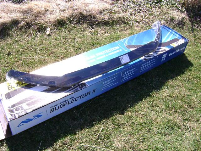

Got my Bugflector today.....the box was big & clumsy the mail man would not put it in his vehicle I had to go get it....lol. Looking it over it looks like it will work out. I am just hoping that I will not have to adjust hood to close properly. Will find out next decent weather day that I am off work.
