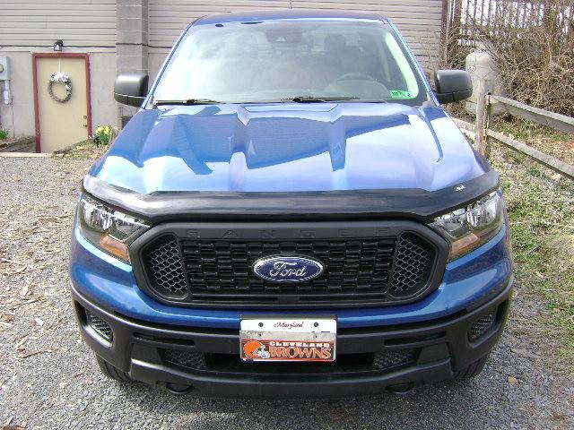

For anyone interested, this is the AVS Bug Deflector. The OEM one does not have a lip to send bugs and crap over the roof. The AVS has a lip to direct stuff over the hood.I know a lot of people won't consider a bug deflector due to aesthetics. I have installed one on every truck and/or SUV I owned. When you see crap and bugs being lifted over the cab it becomes valuable.

Ok, which model did you get? Is it the AVS II? I got the AeroSkin and didn't realize it's direct mount to the surface of the hood. Not really what I'm looking to do, ugh.
AVS Bug Deflector II. It uses the pins already on the truck...However, I used four metal screws and applied another seal under the AVS.

Uh it ain’t got the lip ,. But it looks better than the avs,.. oem bug shield looks like a custom not a generic ,, I like it .... on my 2011 I had a avs on it and on that truck it looked good ,, but 2019 .. oem,. Just not aeroskin .. that one looks like shit
