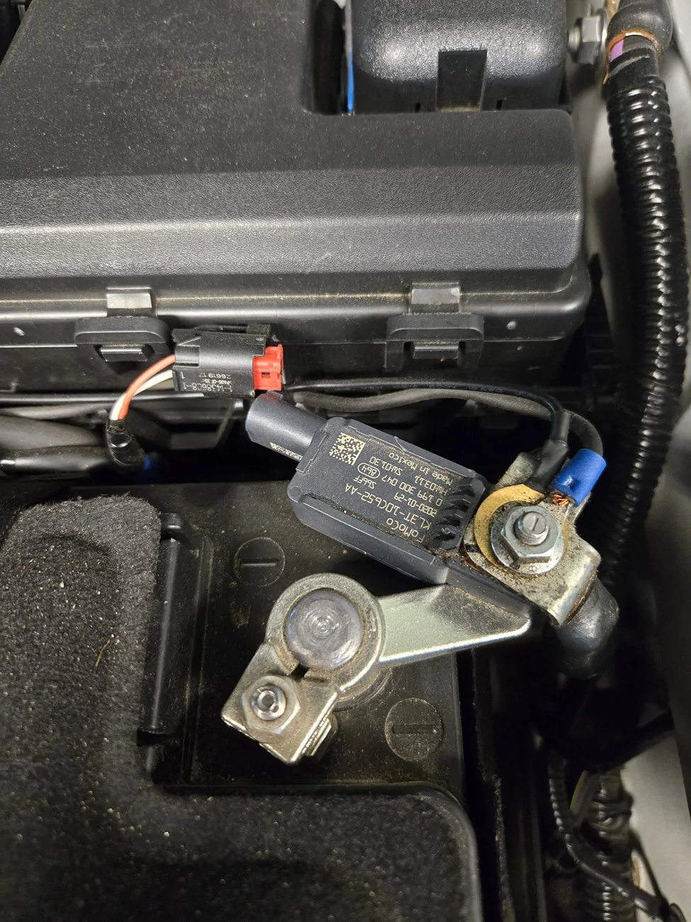

There is a plug at the negative battery connection. Unplug it and no more ASS. This anly works on the Gen5 Rangers. I thought this was common knowledge. I hate to see people have spent big $$ to disable this. I think because this truck was designed in Ausy it was added in the US with a simple switch easy to get to.
It does more than disabling Auto Start/Stop. Disconnecting it will also disable the Battery Management System that controls battery charging and presumably extends battery life and helps fuel economy.
I'd rather just plug in a phone charger or a night light. Why mess with the battery system?
