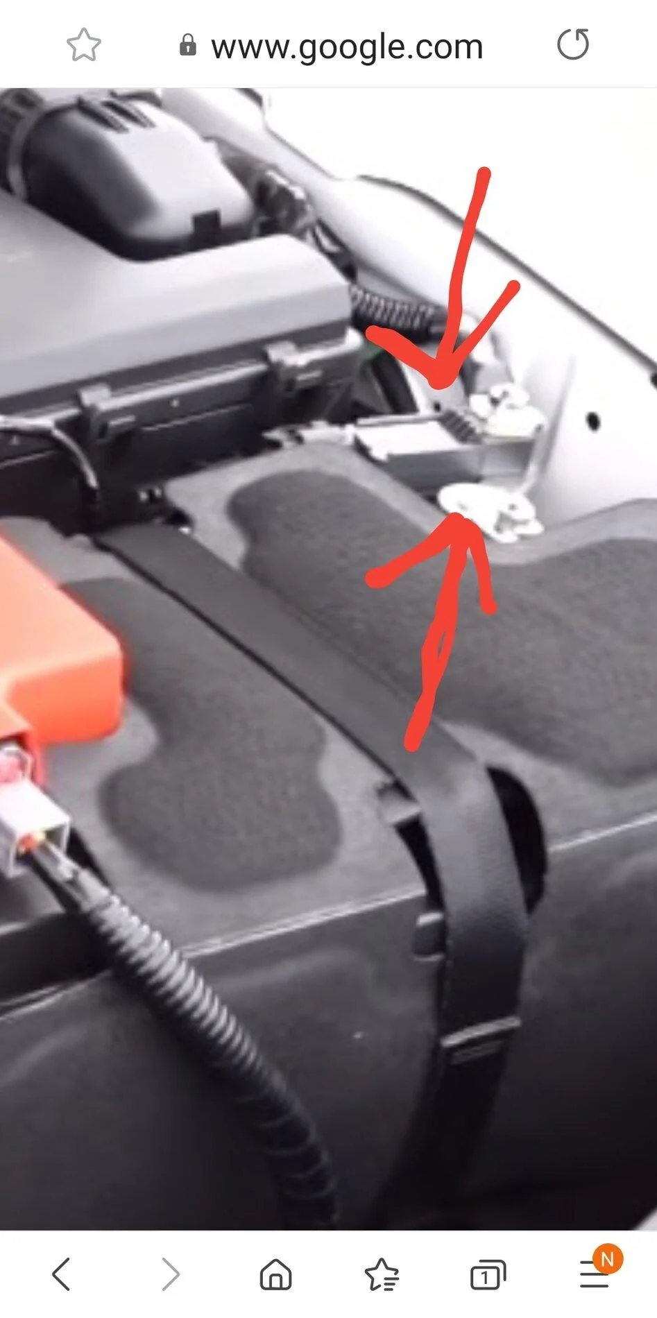

so this part if unplugged will cause the auto shut off to stop . Was told it is the part that disables it if the battery is low . The question is does this control anything else before I unplug it to stop the auto shut off
It is the BMS or Battery Monitor Sensor. It monitors the state of charge of your battery and provides input to the Body Control Module, which controls all of the electronics in your Ranger. The BCM also talks to your Powertrain Control Module, that uses that information to control the output of the alternator, which provides power to your vehicle and charges your battery.
So what happens when you disconnect the BMS? Two computers in your Ranger lose data from that sensor. The alternator operates at full capacity, charging your battery when it doesn’t need to charge, wearing out the battery and the alternator and drawing more power from the engine resulting in less efficiency or lower MPG.
Can you unplug it? Yes. Go ahead.
Edit: I just thought of another benefit to unplugging. If your battery gets low while your car has been parked for days in the airport’s remote parking lot, you will not get a message on your FordPass app that “connectivity services are being shutdown to conserve battery.”

Don't have much hope for the Alternator due to its location being close to road debri and water . So don't think it will ware out before it being damaged due to road grime. I know it dosnt throw any codes .
