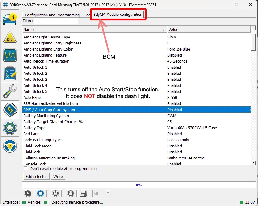

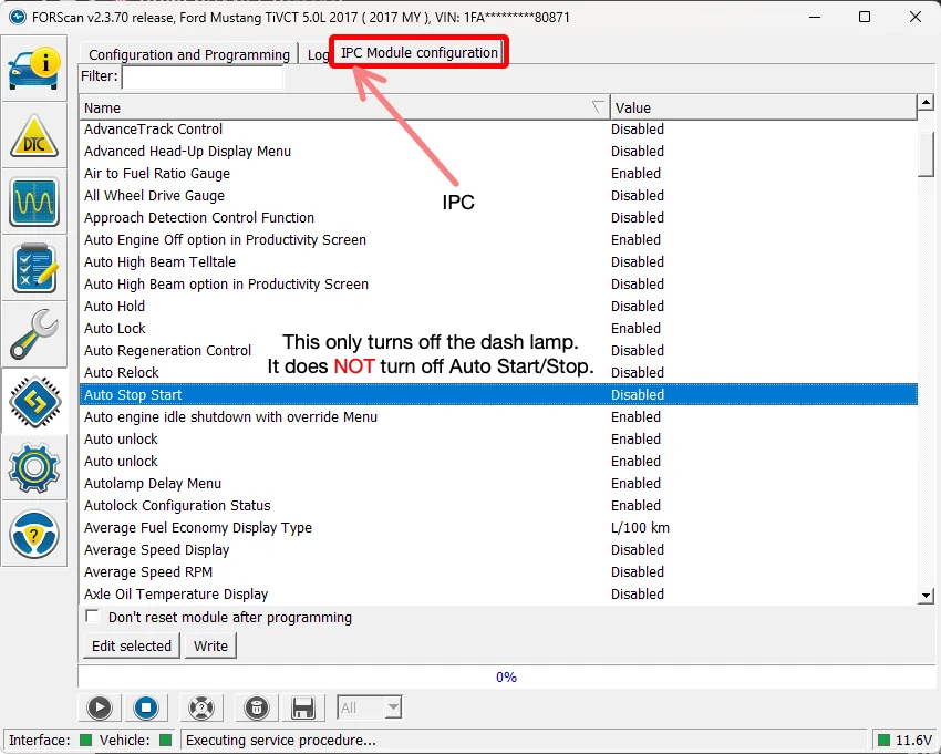

If anyone would like to try out FORScan, it's quite simple once you work with it for a while. If you don't change & save anything, you won't hurt anything. --> Lots of YouTube vids out there make it easy. <--
If you need to change an "(AS BUILT format)" setting, then yes it can be a little un-nerving.
But not all changes are like that. Many are mouse driven with no editing involved. Here are two screenshots.
One is enable/disable the ASS system.
One is enable/disable the light on the dash.
These screenshots show 'disabled' because mine are disabled.

Yes, this is just a short-cut way to change the (2) As-Built lines
But - I am noting something here and am curious if this line (Auto-Changes) when you select (Disable) from this (BCM) Screen
I am looking at - BMS - PWM - with the BMS - ASS - Enabled - this reads LIN
If this is auto changing - this would explain why @TJC and his charging system monitoring (if he has this disabled) via Forscan - he still sees some sort of BMS (operation) behind the scenes and backs up the idea that (if disabled via Forscan) and gaining complete disablement of the BMS system + ASS is not a 100% true statement as it has been (commonly stated - here)
Yes for (ASS) Only - you are removing the (Slave) input for the ASS System to enable but I do not 100% think the BMS system is fully being disabled.
I know with my - Factory Delete - ASS
This Hex-Line section of the BCM- BMS - remained set to Enabled + LIN (Control)
I am curious if that line was changed to (None from LIN or PWM) would the BMS truly enable full charging control (same as old school)
The point I am trying to make is:
How does the BCM / PCM react (Behind The Scenes) is this is set to (PWM) as this setting is for BMS (In Car Configure) - so sensor type.
We do not know (100%) if changing this from LIN to PWM, we know that the sensor cannot communicate via PWM - but inside the BCM (programming) how does it respond to the switched data vs telling the BCM (No BMS Sensor - Installed (NONE)
I know I am overlapping here - ASS + Charging, but for those that have disabled via these screens - Did the Hex Line Change - to PWM like posted above? I am just curious if this is a factor for those that have done this (mod) and still report battery issues - this may be a factor
Wow, you're right. My '22 Ranger, ASS disabled from the factory & BMS was enabled. But
My '17 Mustang, manual trans, so ASS disabled from the factory, and BMS was disabled.
I have no battery charging problems in the mustang that I know of, but I changed the BMS to enabled.
I did that because I drive the Mustang much more often in the summer. I'll keep an eye on the charging voltage. This could take a while.
Edited...
I have no battery charging problems in the Ranger either, but I think I'll change the Ranger to disabled tomorrow, and try to drive them both around quite a bit.
