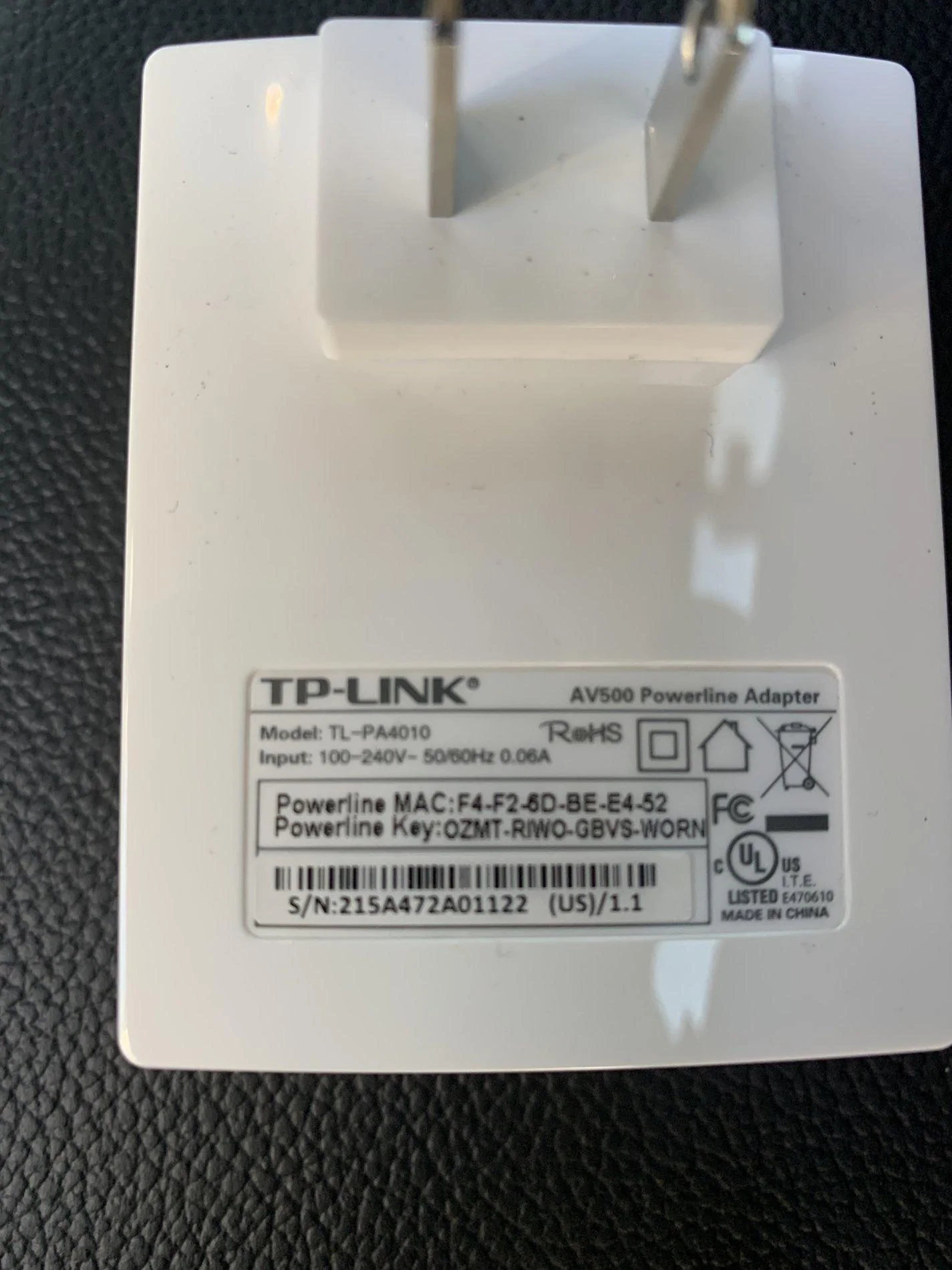

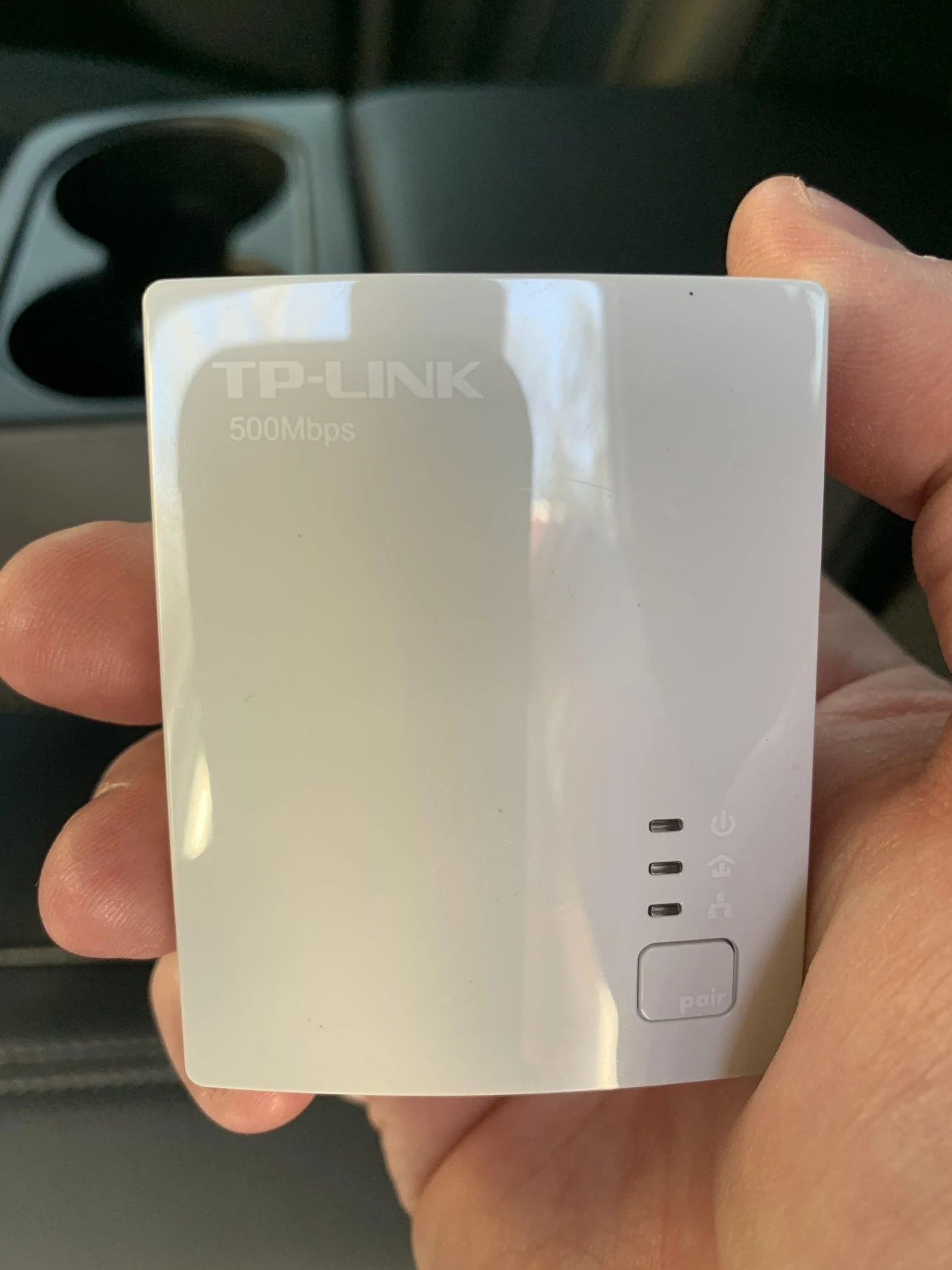

Had an extra. Been using it for almost two months and the engine hasn’t stopped once. Plugged in the rear outlet.
137,226
No need to spend $90.00, just plus in a $5.00 LED night light into the 110v in the back or drive in S mode. Both will disable ASS.

The ASS did its thing as I slowly crept forward while parking my brand new Ranger in my garage. That was enough for me and I plugged in my night light. No more aggravation.
Dave, did you find a cure for your Ranger's fear of the dark? I think mine is neurotic also.
