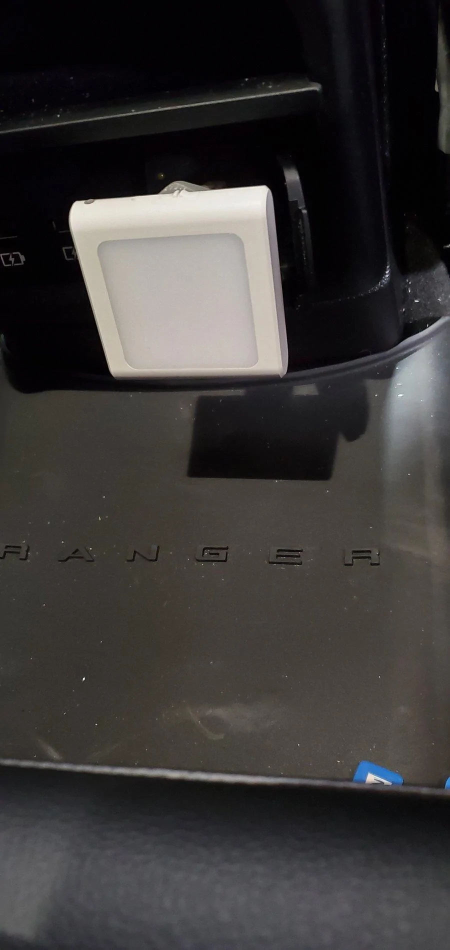

well this is what I use.
137,226
I use one similar to that too. Just make sure you don't use one with the sensor or it won't work at night. :wink: I've read where some said that the light bothered them so just black it out with some spray paint.

The ASS did its thing as I slowly crept forward while parking my brand new Ranger in my garage. That was enough for me and I plugged in my night light. No more aggravation.
that's when I decided I hated it -- It would shut off then restart in the two seconds it took to stop and shift from D to P when I parked. Yes I know there are cheaper / free ways to get rid of it but less than 90 bucks to never have to worry about it again is totally worth it to me but to each their own!
