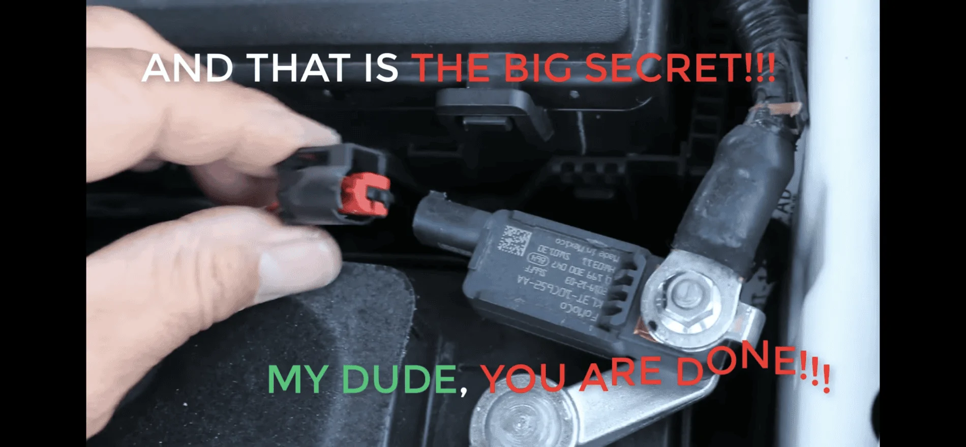

You will disable start/stop by unplugging this.Negative side of battery terminal.Works like a charm !

That's the first thing I did to my Ranger and the only thing that hasn't cost me money :)

I hope you packed both ends w/dielectric grease and then wrapped it w/a prophylactic.

One thing to be mindful doing this. It disconnects the battery management system. That means your battery is getting a 100% charge. Not sure that’s a good thing with this type of AGM battery over the life of the battery. It will most likely shorten that.
I started with this hack to start as the ASS system is a PIA. Then I used Forscan and changed the factory charge amount from 75% to 90%. Also deactivated ASS. Been that way for months now without any issues.
With all the electrical demands from all the systems we’re running would prefer a little more head room.
