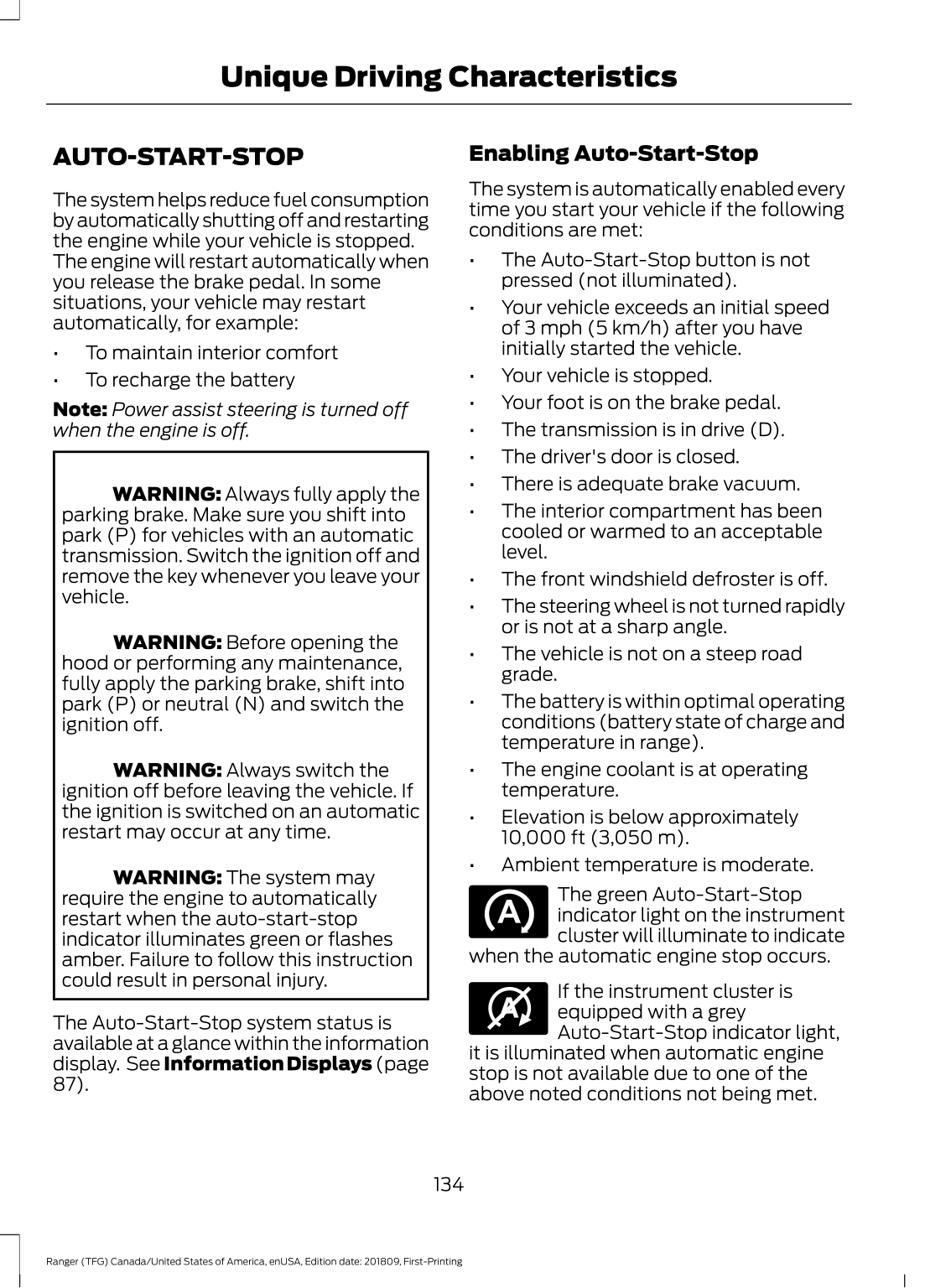

Maybe its that the interior hasn't been "cooled to an acceptable level"? I wonder if the temperature you set the interior at needs to be met before it works. That's kind of a vague statement though so I will give that shot, thank you!

I think it might be because the ambient temperature is too high...if the engine shuts down then there is no coolant flowing....and that can heat soak the motor making it too hot to run, but that's just my guess.....I live in West Texas and have had a few 100° days and the auto stop works alot less mid day....try driving in the evening or night and see?

Ran a couple errands today, and used the left screen to see what the auto-start/stop was up to. Again it only actually shut the engine off 1 time during my errands, and all the other times I came to a stop light or had to otherwise wait for traffic it said the engine was running to charge the battery. Seems odd to me that with a presumably full battery from driving it around yesterday it would have to keep charging the battery after only starting it once... but whatever.

Remember these modern vehicles have a lot of parasitic drain on the battery for all the electronic "goodies". It doesn't' surprise me the reason it isn't kicking in is due to charging since you haven't been driving it much.

I know with my truck that if it is in Sport mode, the start stop feature is turned off automatically

In my case, if I have not driven in a while, it won't stop until the battery is fully charged. Also, in Texas, it won't stop if it is hot out and the AC is "on"

There is a menu you can display that will show you the status of stop/start. If it won't engage it will tell you why (charging battery, etc). It is in the left hand windows on the Lariat.

Hello, I was wondering if any one had trouble with their auto start stop not engaging? I just bought it so I am not familiar with all the bugs just yet. I read the manual and it said that certain conditions have to be meet for the auto start stop to work such as it cant be too hot outside or cold, is that true? What temperature ranges does the auto start stop work in? I am in Tempe, AZ and its over 100 degrees F here so maybe that the problem. Is there a way to over ride it so its on no matter the temperature outside?
