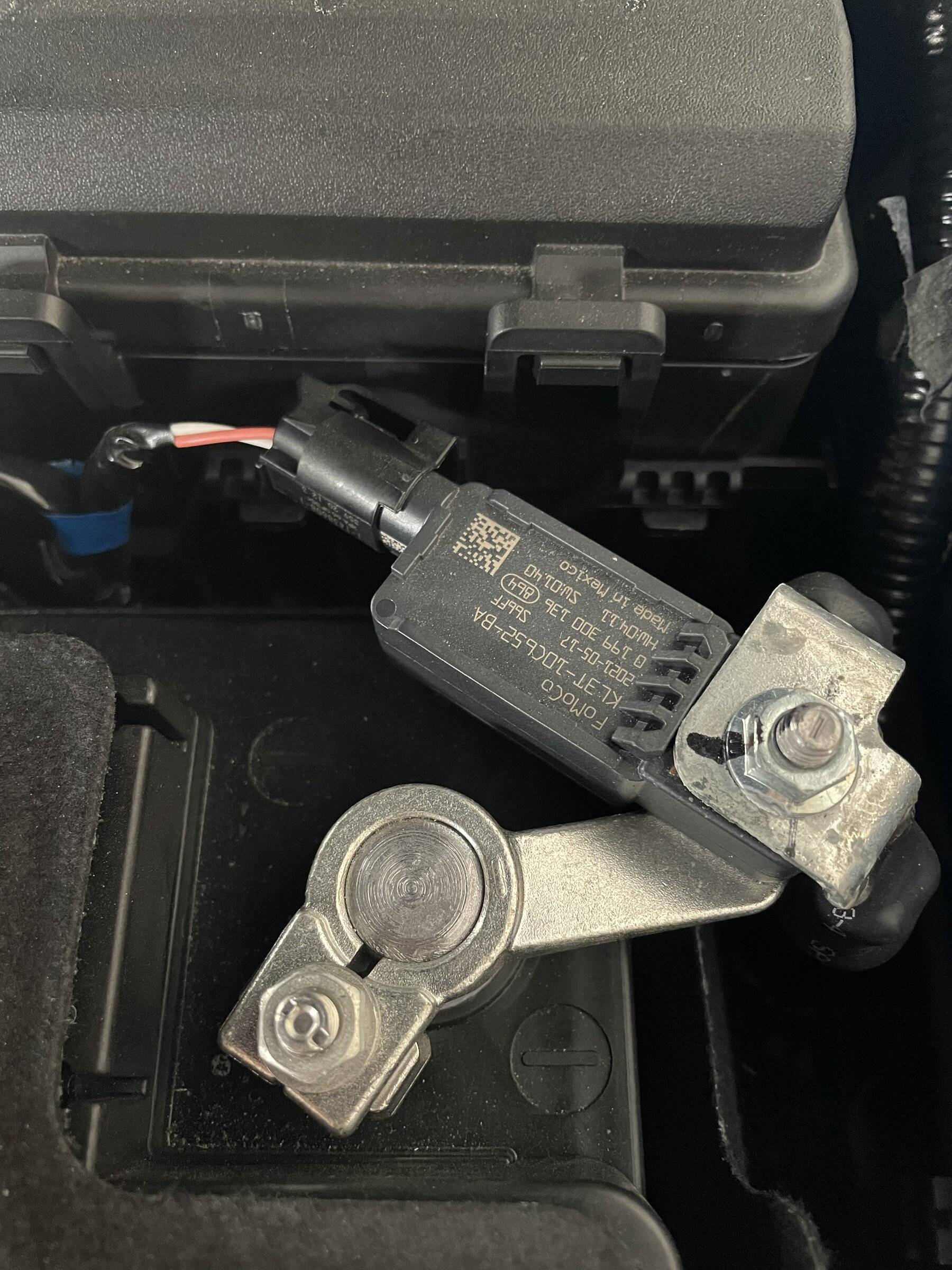

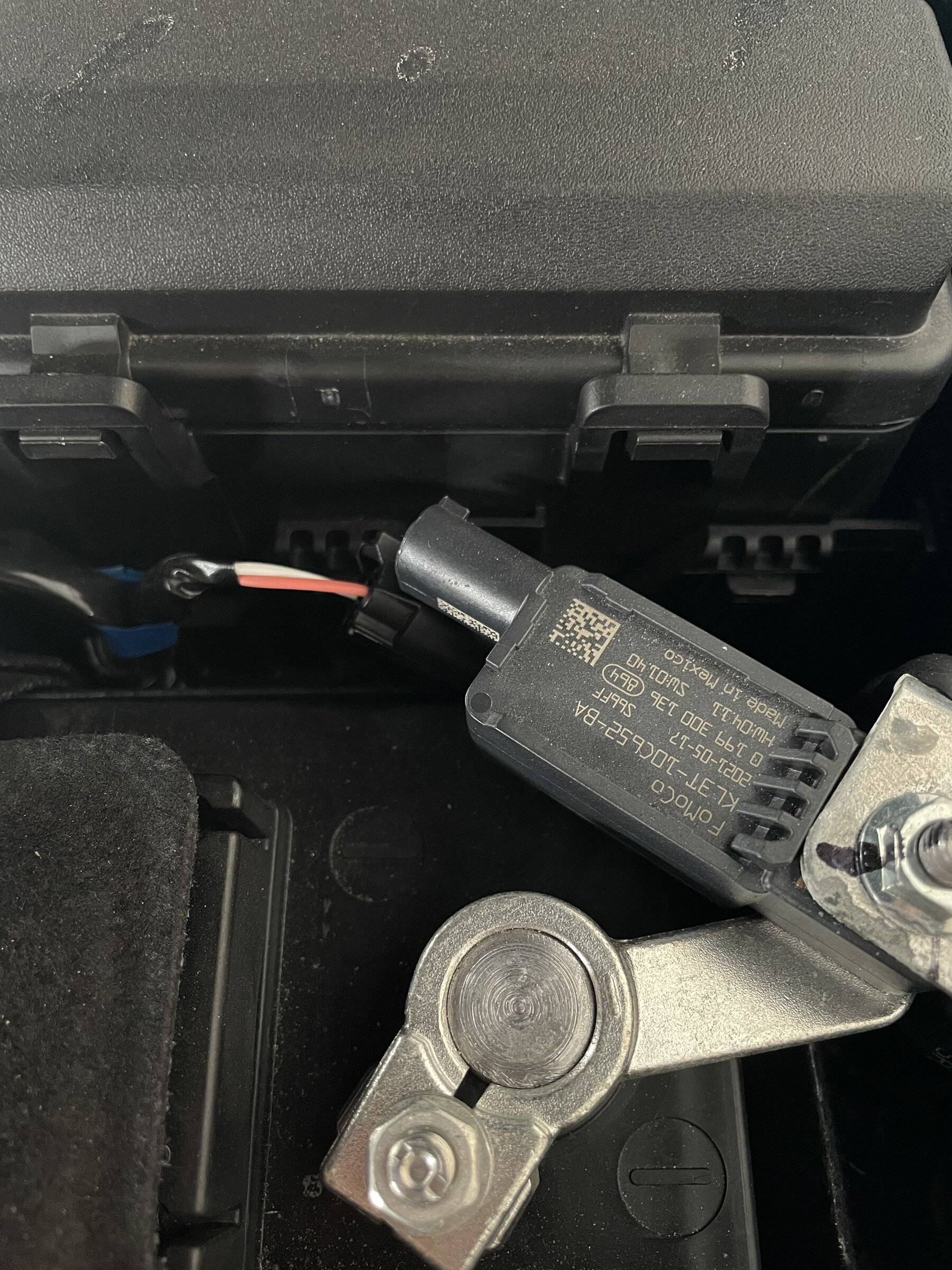

Disconnecting this wire to your battery turns auto stop start off for good. The wire tells the system that the battery has enough charge to stop the engine. Without it connected it doesn’t know. You get no other warnings on your dash with it disconnected.
