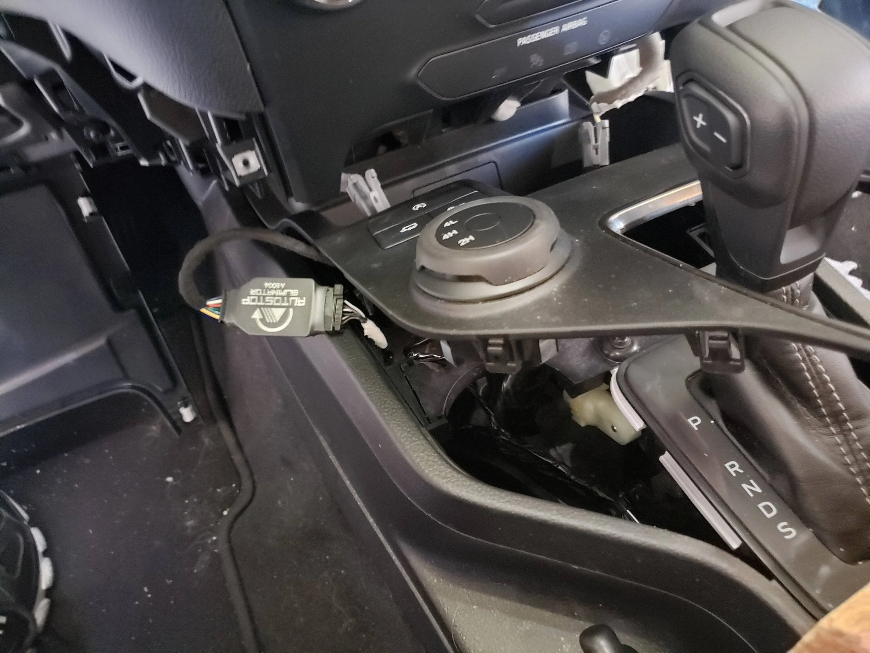

My dealer service dept. also said disconnecting it on the Ranger could create issues and suggested not to do it. After a year of using the stop button...installed this device and now can select either off or on and it remains in that setting...

I've used the Eliminator on my F-150 and now my Ranger and they work just great.If you want to use S/S turn it on or if you don't just turn it off.It's definitely worth the money
