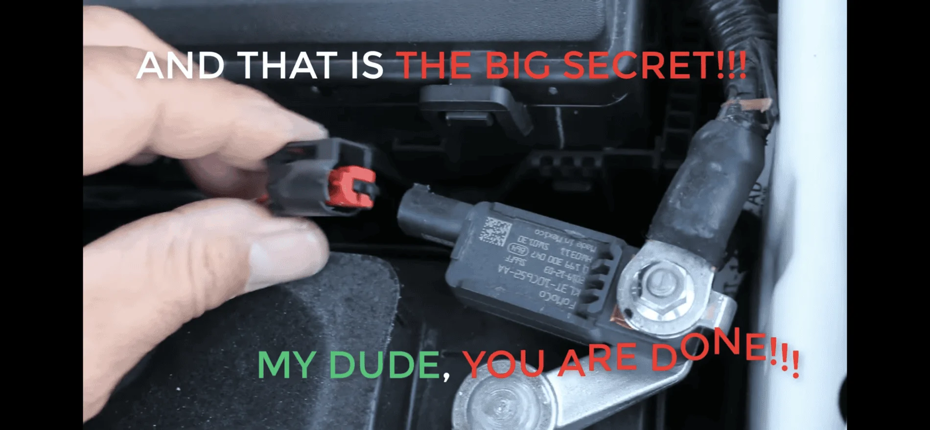

I have a 2019 xlt and to disable the stop start function there is a quick disconnect cable on the negative side of the battery, unplug it and away goes the annoying start stop.
I’ll check it out. That’s the only function of that cable? thanks

Yup, unplugged mine and never had an issue again. When you come to a stop the little auto stop Indictator on the dash will illuminate but doesn't stop the engine. Plug it back in with the engine off and it works like factory again.

No that is not the only function of that cable, just so you are clear - reference all the BMS and battery threads.
