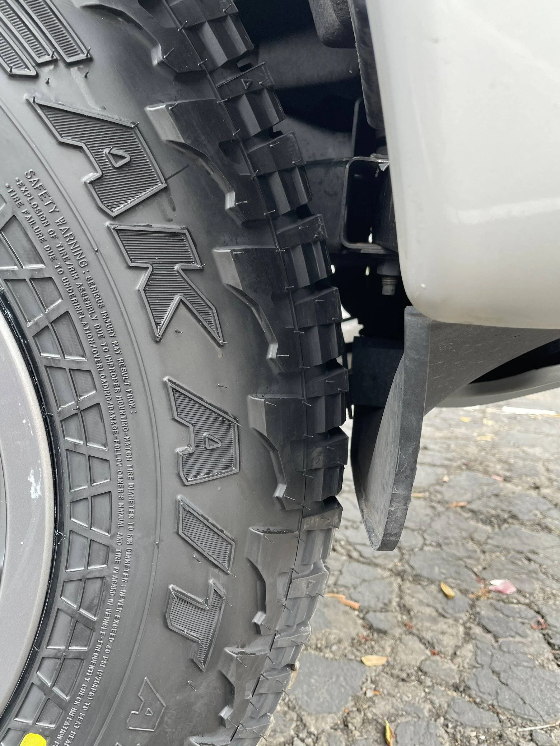

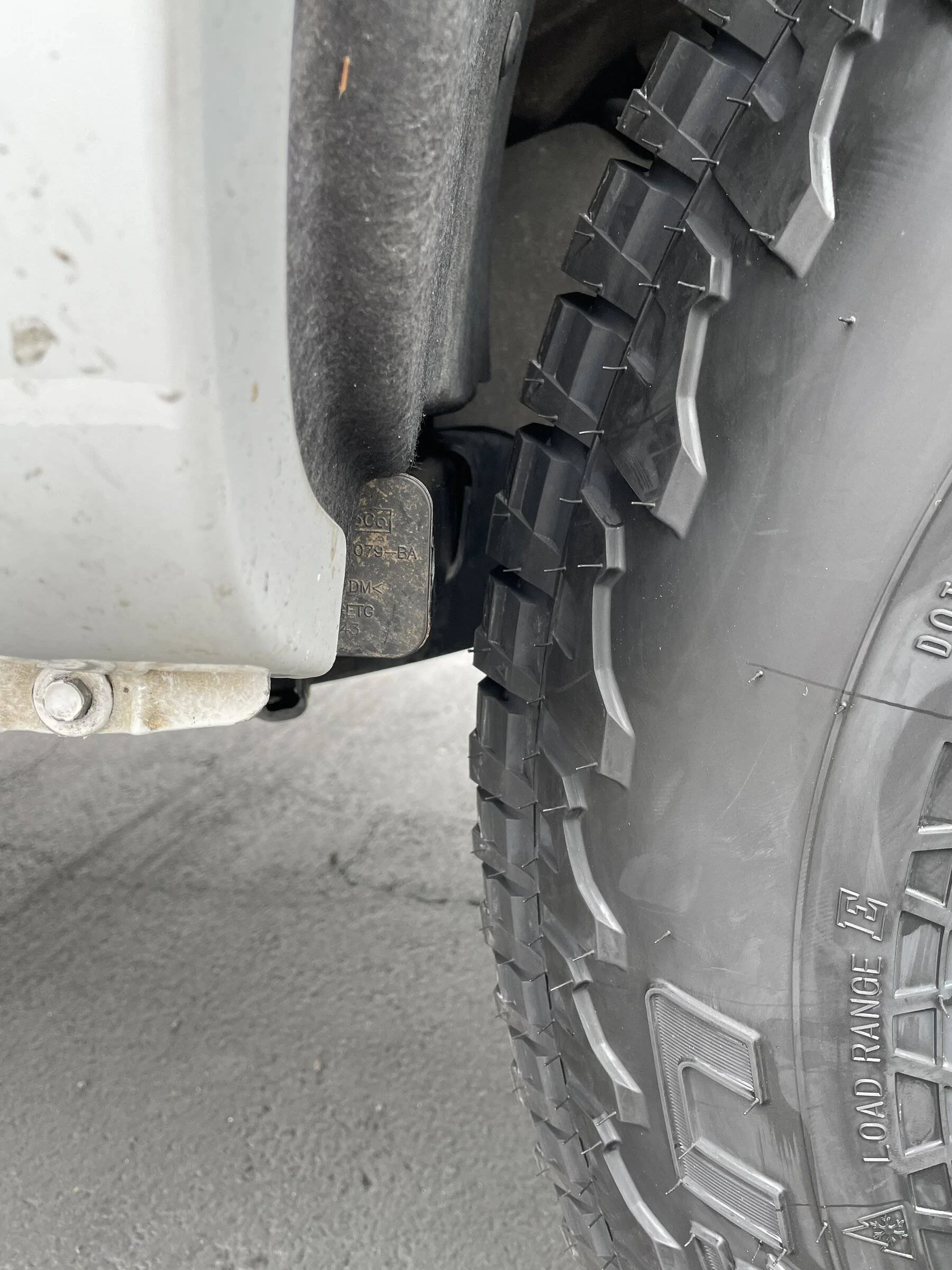

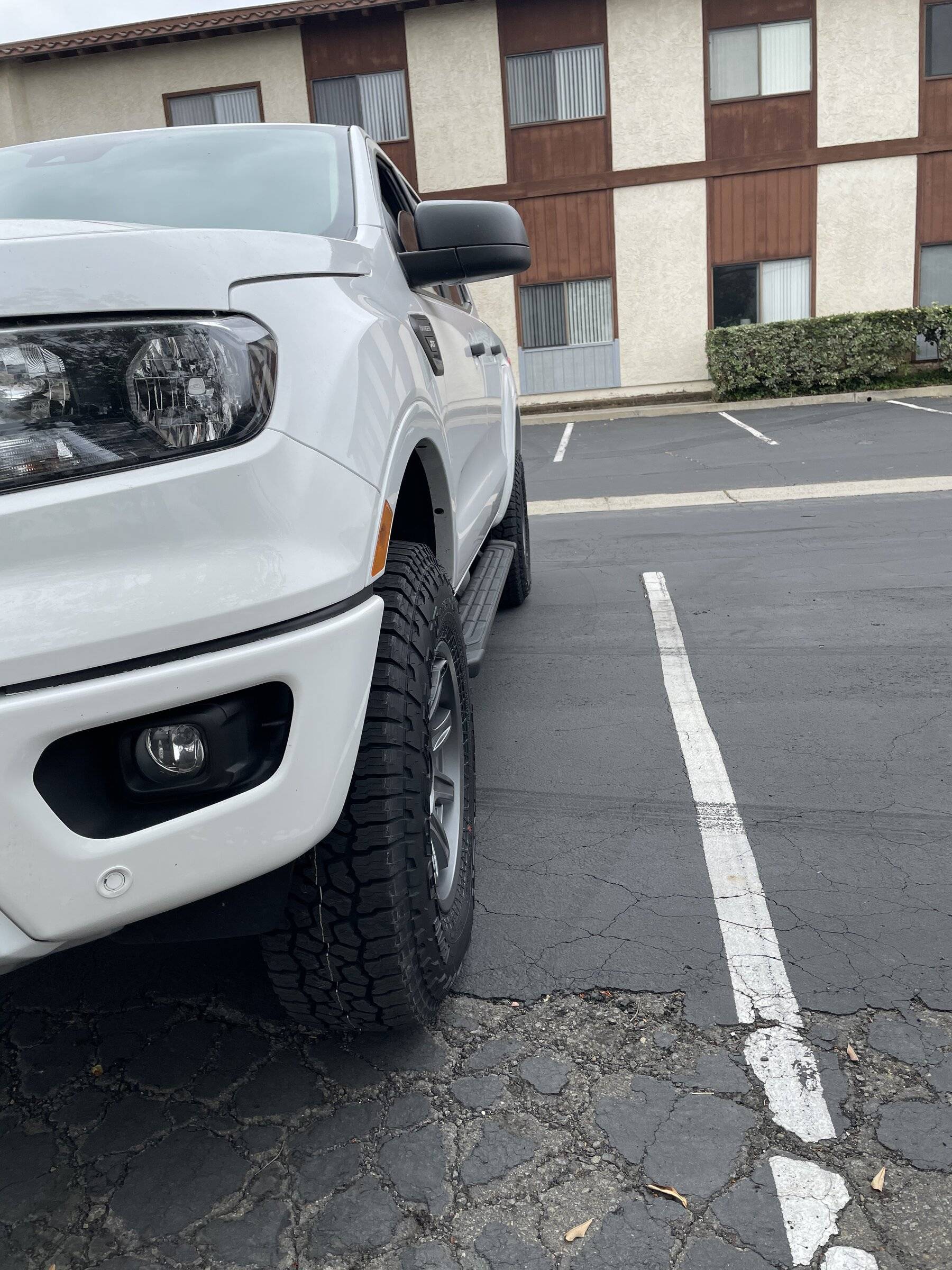

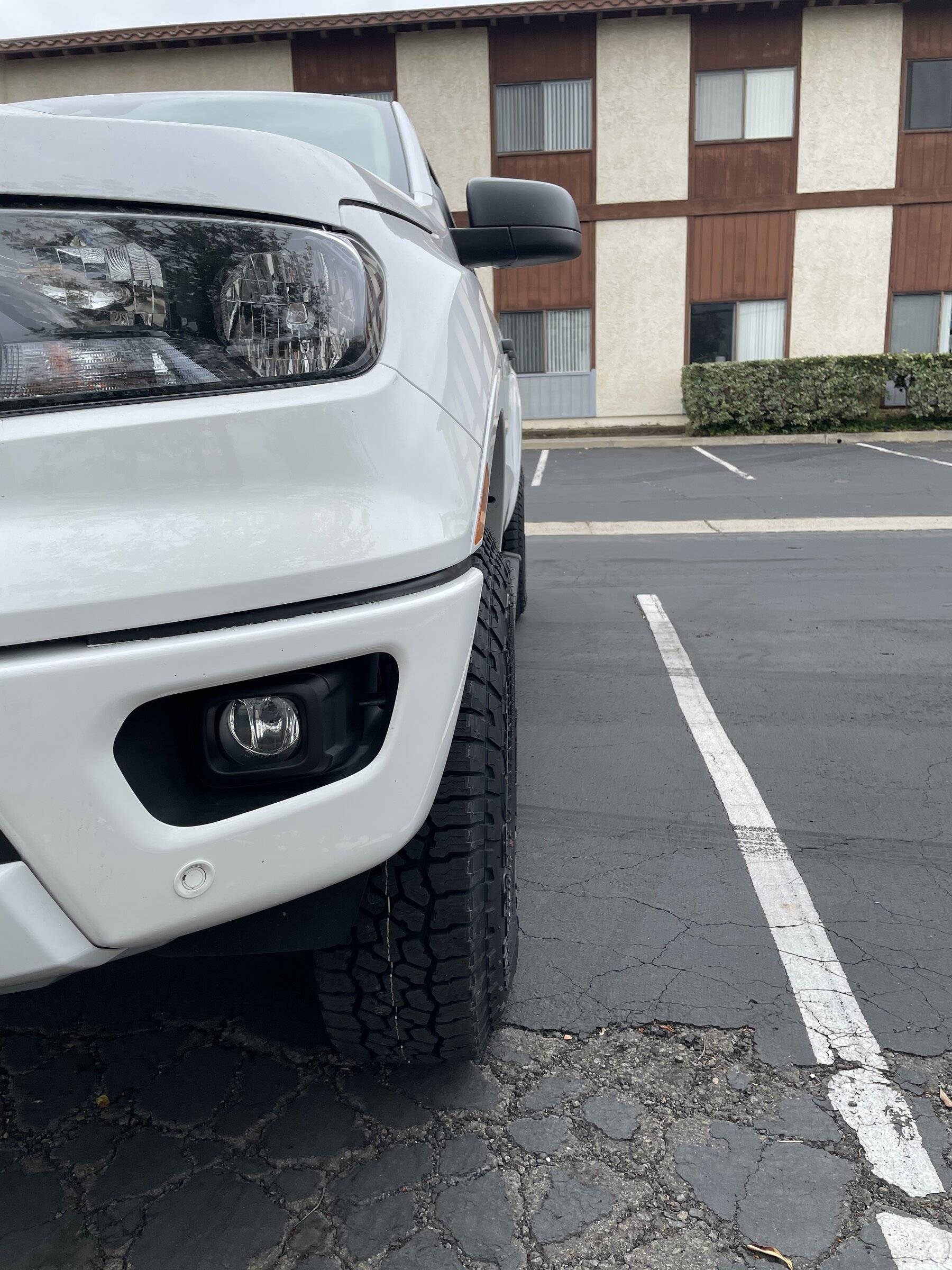

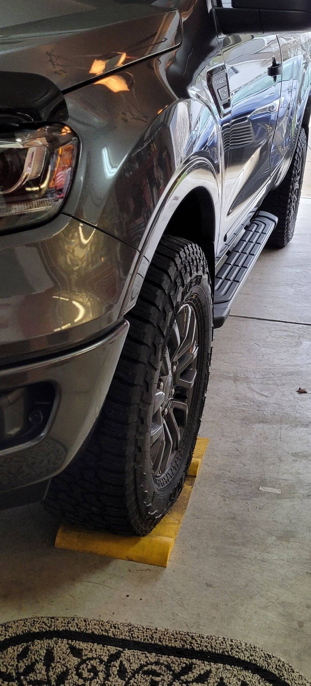

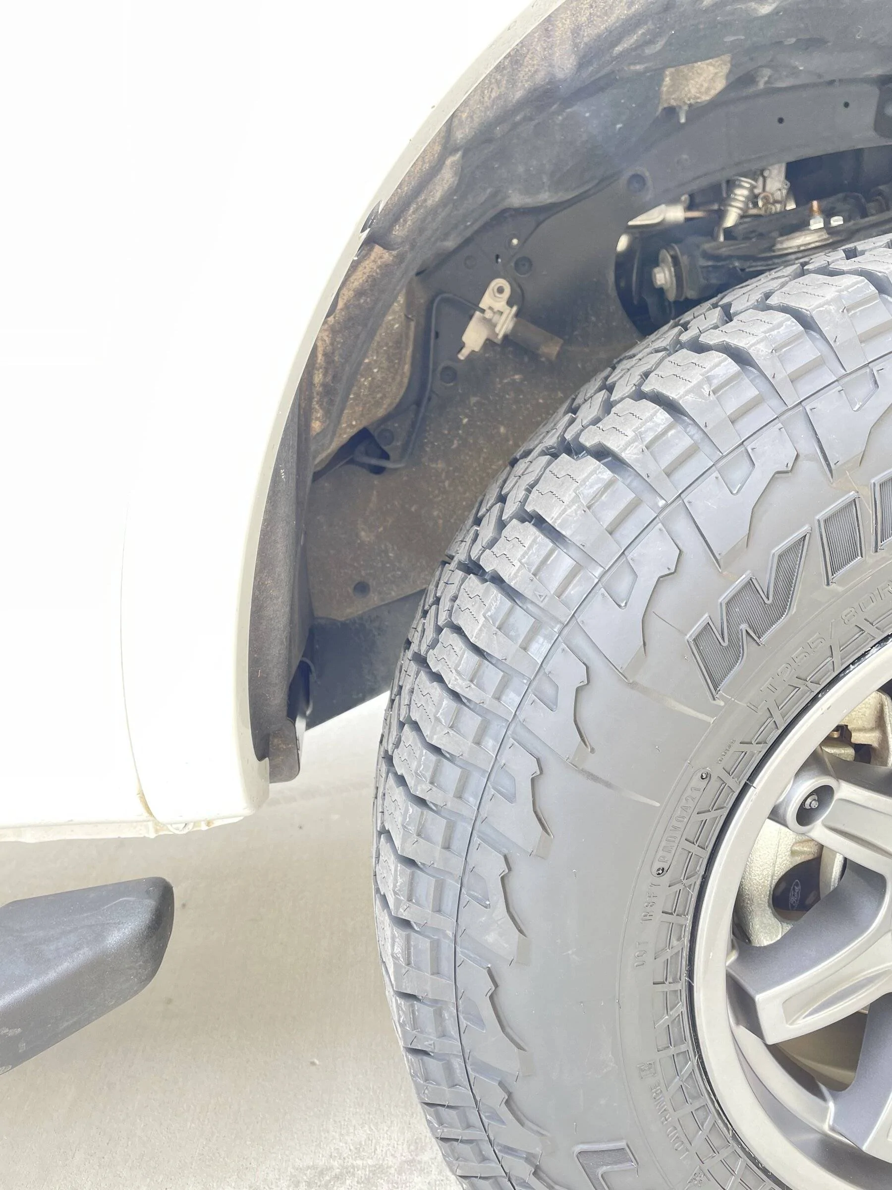

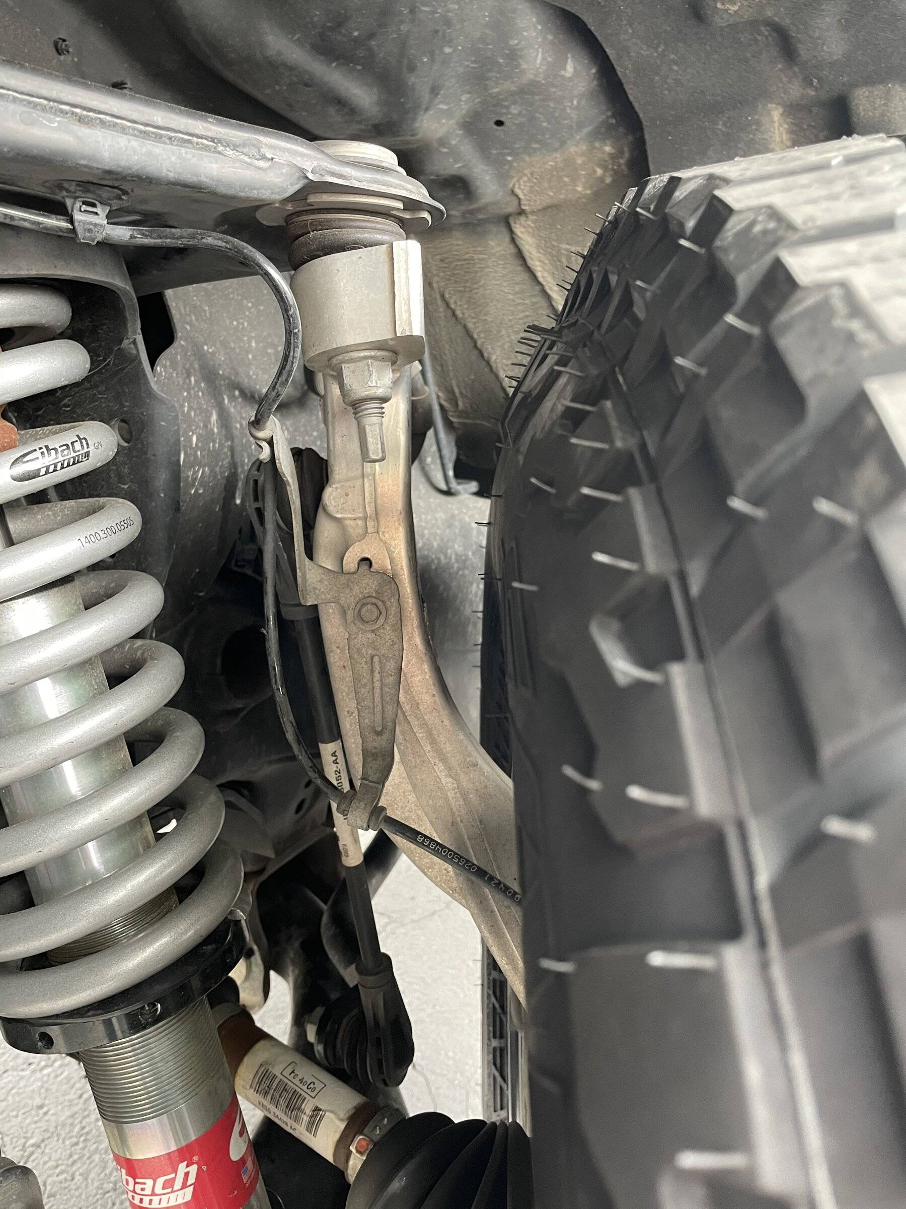

Hey D Fresh, i installed the front BDS crash bars before I got the tires put on just to be safe. I think the tires still might clear with the factory crash bars installed. I only added the front and left the rear stock. I unbolted the rear and pushed them back. Here are some pics.
Rear full lock
front full lock.
It’s hard to tell but there is more room then what the picture shows. I also kept the little plastic front splash guards or whatever they’re called. Took the truck on some trails, no issues yet.
Rear full lock
front full lock.
It’s hard to tell but there is more room then what the picture shows. I also keep the little plastic front splash guards or whatever there called. Took the truck on some trails, no issues yet.
Looks tight, but if the splash guards (spats?) aren't rubbing, the factory bars might clear.
Are those the AlphaEquipt?
Have you got any shots from the front to show how they fill the fenders?

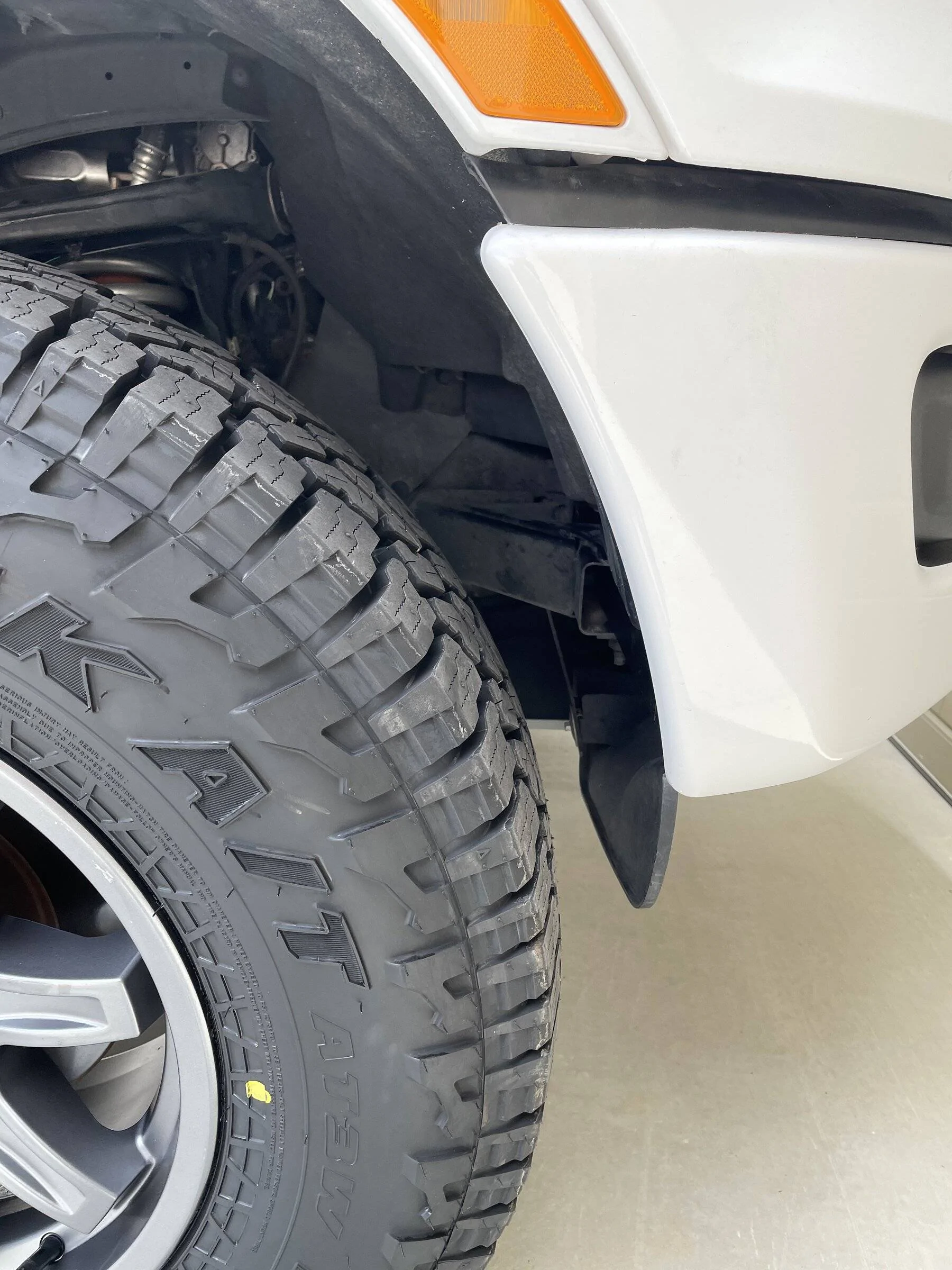

I am running 285/70/17 on 8.5” and +35 wheels (Method 705s). I have no level (stock Tremor so their is a bit of a lift) but I did replace both the front and rear crash bars with ReadyLift bars (left the plastic waffle). No rubbing issues with my setup though I have only done a small amount of off-road driving with these so far.

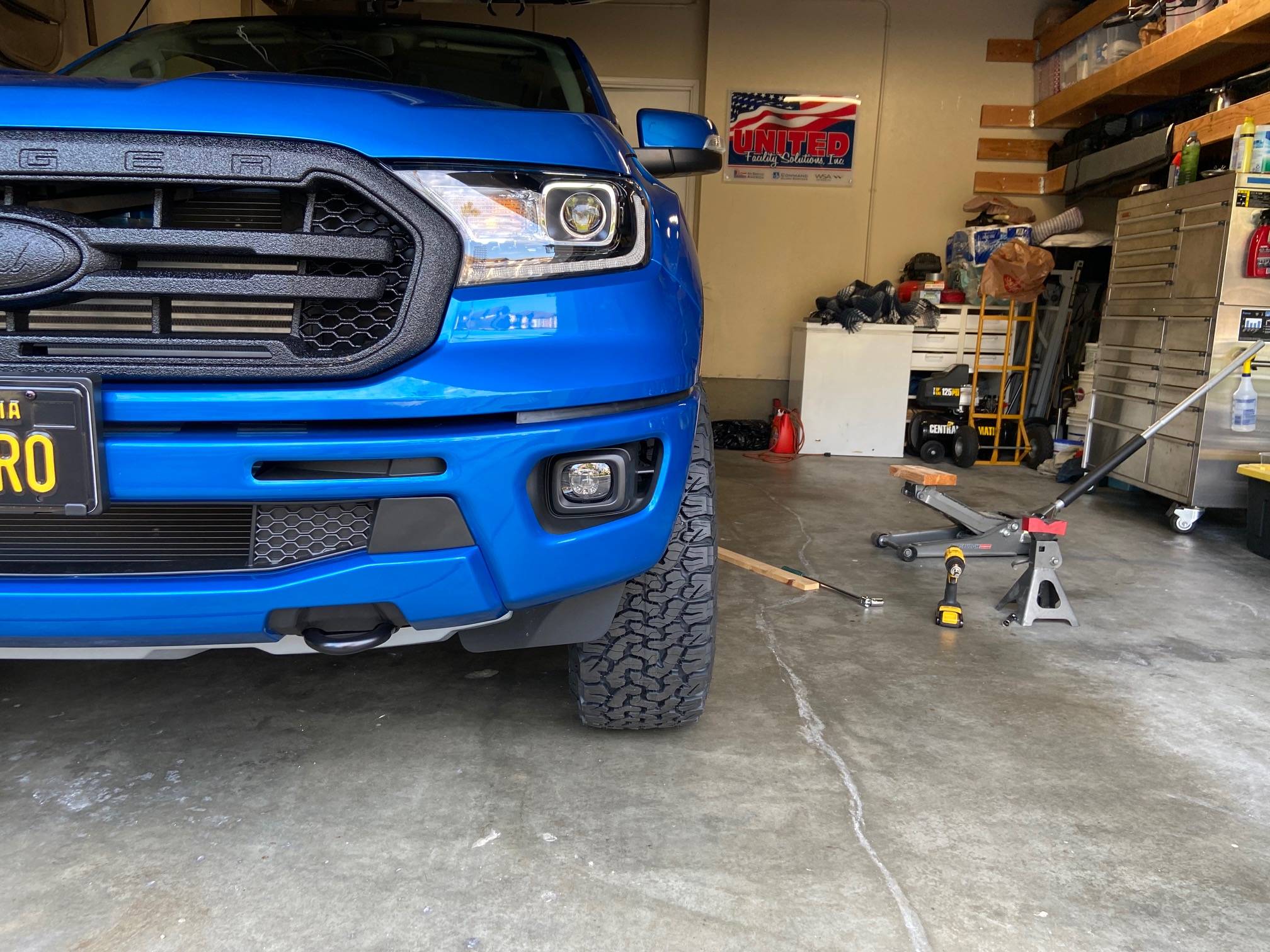

I have Method 316 wheels 18 x 9 5.75 backspacing or +19mm offset with KO2 285/65/18 tires using BDS front and rear crash bars, Fox 2.5 Coilovers set to approx 2.5 lift no rubbing. Only issue was the remote reservoir for the shock rubbing on the drivers side because the lower radiator hose would not let me move it over far enough. Adjusted the shape of the mounting bracket to get it to fit.
