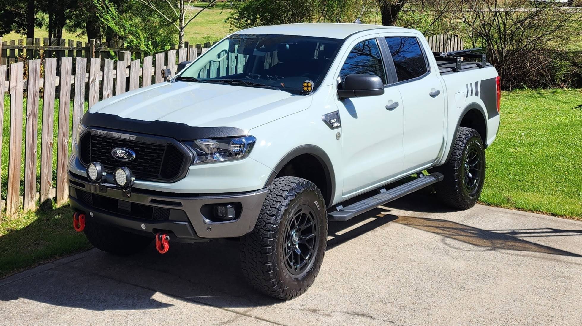

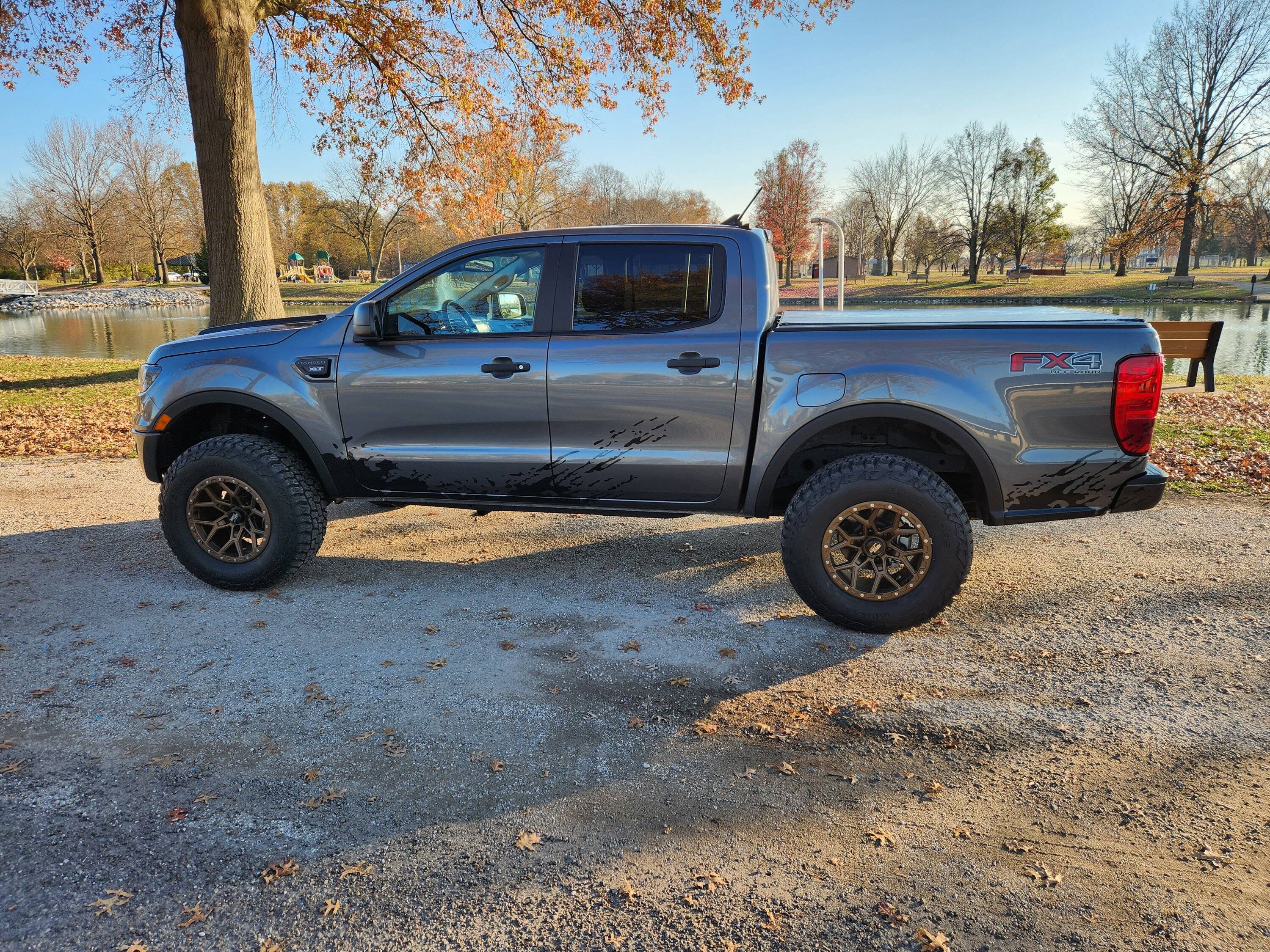

Pic from almost 3 years ago and pic from this week. (same tires 285/70/17 Toyo OC2)

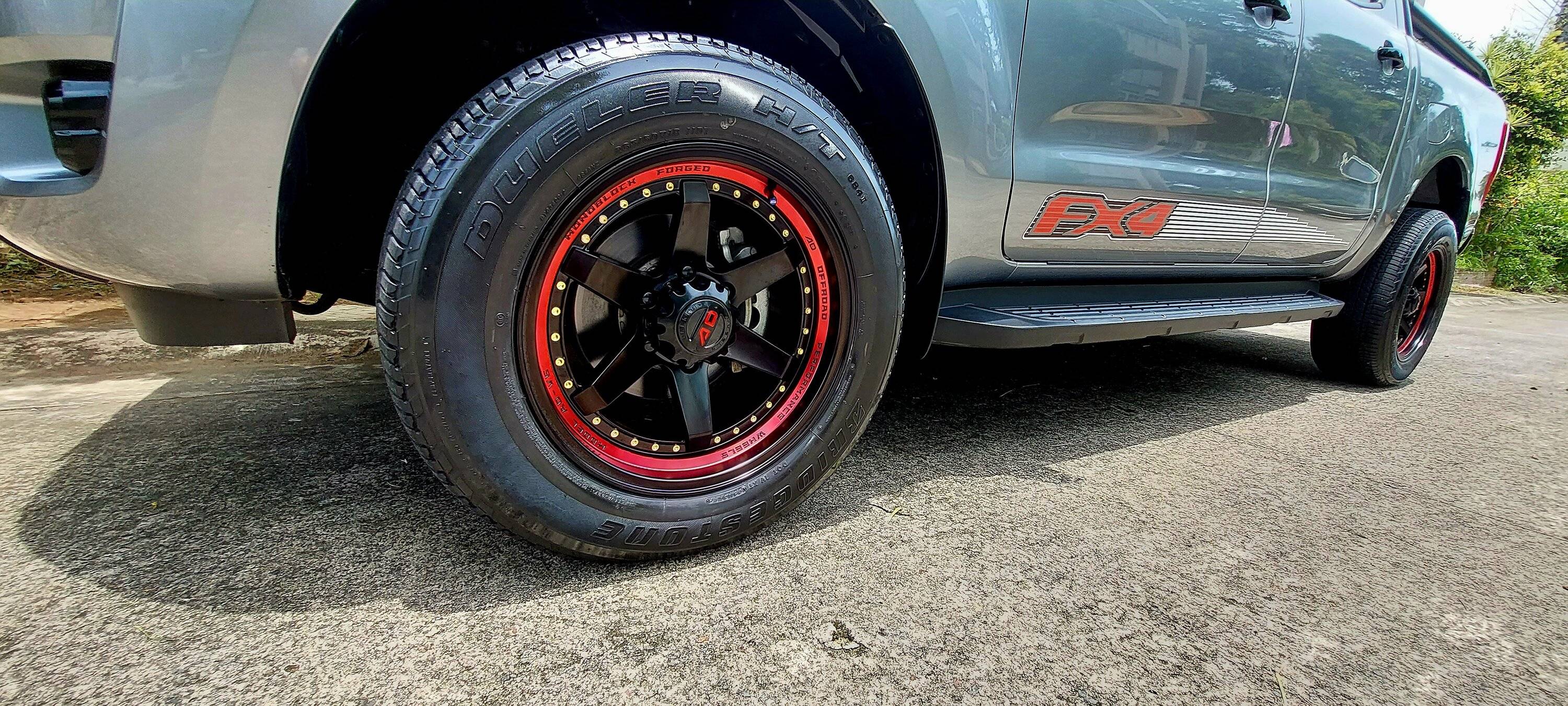

I run a 9.5 inch wheel. But using my stock Bridgestone 265/60/18. Will go bigger when I get some wear on these. Still less than 5k miles.
