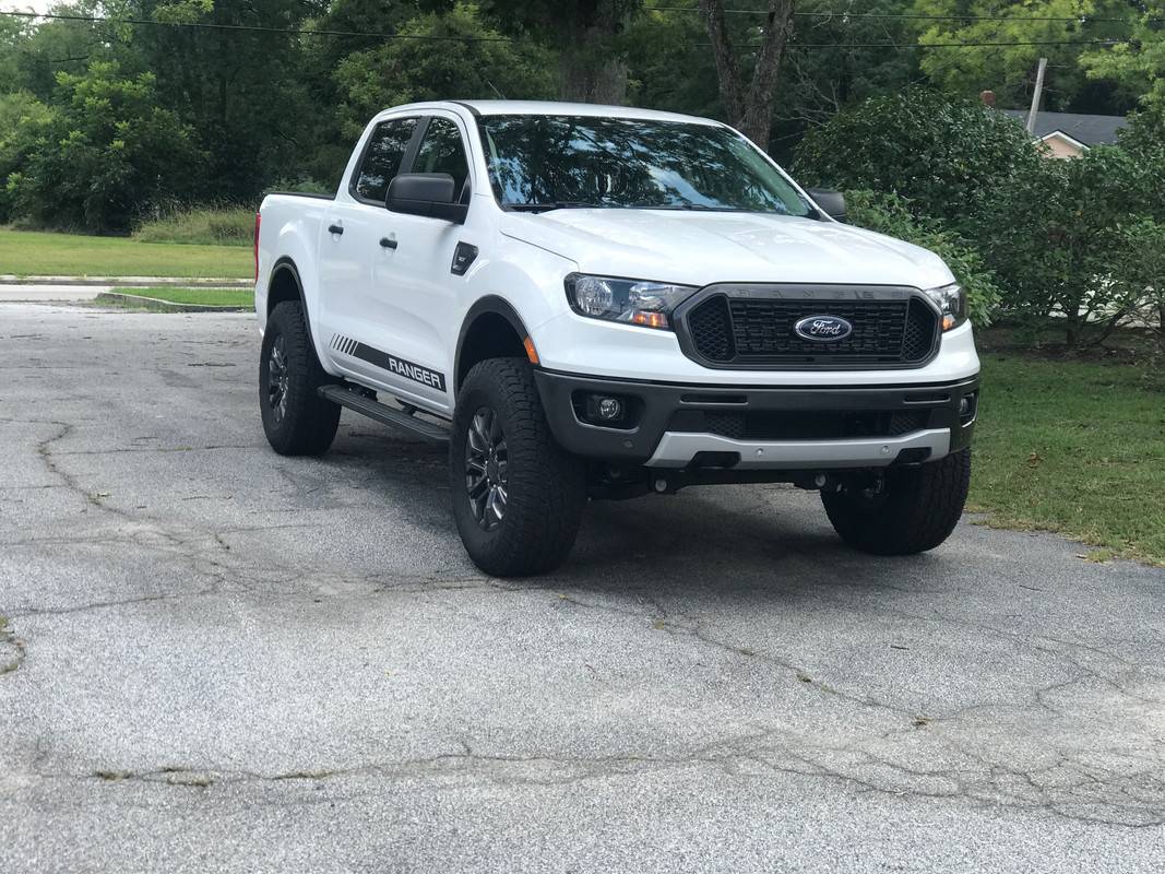

Pic from almost 3 years ago and pic from this week. (same tires 285/70/17 Toyo OC2)
