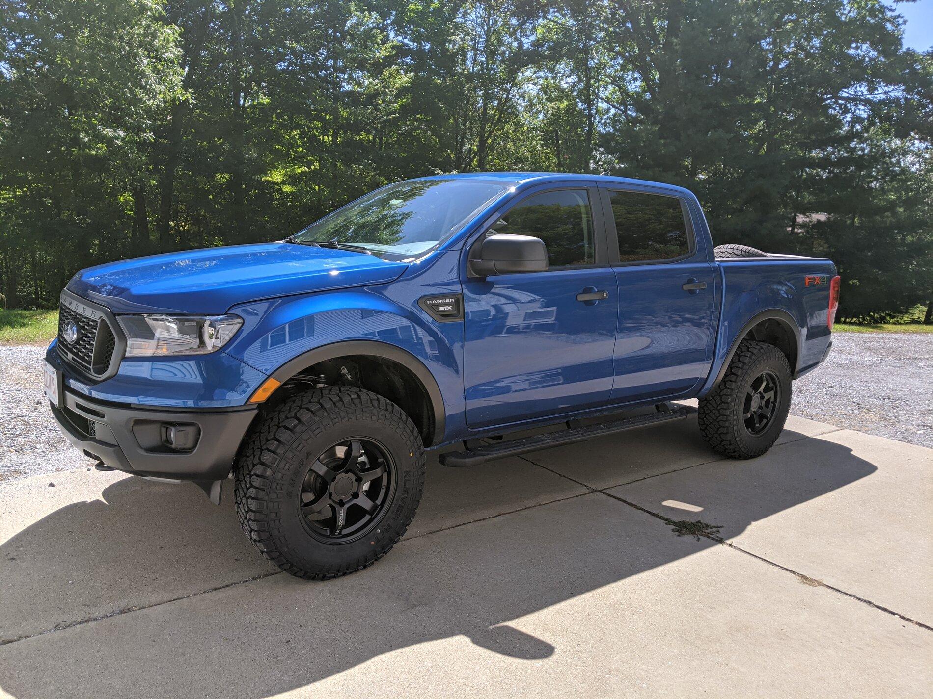

These tires were getting some love over on the Tacoma forums so I decided to try them for myself. I was really hoping I wouldn't have to remove the crash bars but that didn't pan out. I rubbed on the front crash bars a bit. Rear is very close but not hitting so they are in place for now.
Motegi mr150 17x8.5 +18
Bilstein 5100 2nd to last notch ~2,
Kenda Klever R/T 33x10.5
I don't have many miles on them but they were quiet on the way home and rode nice.

I've had really good experience with Kenda in the past, so I'm excited to see this.
quiet and comfortable ride is the last thing I'd expect from an aggressive RT tire, so that's a good start!

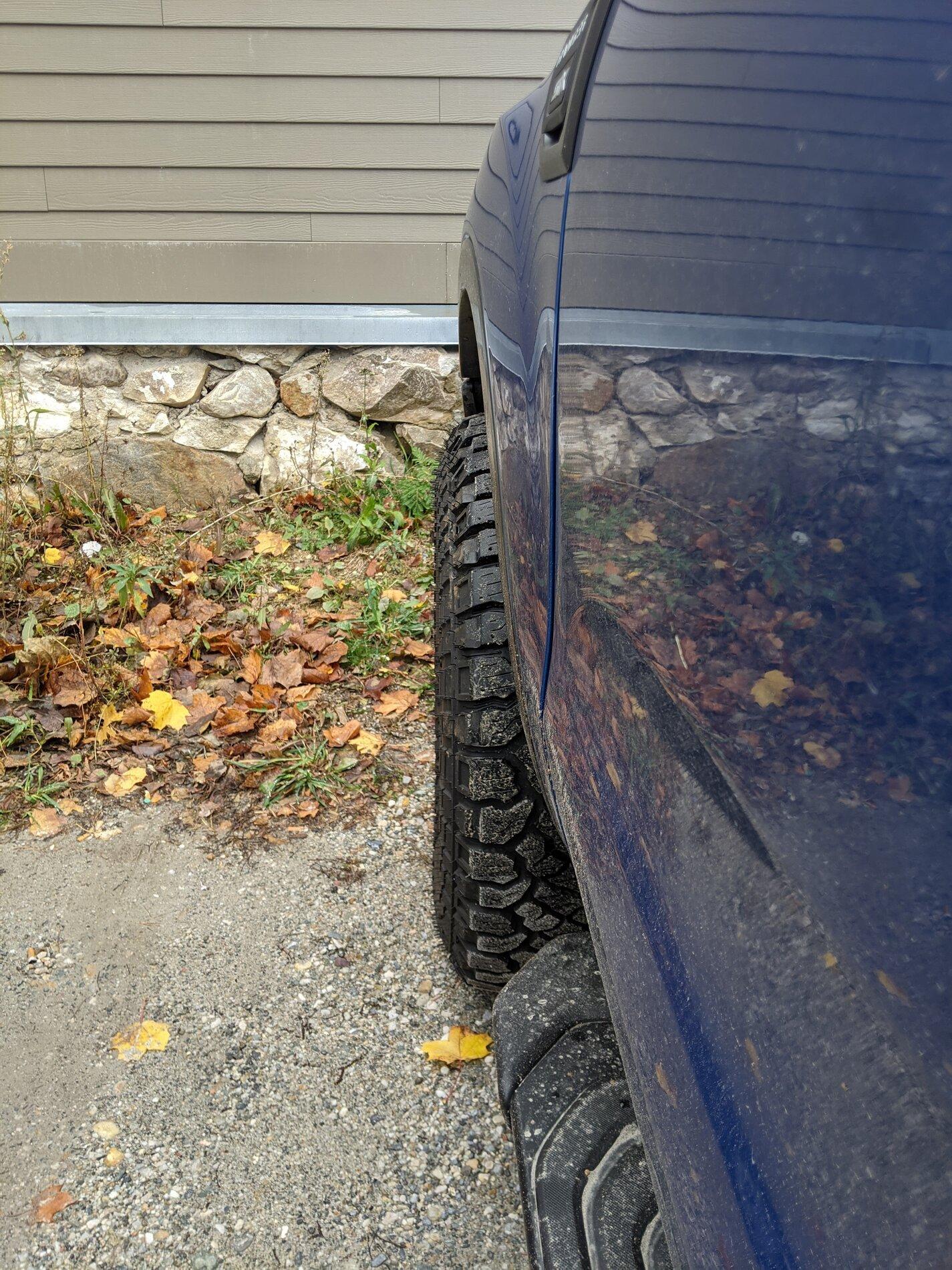

I am looking at these same wheels for my ranger. How much poke do you have with the +18 offset? Any more pictures? I was looking to purchase the 17x8.5 with 0 offset but I do not want too much poke. Thanks.
I would say I'm about 2 inches past the fenders. I personally wouldn't want any more. I was hoping to not need flares.

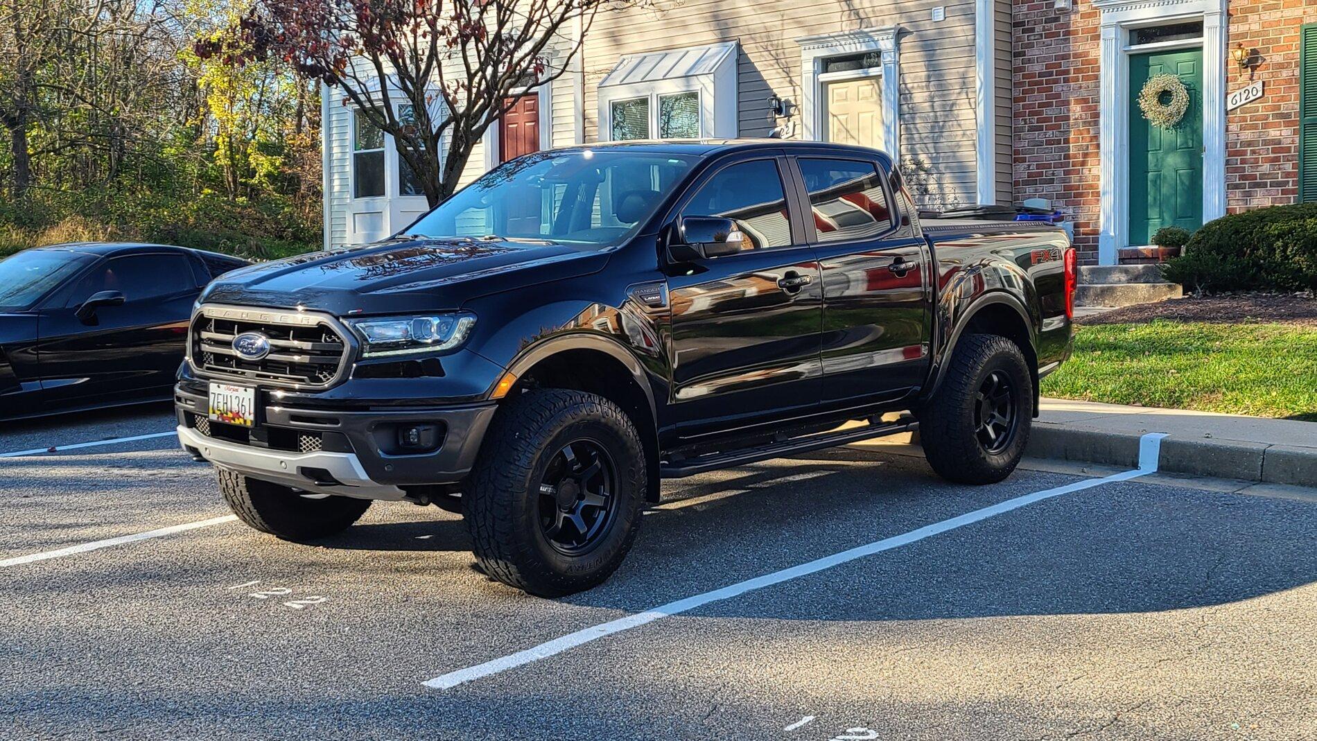

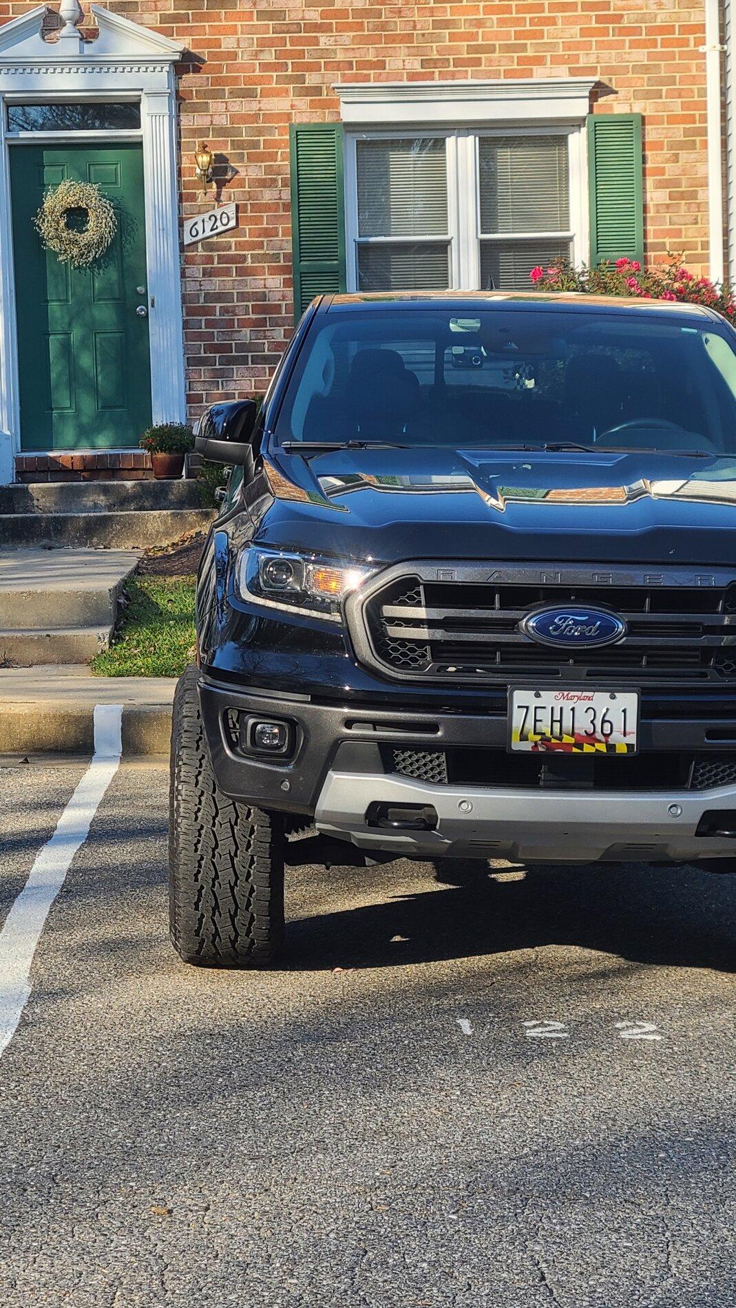

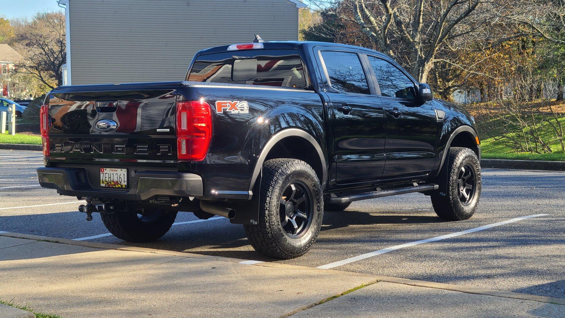

Thanks for getting back to me. I ultimately went with the 17x8.5 with 0 offset wrapped in Toyo Open country AT2 285/70r17.
I have mud flaps to protect the body and installed the BDS intrusion beams for added clearance.

Nice looking truck man! How are you liking the tires so far?

Like the look! I have same color and I'm thinking on get a set of them. Could you please share more picture from other sides? I want to see how it looks like the +18 on the rear and more side pictures.
