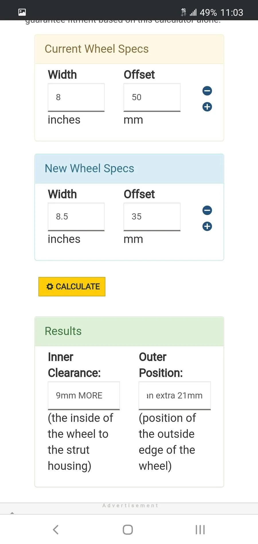

So you'll move the tire a few mm closer to the suspension, which will require a small spacer to clear the control arm on a 285-70-17 tire. 5mm spacer is required for the factory 17x8 et50 with a 285 so add the 9mm back and you'll need at least least 15mm spacer now.
Tire will poke out 21mm more on the new wheels which would be fine, except you have to add the spacer width so that'll bring you out to "at least" 35mm or so.

A 275 should work, a 285 you will rub. I barely rubbed on my previous setup and according to the tire calculations you'd be poking 14mm further out which results in rub at full lock on the crash bars. The only reason 285 would rub is because the need of a spacer.

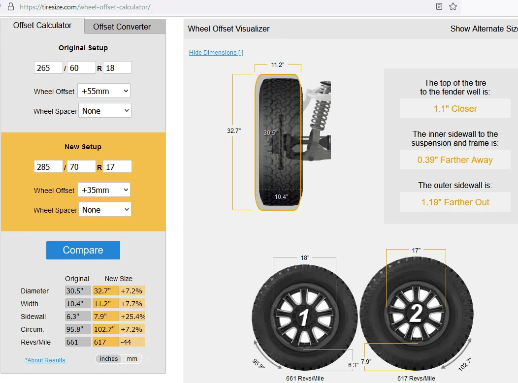

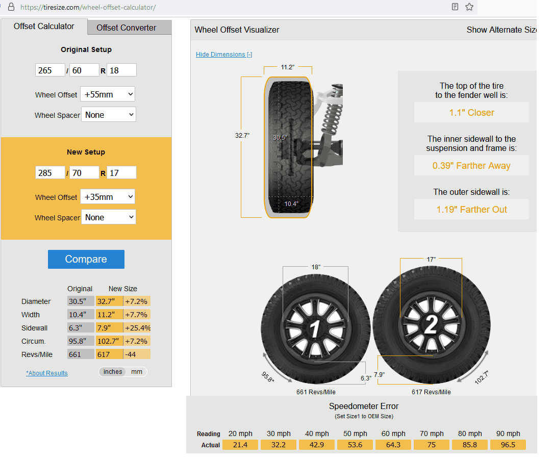

Not sure I totally follow. Stock is +55 so going to +35 is gain of 20mm clearance. Minus 1/4" from wheel width (say 6mm). I net 14mm of space from the spindle. You think the actual tire will hit the uca?
That image is perfect. From 265/60-18 to 285/70-17 the inner side wall will move 10 mm farther out from the suspension, and the outter sidewall will move 30mm farther out. I'm on 285/70-17 with +35 offset.

Here's all the numbers for the 265/60-18 to 285/70-17 swap.
Man, that fitment is perfect to me. Thanks for the info, this is really helpful. Also is that a Warn Ascent bumper? Looking good man ?
