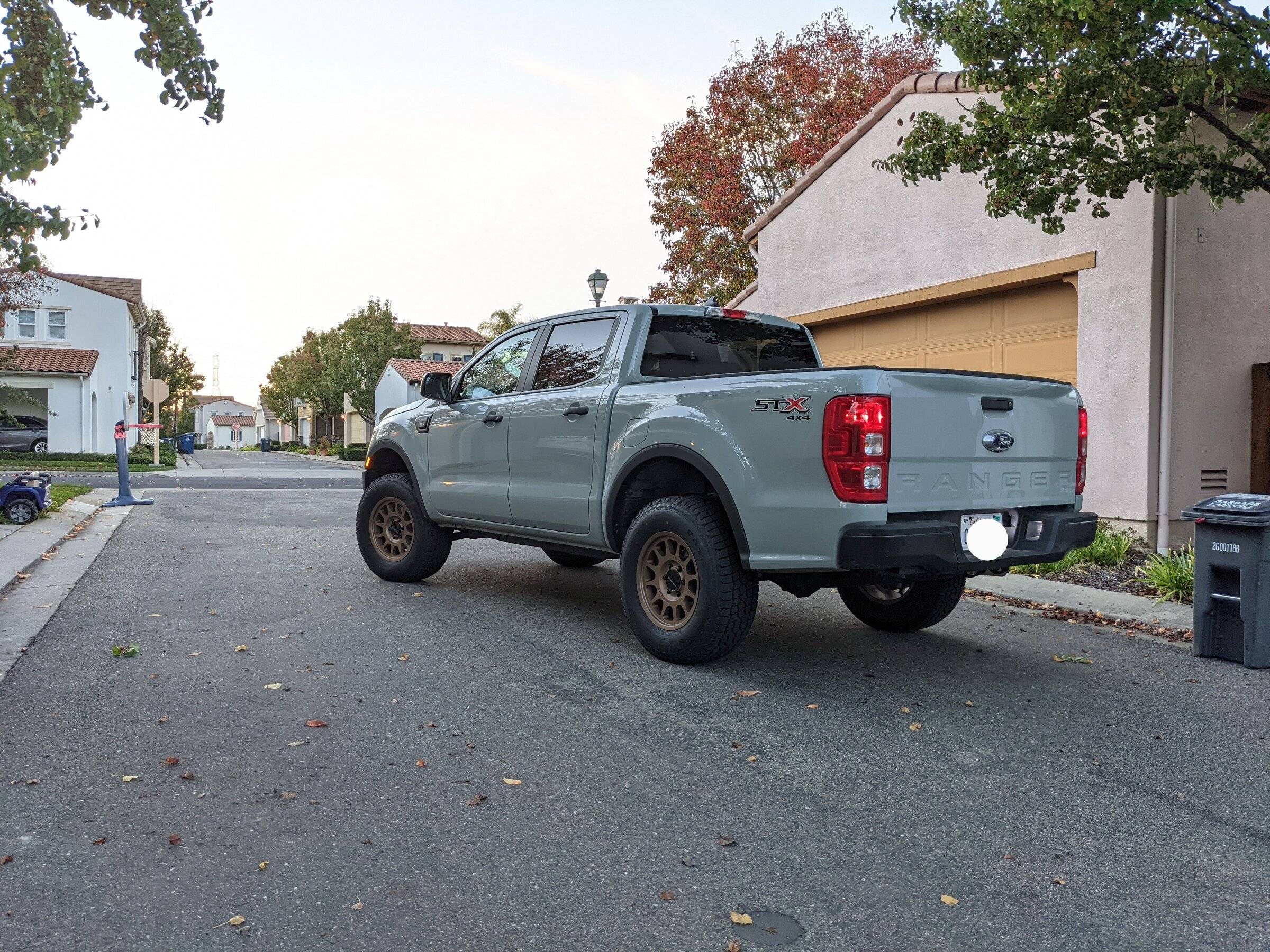

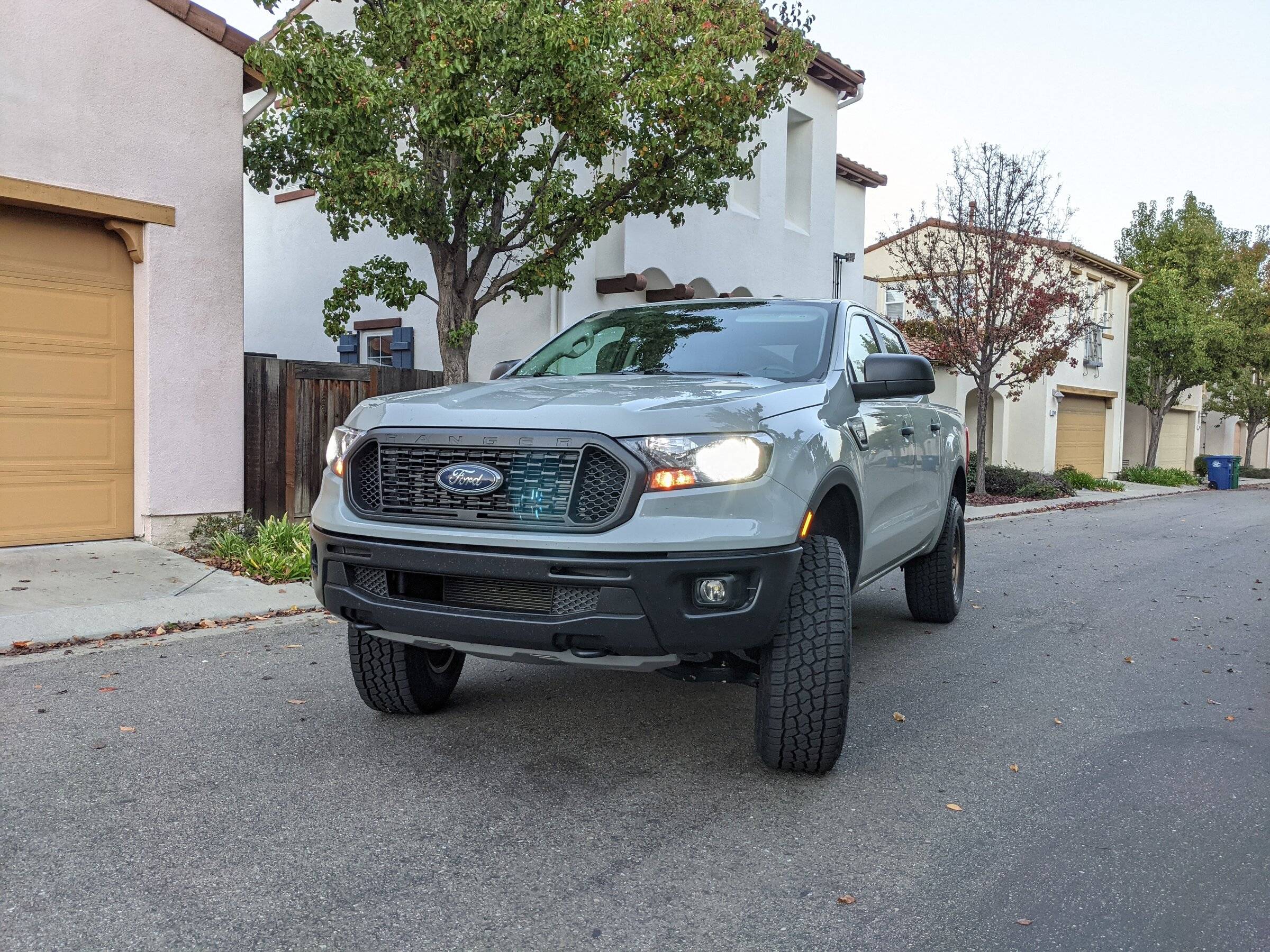

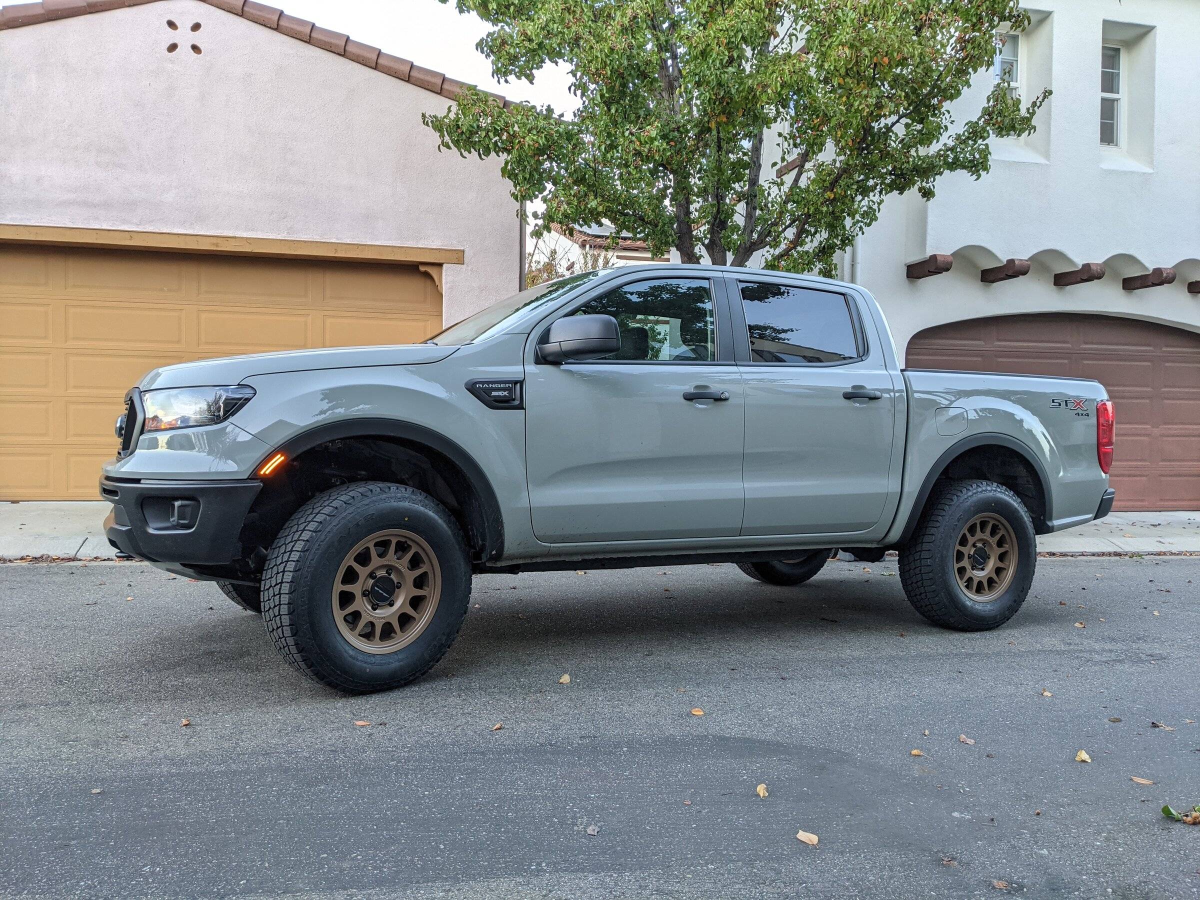

As an update, I finally got my wheels and tires. Went with Method 703, 17x8.5 +35 with 275 70R17 milestar Patagonia atr. I will post pics soon. But this clears all the crash bars for me. I have a 2" lift via Fox suspension. 285 would have hit the front bars for sure
Photos or it didn't happen ;)
