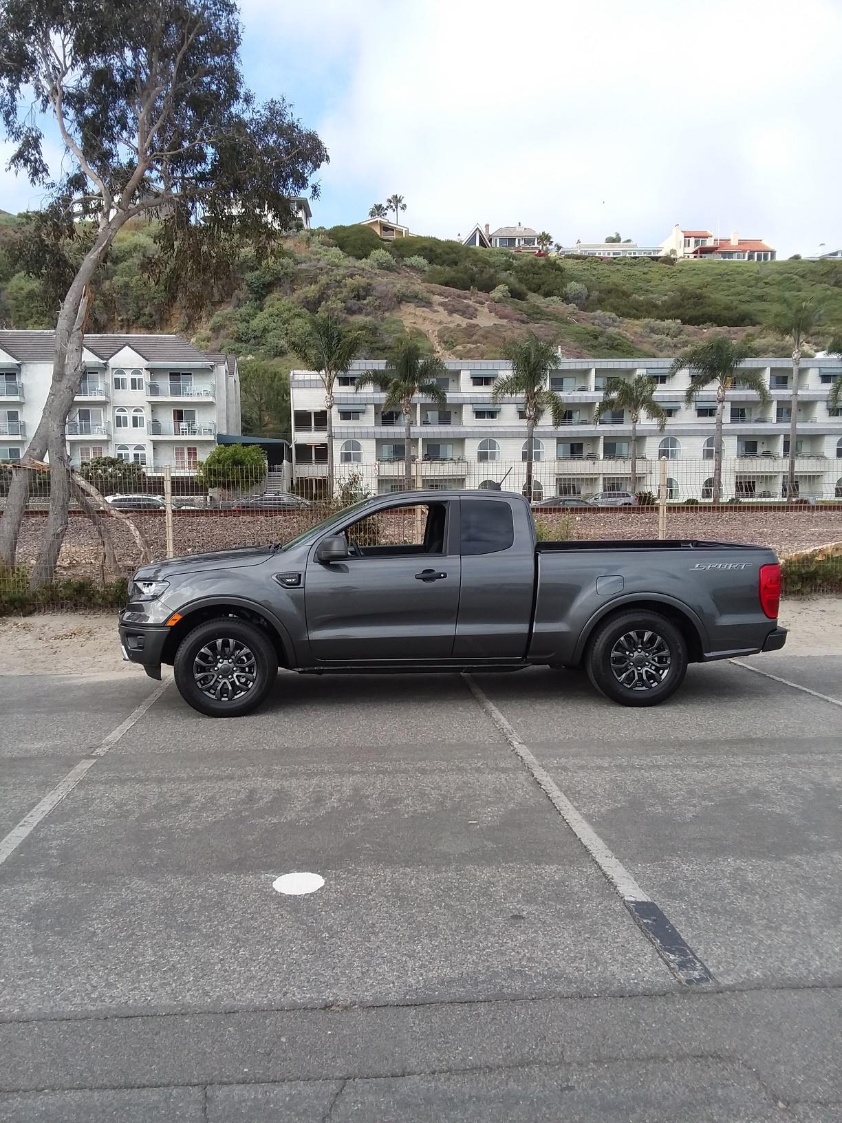

Liking it. Is the surface irregular or is it the angle but the back looks lower than the front.

Got tired of waiting for a kit
Nice! Hoping mine looks like that in a week or so!
What was your solution? Looks a lot like an axle flip, maybe longer shackles afterwards? Shocks?

I'll agree -- nose high, or maybe a touch too tail low. Should not be to big a problem.
Where I do see a bigger issue is the rear axle appears to sit too far forward in the wheel well, might cause a problem with the drive shaft. Pretty common with flipping the axle.

Yes, The front is a tad high still. Working on that. Rear axle flip with shorter shocks. I cut the strut coils for now to see what happens. No issues yet. I will replace them when Belltech comes out with some lowering struts. It's not perfect yet, but a lot better than driving around ass high.

Thanks for pointing that out SOHK. I will look into the rear wheel location. I forgot all about that when fabricating.

With the flip done, how much space is left between the axle and the frame? Do you think towing or hauling will be compromised much at this height?

Damn good question. A lot of different things
It looks like you've done an excellent job to me!

Alan. It depends on how much weight you plan on towing or hauling (i'm not planing on much) I replaced the bumper stops with smaller ones so i still have at least 4" They make rear shackles now that will bring it back up an inch or so. Thanks Kevin. Still work in progress.

Ok sweet, straight axle flip for now.
I'm in for rear springs with more arch in them for a flip with less drop so I'm pleased to see yours.

Thank you, that’s still a decent amount of travel. Hopeful that once more owners lower, there might be those who build and fit airbags to assist with heavier payloads or towing scenarios.
