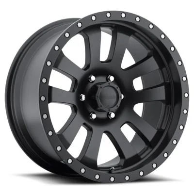

I have found these, which I think would look good. I know some really don't like the bead-loc look, but I do, especially with the bolt-on look fender flares.
Maybe one of the tire/wheel guys on here can give some insight into whether they will work without issue.
https://www.4wheelparts.com/p/pro-c...-satin-black-7036-788352/_/R-BKBQ-7036-788352
Pro Comp Series 7036, 17x8 Wheel with 6 on 5.5 Bolt Pattern - Satin Black - 7036-788352
  • Wheel Size: 17x8
  • Bolt Pattern: 6 on 5.5
  • Offset: 18
  • Backspacing: 5.25
  • Load Range: 2500
  • Center Bore: 108
  • Finish: Satin Black

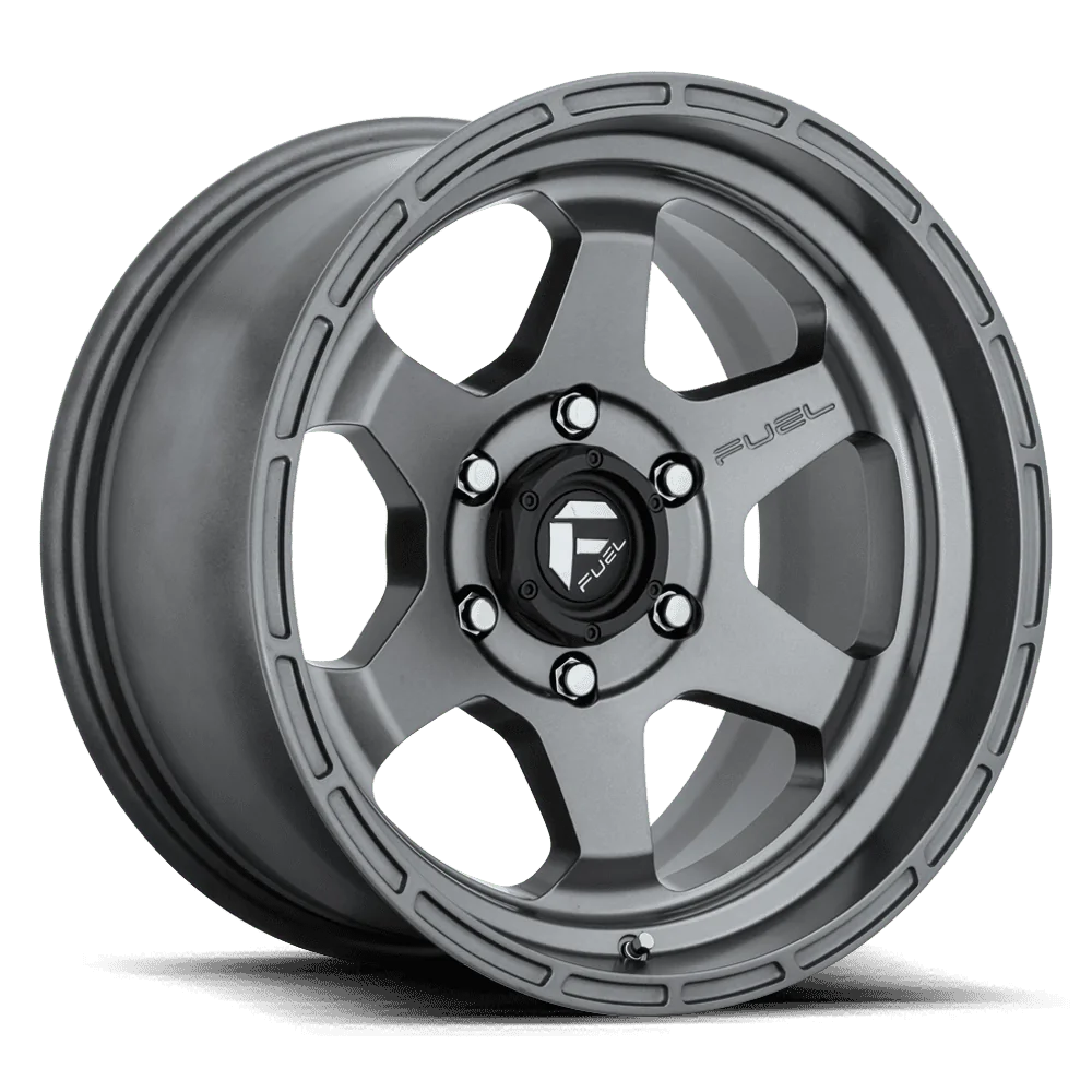

Fuel Shok, D665 17x9, -12mm offset:

I just ordered the Fuel Shoks from @PandaMotorworks . They have excellent pricing. Except I went with +20 offset. Those -12 offsets you have listed are going to stick way out there.

Offset is the question I'm not sure of. What is the standard wheel offsets? I was assuming zero so -12 would move them out 12mm.

On the offset. Stock is +55 and a few people on here have gone to 0 with minor trimming. I don't want my wheels to stick out that far so I'm trying out the +20. By my math, they should fit no problem but I'll know once I get them in the mail. Compared to the stock wheels, which have a back space of ~6.67", the new wheels have less backspace at 5.75" so that gives me an extra .9" to work with. The new tires I'm getting are 11.5" wide vs the stock 10.4" so that adds back .55" to the inner side so I should still be ahead by roughly a quarter of an inch on spindle clearance.

Well, these are discontinued, so I’m gonna reset my sights on a set of Fuel Vapors with 35mm offset. The calculator says they should fit, especially once I replace the Rough Country Level kit with the 3ā€ SST lift from ReadyLift (on backorder now)
