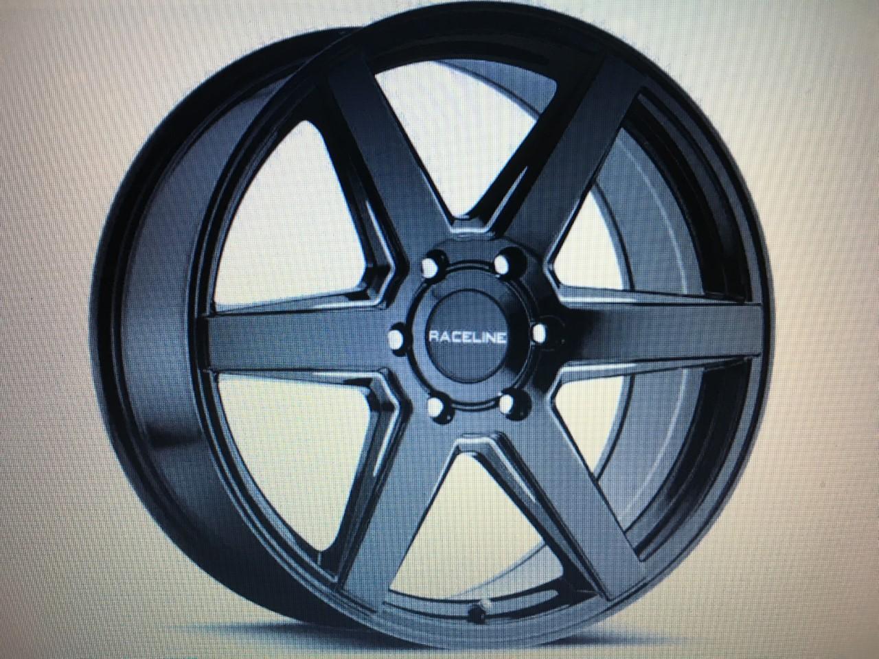

I like my wheels simple. Now to find them with all the correct measurements....:facepalm:

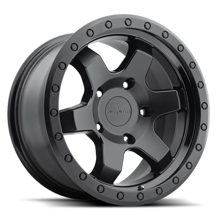

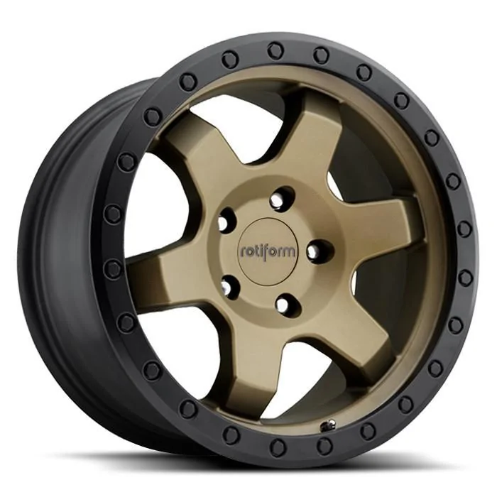

We are working on adding a lot of options to our site. We are dealers for Fuel Fifteen52 Rotiform and many more.
Few options are posted below.

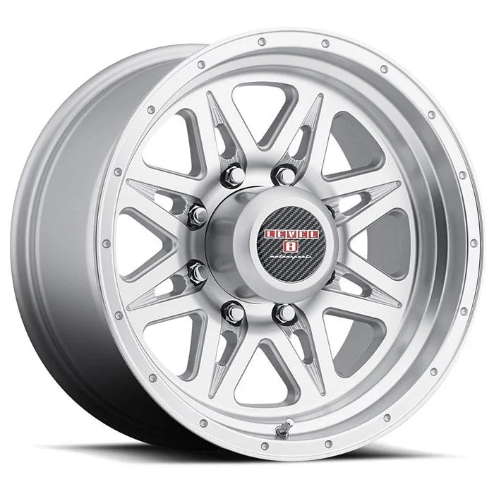

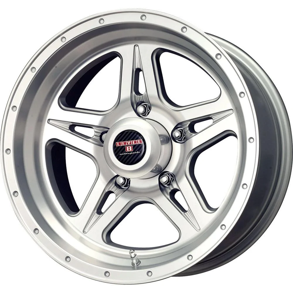

I prefer small rim with bigger tire, but I have come to love these "low cost" Level 8 rims. Strike-8 for bigger diameter, Strike-5 for smaller diameter. I usually run 16's. They also come in black w/ polished edge, but the all silver are a clean look and work well with many body colors.

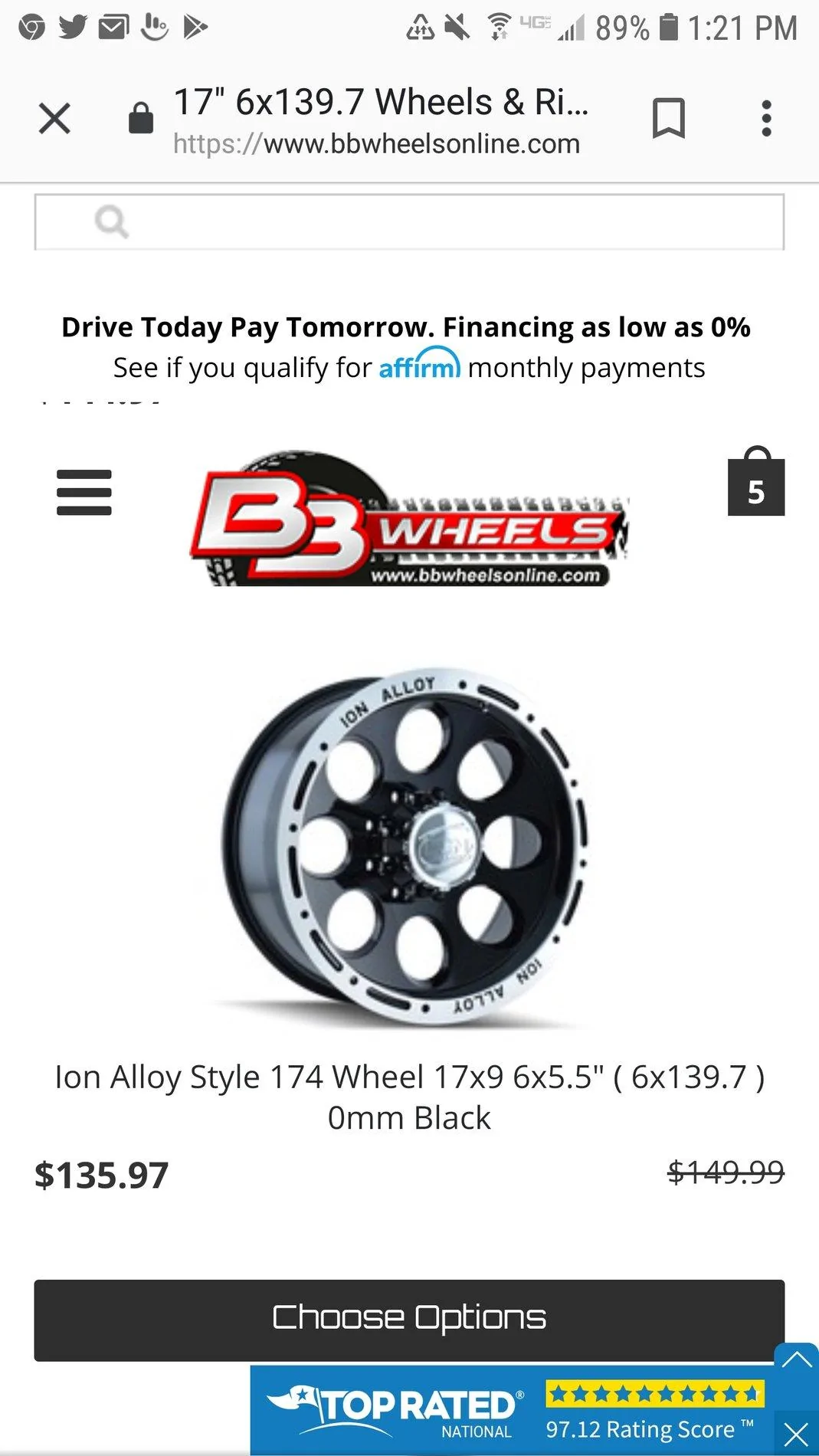

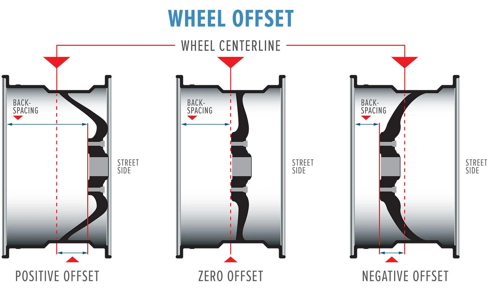

Hey gang I have a question? I can't find many 17x8s but this Ion Alloys 17x9 with 0 offset has caught my eye. Now with a 2.5in leveling kit and 265 70 r17 tires will this work or should go for bit more negative offset?
Just remeber with offset, the more outward the wheel is the more it swings, which is typically not something good. The closer to zero you can get the better. Depending on how the steering geometry is, sometimes a bit of pos offset helps to bring the wheel closer to pivot (less swing).

Anyone that has messed with fitment so far. Do we know if a +20 offset would work with 285 70-17 bfg’s? I really don’t like the roller skate look of 0 offset so I’m thinking +20 might be the ticket.
I'm curious for this as well. My family owns some tire shops, If I can find time when they're not too busy maybe they can check it out and see what will work and what won't.
