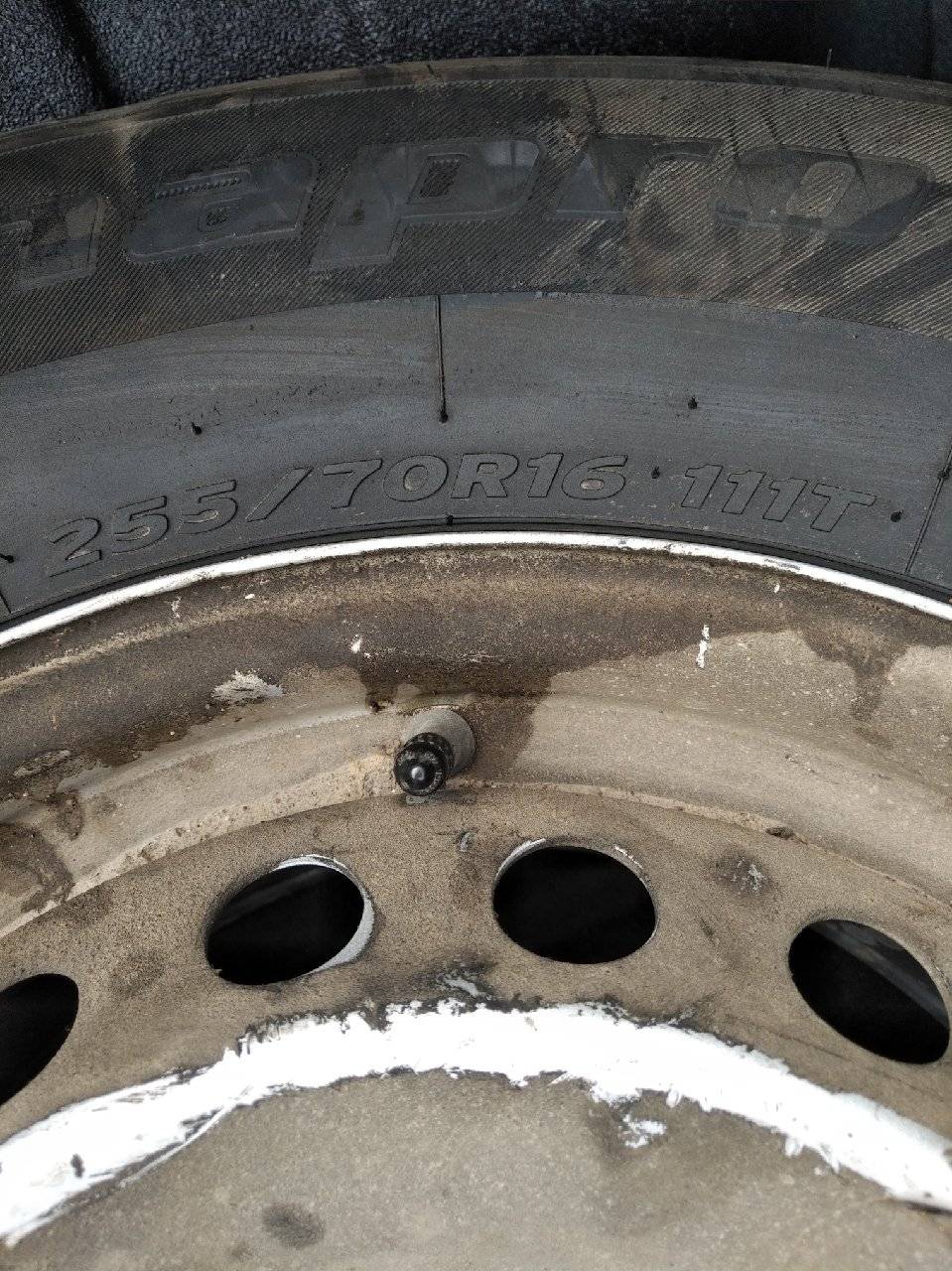

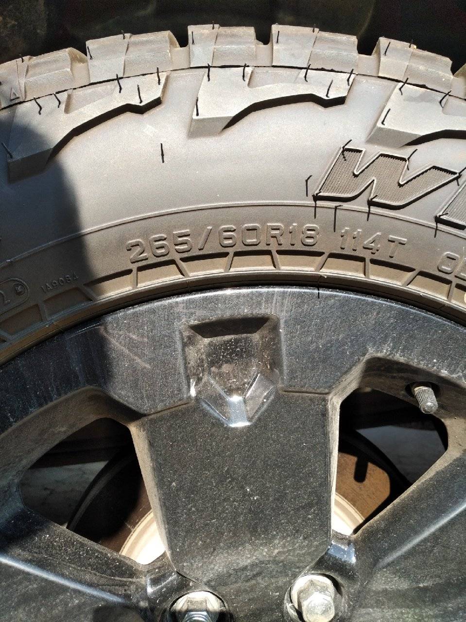

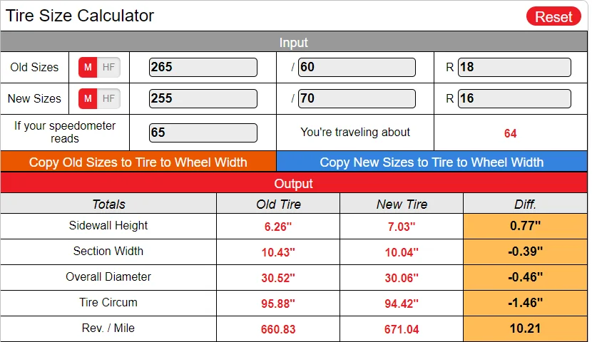

@RayO thank you for that information, as you can see by the Calculator, the overall diameter is virtually the same although the load index is slightly less on the spare tire. You could still roll confidently with the spare installed.
