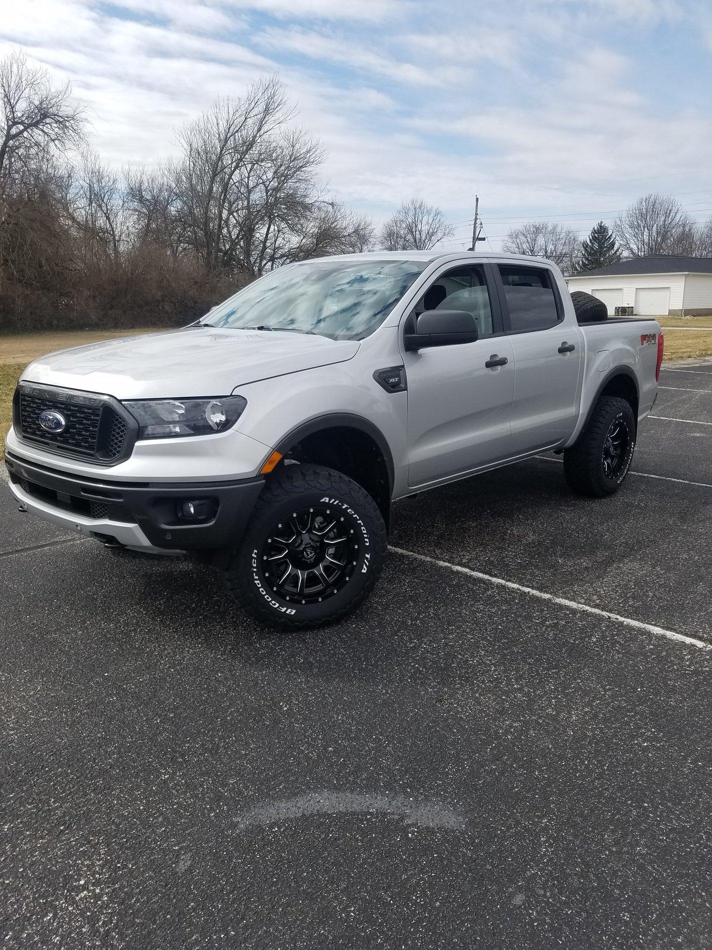

The start of change for my Ranger 17x9 Fuel Vandals with +1 offset on 265 70 r17 BFG Allterranins. Just waiting on the 2.5in leveling kit I am getting from Rough Country.
I'm curious to see how they look with white walls out.

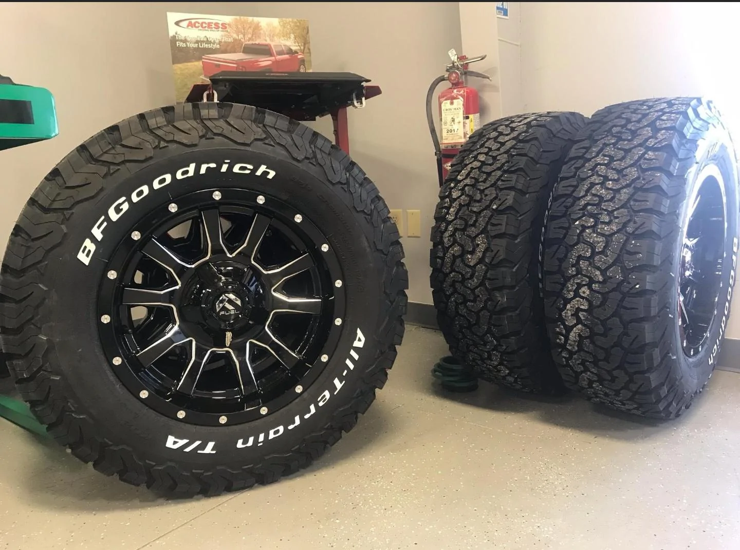

who is looking for some fuel wheels?
we want to give some deals so we can get media of wheels on these trucks.

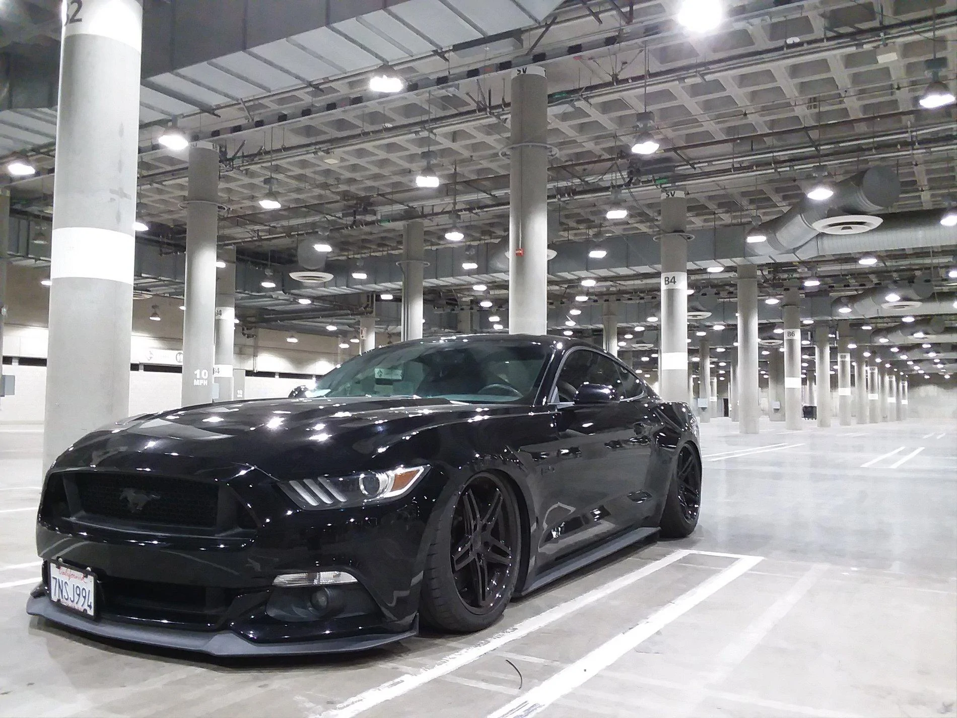

I could be, I like the fuel anza, the look similar to what I have on my mustang
