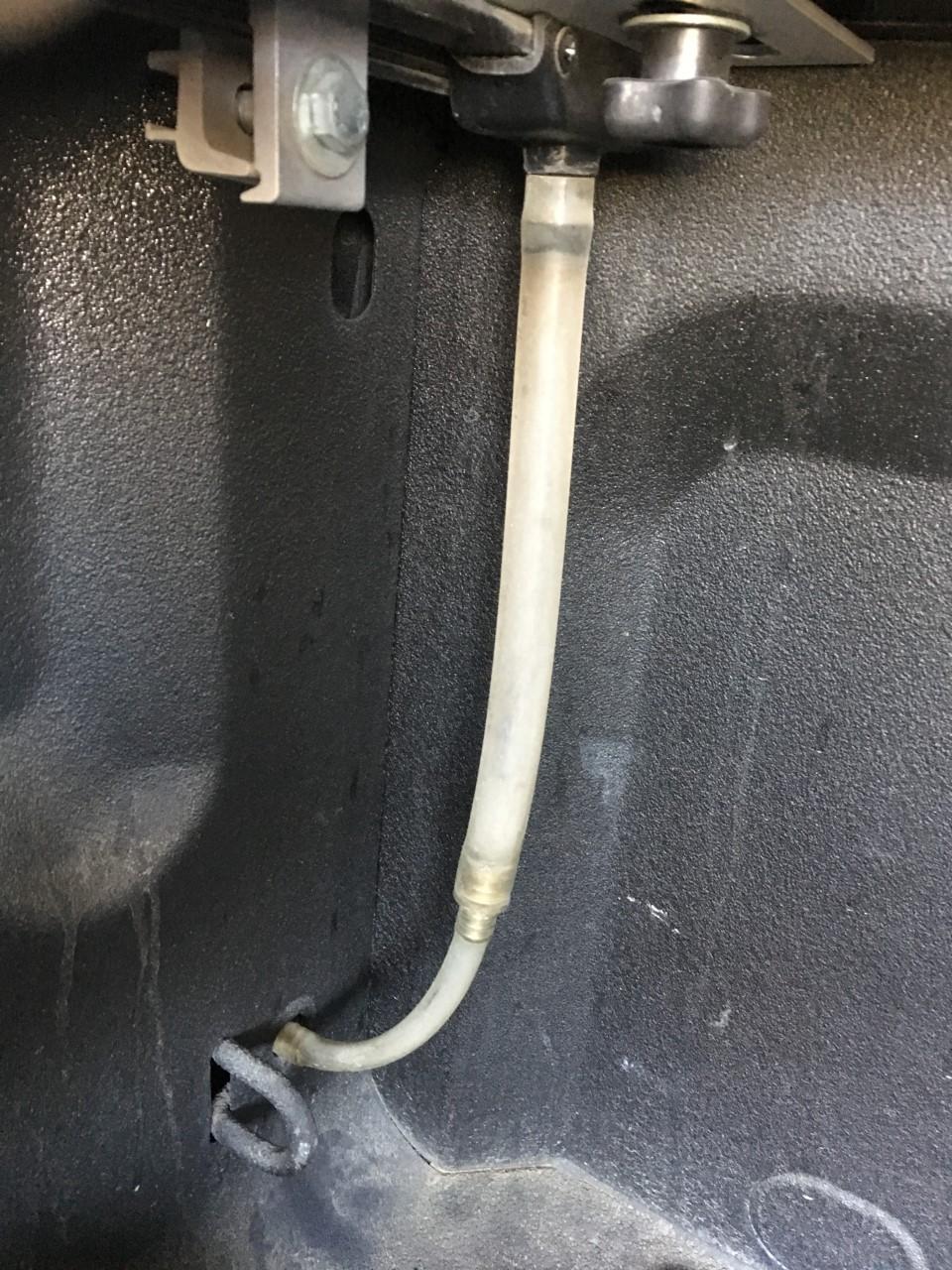

I have a Bak G2 on my 2013 Ram, which I transfered from my 2010 Ram. The large drain tube that came with it was a pain until I bought a foot of small clear tubing. Then I took some brass barbed fittings, and attached them so the size decreased down to a decent size, cut an "x" in the rubber grommet, and stuck the last barbed fitting through. No issues for 8+ years. I'll be doing the same for my Ranger......when it gets here......someday.
