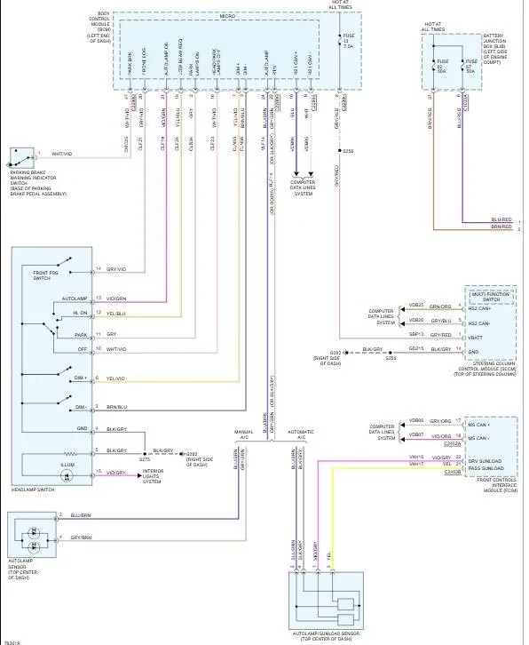

Let's look at the Headlamp Switch
In (OFF) no power from the circuits can reach (Ground)
in (Auto) the BCM can supply automatically (each circuit) capability to reach Ground
Note the (Fuses) in the RH Corner, those fuses are on the (output) supply of the Headlamp Switch circuit. (Auto-Mode) is driven by the (Sun load) sensor inputs (Bottom Right)
So, in (AUTO) the BCM has control of the lighting circuit and what circuit has a ground all dependent on (Day / Night) and Can Data (Input) of Gear Position for DRL Control.
Then tie in the (Assessory) Relay that can shut-off power to the (Switch) The 10-Minute Relay when it sees (Engine-Off) and the lights are still on.
This is precisely the Point of Power input where the BCM is powering the Headlights (ON) before the (Run/Start) Relay closes and sends power out of Fuse #19.
In (Auto) the power is being supplied before that relay closes, thus (Hiding) or (Blocking) the start-up sequence from happening.
My theory is - to take that (Tapped) power and move it to when (Auto) position closes the relay here in this diagram the (Timing) will equal out as (Auto) not only provides the Ground Path for Headlights but also Park lights.
Note: There is NOT a dedicated DRL position in the Switch, this is all done behind the scenes from Can Bus (Data) and (Sun load Sensor) resistance feedback to the BCM and this only occurs with this switch in (Auto) unless you set it to Canada settings that will adjust the settings to occur in (All Switch Positions) except (Headlamp)
Its specifically this control (Gear Position) input to the BCM that changes and powers the DRL output to (ON) when the gear is moved out of park.
The problem is - I am looking for a way to get that (Power Output) for DRL to include Park and not create issues for all other modules that rely on that specific data transmission, such as (Rear Camera) needing to see (Reverse) before it switches the Video Feed (ON) as an example.
That input (Gear Position) for when its sending data - I am out of park - Enable the DRL circuit is what I am trying to locate a work around for - Let it enable, even in park.
As that is the PRESISE circuit that is triggering the Start-Up sequence.
So, I am thinking that is not an option I am going to find, I am taking a different route and switching the power (input) to trigger the (Start-Up) sequence instead and since the BCM is winning the race for power, why not try and see if we can use that (win) and tap into the source that is providing the initial power supply.
This way power is coming in at the same time

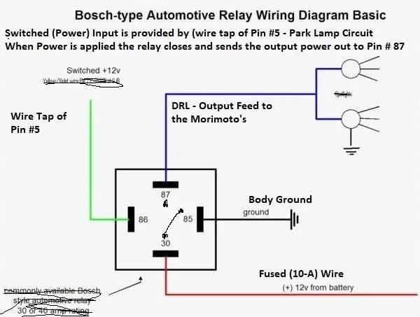

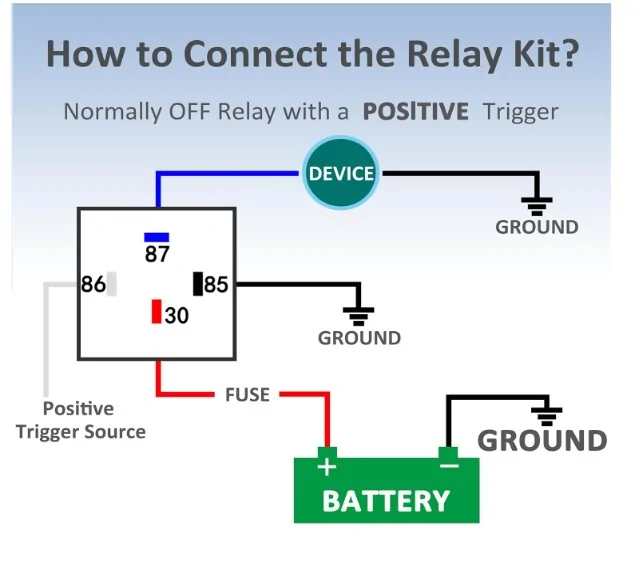

A better explanation:
Currently - You have Fuse #19 that is providing switched power (via the Run/Start) relay
Fuse #19 power relies on the (Run/Start) Relay to be closed before power becomes available.
During a Start-Event - you have multiple relays that are being cycled and the BCM power is also being cycled and the various Can-Bus data transmissions occurring.
The BCM - Internal control is faster (By Milliseconds) in getting power out to the Headlights and at the same time (Includes) Park Lights
If we take that (BCM) control of (Power Output) and (Wire Tap) the power from the Park Light circuit (This is Pin #5) power and use it for a (Input) source for a relay (shown below)
Then anytime power is applied to Pin #5 will create a current flow across the Relay Coil.
This being Pin #86 flowing to Ground Pin #85
You will have (Constant) Battery Tapped Power at Pin #30 awaiting a path to flow to ground.
When power is flowing (From Pin #86 to Pin #85) across the relay coil this creates a magnetic field - thus pulling the (Relay-Contact) point over and allowing power to flow from the battery.
Pin #30 to Pin #87 and out to the (DRL Harness) - This being the required signal (Power) input to command the (Start- Up) sequence
So, my theory is if we time the power input to be equal vs mismatched, will provide a better operation of the Start-Up Sequence.
Bear in mind that the DRL Power will only be applied when the Park Lamp circuit is powered.
In (Daylight) the Park Lamps will not be powered until (You come out of Park) and with (the Forscan Setting - Include Park Lights) as DRL's then the Park-Lights will trigger power on (as DRL's) this providing the necessary power to trigger the (Start-Up) sequence.
So, NOTE this is not going to occur just by starting the engine via KEY as it does currently.
In Remote Start - The Park-Lamp Circuit is Powered - So a normal Start-Up Sequence with the Transmision in (Park)
In (Night/Dark) - the Park Lights will be commanded on along with the Headlights, this is the choke point of the (Timing)
and hopefully by moving the (power input - relay controlled) via the Park Lights will cure the issue of the (Strat-Up) sequence.
So, when the Park Lights are triggered (ON) the (HOPEFULL) outcome will be that the Start-Up sequence will start and end its process before the Headlights are commanded on by the BCM. I truly suspect that this will happen.

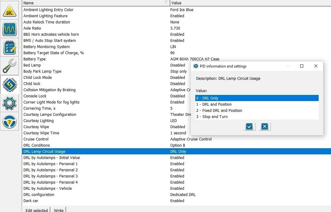

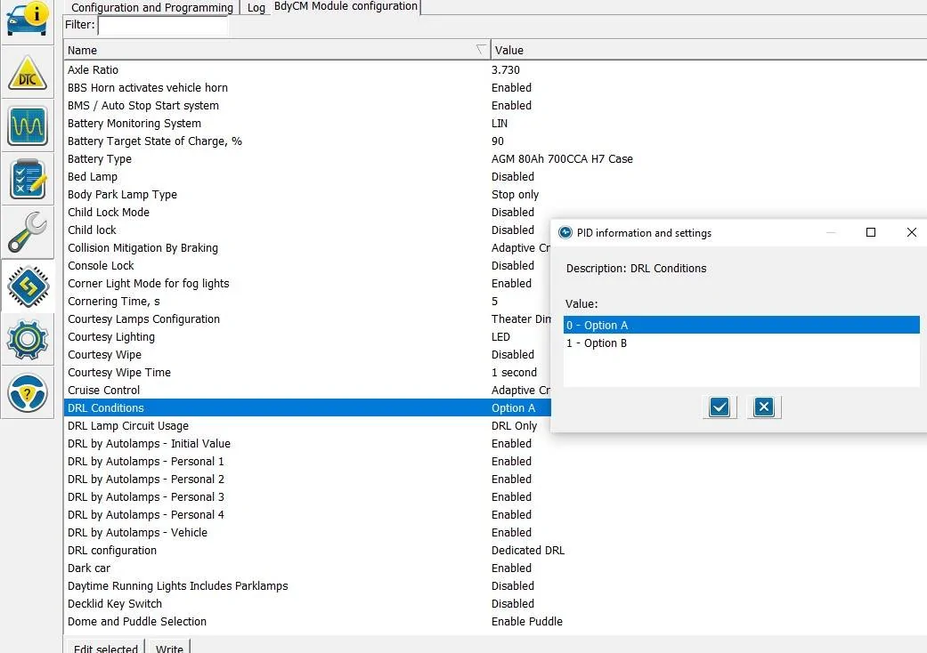

This issue is not just on the Ranger it's across all Makes and Models to some degree and it's all tied to the term (PLUG AND PLAY) which is not always the case in the real world when the Vehicle System control takes over, this being the BCM.
At least with a (FORD) and (FORSCAN) we have the ability to Re-Program the BCM functionality.
You have to give a huge amount of credit to FORD to allow it, as they could easily lock it up and the only way to access it would be by a (Licensed Ford Software) that would make doing any changes whatsoever very expensive.
I am truly amazed on how cheap (Forscan) is, yes it sucks for using it as a (Live Data) T-Shoot tool but as a Code Reader (Great) and as a (Programming - Through Port) its priceless
This software for its price is remarkable for what it can do.
So, I use Forscan solely for the (Programming) feature and my Scan Tools for T-Shooting

Hope this diagram helps in understanding of how to (Wire Tap) the power off of the park Lamp circuit as a (Relay) control for the (DRL-Output) feed.

Basically, the bottom line is this - at this point for the Morimoto's and that Start-Up Sequence
It is programmed to (ONLY) trigger with a DRL (Input) pulse.
If that was (NOT) a requirement then you could simply (wire Tap) Pin #6 on the Harness and get it wired the same as (Factory LED's) are that have Pin #6 in the Headlight Side of the connection.
Make the (changes) in Forscan and you are good to go, and you have a (cheaper) option of LED assembly's vs the Factory LED's with an added special function of the (Sequential Turns)
Which I like (that function BTW)
But that (Requirement) for the Start-Up Sequence to function, it takes DRL Power (which is Pin#6) to Trigger it (Into Action)
Now if I can find a way - via BCM programming for that (Power on Pin #6) to come on (Other Than) (Day & Out of Park) then it would be a simple wiretap Pin #6 & Forscan change.

Ok, I played with various settings - (Forscan) & My Factory LED Headlights
I was able to get power output on Pin #6 without the truck requiring it to be in a normal configuration (Auto) & (Out of Park) - Daytime
#1 - DRL Conditions, this setting has been promoted to be if (Canada) set this to Option (B)
and this perception comes from the owner's manual & service manual (verbiage) on operation
A=Configurable (USA) -B=Conventional (Other Countries)
A=DRL active in (Auto) - B=Active in all switch positions
The PROBLEM with Option (B) and I played with multiple other settings to resolve the issue and that is (With the truck-OFF) the DRL's stay lit Bright.
I even tried using the (Current-Canada) settings to disable the (DRL-Auto) from my above post.
But I found that if I use the (IPC-Menu) they could turn off
NOTE: I did not wait for it, but I think that this would time out after (10-Minutes) this would tie in some of the operational issues with the (Timing) of the Start=Up Sequence as this was showing me the (DRL Circuit) has power
I want to also note that - with 5 different Canada (As-Built) compares, all Canadian trucks have this set the same as the (USA) - Option (A),
But these are my results of my operational tests with it set to (Option B) so for now changing this is not advisable.
726-26-01 - xxxx-xxxx-x1xx
0=Option (A) Switch in (Auto) 1=Option (B) Any switch position
Daylight:
DRL Bright: (Park) & all switch positions (Off in Off)
DRL Bright: (N) & all switch positions (Off in Off)
IPC (Menu) allows you to turn them (OFF)
Nighttime:
DRL DIM (Park) & all switch positions (Off in Off)
DRL DIM (N) & all switch positions (Off in Off)
IPC (Menu) do not allow you to turn them off
Easy Menu:
So, this setting is a (BUST) for what I am looking for, due to (1) still dim at (Nighttime) & the Power issue with the truck off. Leave this as - Option (A)
So, I was curious on how the truck would operate by (setting) the As-Builts just like the Canada Trucks.
Here are those results:
The Lights operate the exact same as the (USA) Version, the only exception is they take away any and all user (Control) for the DRL Lighting setting in the IPC Menu
So, this is also a (BUST) for what I am looking for.
Then I tried this (Setting) and various configurations with all the other DRL Options, adding Park Lights and Fogs etc.
DRL- Only: is what the factory is set at, and this will only put power on Pin#6 when in DRL (Mode) so Daylight and Auto and (Out of Park)
DRL and Position: Provided the Results Below
Daylight:
DRL OFF: (Park and Switch-Auto)
DRL Bright: (Park and Switch Headlamp & Park) (Off in Off)
Nighttime:
DRL Bright: (Park) and all switch positions (Off in Off)
I wanted to confirm via Meter - What circuit was actually powered when I was visually seeing (BRIGHT) DRL's
I confirmed that anytime the DRL is BRIGHT - Pin #6 is providing the Power
I went a step further with this and (ADDED) Include Park Lamps (DRL's) and found that with that setting - it will also supply power on Pin #5 as well as Pin #6 when it is in DRL Mode (Daytime) and (Nighttime) as they are commanded on with the Headlights.
I played with some other settings (outside) of the easy menus for (Fixed) Bright & (Fixed) Dim percentages to see if it was possible to (Lower) the brightness of the DRL - This was a (BUST)
at least with the current setting (DRL & Position)
I have found that it is confusing somewhat - when they use (Park & Position) nomenclature in various settings as they can be adjusting the same lighting source.
Example: Include (Park Lamps) as DRL's - well this incorporates both the Rear Tail Park (Position) lamps as well as the Front Side Marker (Position) and the Headlamp (Park & Position) Light.
Then you get to this setting as (Park) is not in the settings (Only Position)
But anyway - I have found what I was looking for and that was a way to (Power) Pin #6 in more configurations than the Factory Setting.
Note: The Door Ajar & Door Lock circuit - triggers the DRL Lighting in (BRIGHT)
I have determined that this setting allows (DRL) Power when its normally only (Park Lamp) power and it (Combines) the 2 circuits together as far as Power Output, so basically then same thing I was thinking with the addition of a relay, except this can be achieved via the (BCM-Programming) - COOL
Fixed DRL & Position - Setting provided the exact same results and I did not try the Stop & Turn for this test.

"From the testing I have done with my OLM lights, and the Morimoto's may vary. The startup sequence is triggered by the power coming on from the tapped source. This power also completely powers the startup sequence through completion and powers the DRLs on (bright)."
With Factory LED - You Have (Pin#6) on the Headlight Side of the connector
Pin#6 = DRL Power
Note: For a Halogen to Factory LED swap - It requires Forscan to get the BCM to open Pin#6 as a power source to truly get the full proper operation of the DRL Light output.
Due to the FACT that the Halogens are wired the same way as the Morimoto's. No Pin#6.
With the Morimoto's not having Pin#6, they had 2 options.
A. Force the buyer to use Forscan and alter how the power is applied, the same as you are required for the Halogen to Factory LED swap. (Using an incorporated Pin #6)
B. Use a Tapped source for power to supplement the Power from Pin #6 and remove Pin #6
The Morimoto's use Option (B)
Issues with Option (B)
You have taken away the (BCM-Control) of the power output of Pin #6
The requirement of Tapped Pin #6 - Power to trigger the (Start-Up) sequence plays havoc with the (Start-Up) sequence trigger when the Headlights are commended on by the BCM.
This is something that was (OVERLOOKED) when they tested the lights on a bench and not thinking about the BCM wanting to power up the headlights as well at (Night)
So, a secondary power source attempting to do the same thing, Power up the Headlights.
So, the (Start-Up) sequence is either Blocked or Hidden when this Double Power Source is applied.
The MAIN reason I am pushing for a (Wiretap) of Pin #6 is it will allow the BCM to take full control of the Power Output of Pin#6
1. The Lights would operate the exact same as the Factory LED's (IF) that (Start-Up) sequence was not a factor.
2. So, I was attempting to find a way with using (Wiretapped) power from Pin#6 to obtain the same lighting operation but better results (Timing) for the (Start-Up) sequence
This proves challenging and this challenge only relates to the (Start-Up) sequence as all other lighting will operate normally and that challenge is how to program the BCM to operate the DRL Power (Output of Pin #6) to get the Morimoto's to command the (Start-Up) sequence every time the truck is started. The same (Intention) that Morimoto had when they designed the lights.
With the BCM and Factory LED settings - The only time Pin #6 Powers is when it's in (DRL Mode)
So, this means that the Morimoto's (Wiretapped to Pin #6) would only power the DRL & the (Start-Up) sequence - Day - (Auto) & (Out of Gear)
This is why I was looking for ways to get (DRL Power- Pin #6) to be produced by the BCM outside of those settings.
Which I was able to accomplish - partially and some possible draw backs
So, it's not a WIN, but it is possible solution to cure the (Start-Up) sequence functionality at (Night) but in order to get that function you have lost the (Day) start up sequence until you come out of gear.
So, it flips the issue to Day vs Night - Well that's a partial win, as now the BCM will hopefully allow the Start-Up sequence at (Night) since it's in full control of the lighting.
In (Day) the (Start-Up) will function normally, it just will not trigger until you meet the (BCM) control of the DRL Lighting in (Auto) and/or you physically move the Headlight switch out of (Auto) position.
And then add in that with the (above) BCM setting change, this also powers up pin #6 when the door ajar / door lock circuit is triggered,
Depending on how the Morimoto's react to that scenario, this setting may also trigger that start-up sequence as well.
More than likely - IT WILL
so that creates another - Work Around
And that is set up Police Mode, which I have, and this adds an IPC Menu (Selectable) option to turn (OFF) all exterior lighting feedback when the truck if (OFF)
1. So, a fix for the (Unwanted) - (Start-Up) sequence trigger, but you have lost all exterior lighting feedback (Lights Flashing) for (Entry-Exit) & (Door Lock/Unlock)
This can easily be set (On or Off) in the IPC Menu
Note: I forgot to test this out - when I had the BCM (Setting) changed to:
DRL and Position to ensure its operation was the same (No Lighting-Feedback)
So, all the Fused Tapped Power from Fuse #19 is doing is replacing the power output from the BCM for DRL Power (Pin #6)
1. The Morimoto's make this power (Full-Time) and that full time power when in (Dark) to be used to also trigger a (Start-Up) sequence when the BCM is also trying to do the same (Issue)
2. I was thinking that by swapping that (Tapped) source to (Wiretapped) then it would let the (Start-Up) sequence be better controlled which if (CONFIRMED) it is a (Timing Issue) then yes this would cure the (Start-Up) sequence issue.
3. The Challange is - Getting the BCM to produce power output on Pin #6, when you want it there.
No matter how you have it set up -to get Power on Pin #6 or Fuse Tapped Power to Pin #6 wiring circuit on the Morimoto's, they appear that they will never fully function properly as they were intended -due to how the (Start-Up) sequence is triggered.
They need opened up - or a closer inspection of the wire harness and determine which wire (Internally) coming off of that (Tapped-Power) feeds over to the (Relay) that triggers the Start-Up sequence.
Thats all the (Start-Up) sequence needs to see - (A Power Source) being applied to that relay to get it to trigger.
The Morimoto's use (Pin #6)
That needs (MOVED) to Pin #2 - Let Pin #2 (Low Beam) power be the trigger vs Pin #6 and all the issues are resolved.
That is (IF) it is wired the way I think it is.
If I had a Morimoto on a bench in front of me, I could easily test this out and move that power input requirement.
I have the necessary tool to do this easily: My Power Probe, I can hit any circuit with it and power the circuit without the need for jumper wires.
The only drawback of moving this is: The Start-Up sequence will only trigger when the Low Beams are commanded (ON) which for me would be a better operational function vs having it trigger with the DRL circuit which is not really a drawback.
The (Unknown) will moving the trigger over - still allow the (Start-Up) sequence or will it still command them on and skip the sequence.
It all depends on how they have it wired (Internally) as an option is to by-pass the relay all together and have it so when power comes in on Pin #2, it goes directly to the module that is producing the sequence (Phased-Sequence)
Basically, get this to work in a real-world environment and take it a step further than the Morimoto engineers did - fix their oversite. But in order to perform this easily the light needs to be on a bench and tested before its installed.
If I had one in front of me, I could correct this issue and rewire that input, since that is not the case then I have to attempt to find alternate solutions for this to work properly, and those alienate solutions come with only (Partially) working the way it was intended, and it also induces (Unwanted) triggers.
So, the only true way to fix that (Start-Up) sequence is to rewire the light assembly and internal trigger (Input) for it.
1. This VOIDS the Warranty
2. You have to Remove the Light Assemblies
So, you are stuck in a (LOOP) and will never have full proper operation of the Start-Up sequence
until we can determine how its wired internally and see if that trigger wire can be accessed from outside the light assembly and done (On-Vehicle) and can this be done without wire damage (Cutting) and can this be done with a simple (Re-Pinning) of a connector and how easily can the internal wiring be accessed - The Module Mounting & Wire Grommet -How much access will it allow with the lights installed?
Basically, I need to know where the (Tapped) DRL feeds to: What Relay?
That Relay is what is receiving the (Start-Up) command sequence
Remove that input to the relay and wire the Low Beam (Pin #2) instead to replace that input trigger.
or
Wire Pin #2 directly to the (Start-Up) sequence control module that the other side of the relay is going to.
Because all that relay is doing (Internally) is using the (Tapped) Power source to apply power to the Headlight circuit via that relay and when that relay closes (Internally) the headlight is using the (Tapped) power source to apply power to the (Start-Up) module which then is programmed to use the (Tapped) power source to cycle power across the Headlight Circuits, and it appears that it cycles both (Low & High Beam) circuits using that (Tapped) power.
If the BCM is already applying power to the circuit (In-Dark) then the (Start-Up) sequence is either HIDDEN or BLOCKED from occurring as there is already power on the circuit.
So, if we actually rewire the Headlight to pick up the trigger to command the (Start-Up) module action, then I suspect it MAY allow the sequence to complete (First)
That would be the only way to truly fix the issue, The BCM will still see power output and not throw any codes, the only thing is the Headlight (Output) will be delayed until the Start-Up sequence completes.
Again, this will VOID the Warranty and Requires Possible cutting of wires - IDK it all depends on how easy or hard the Morimoto's wire harness make it.

OK, sitting here and reading @airline tech last few posts I came to a new conclusion. The Morimoto and my OLMs are working exactly as designed. The light startup sequence was never intended to happen when the headlights were powered on. The fact that we get one at all when we start the truck with with the switch in Auto and the truck in dark mode, IS the glitch. It is due to the trucks BCM timing of turning the two (left and right) headlight circuits. One side (I believe the left) is just enough slower to occasionally trip the startup sequence and locks out the headlight until completed. This doesn't happen any other time this is the only time the headlights are commanded on during startup.
If people don't use the Auto switch position, everything works fine. The sequence will have plenty of time to complete before the headlights are turned on. Or, if the person turns on the headlights before starting they have plenty of time to block the sequence.
As far as making Forscan changes to make them work like the OEM LED lights, not going to happen. That would require firmware edits to the BCM software to control the lights differently, again not going to happen.
The second thought of rewiring the inputs to the headlights also will not solve this issue especially using the headlight power. You would never get a startup sequence as power to that circuit is what blocks the sequence. Any other feed will also likely give undesirable results ( trying to do a startup sequence at undesirable times. And good luck getting a set of lights to play without coughing up $1500 for a set. I'm pretty sure Morimoto has no intrest in this issue. especially since the 5G rangers are out of production and any solution would require major changes and costs.
So the choices are.
1: live with the random sequences when starting in Auto/dark mode.
2: Do as I have currently and disconnect the tapped power, leave the DRLs checked in the IPC menu. Use Forscan to move Your DRLs to something other than low beams and include your parking lights with the DRLs. This will eliminate the startup sequence completely as well as having the DRL bars on Bright during the daytime. They will work similar to Canada except they will only be one when out of park and the will be one in Dim because the parking/tail lights will be on.

Make the Forscan changes I have highlighted and Wie-Tap pin #6, this comes with drawbacks though, Opposite the disconnect of the DRL Harness, the DRL will be forced to always Bight and if you do not want the (Door Lock - Door Ajar) feedback to trigger the startup sequence then you will also have to add the (Police/Dark Car) mode and have it enabled as well.
So, we have found a few options for the Morimoto's, and it depends on what do you want to gain or lose. What option serves yours needs best?
one other option would be - Locate the wire that feeds the startup module and simply De-Pin it.
Wire-Tap Pin#6 power and set up Forscan as if these were Lariat LED assemblies
Make any changes you want - (+ Park Lights or +Foglight's) and they will function normally just without the fancy startup sequence. The DRL (Bright) will power just like the Factory LEDs operate.
