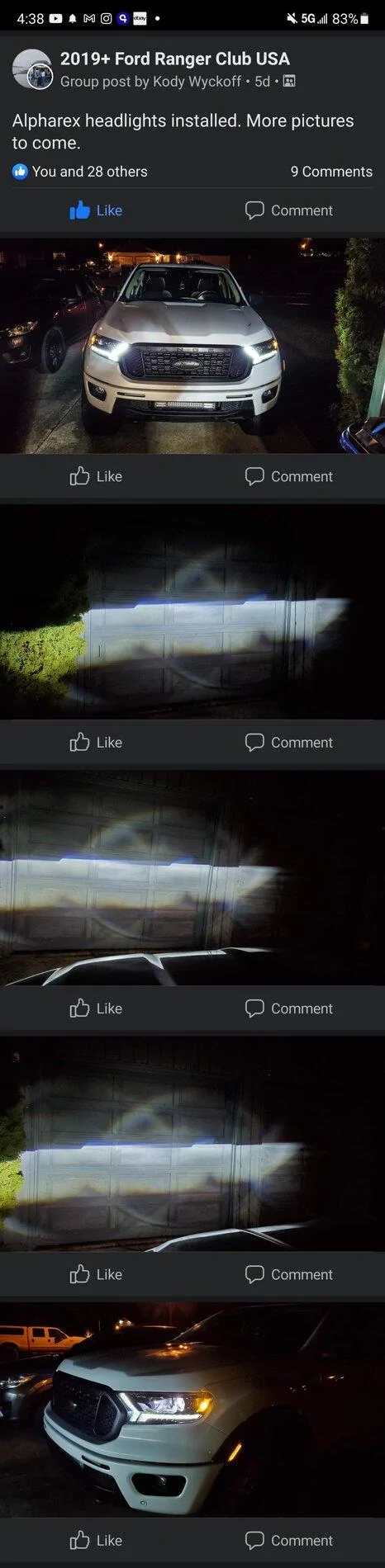

Here are the picture I have that I could not link to. Not my truck but this is the pro lights with leds installed.
What led's did you use and can you give a picture of it on the road please?

As I
Alpharex Nova. Beautiful.
I would say the same thing to you as I've said to others LOL. We already know what it's going to look like on the truck. Give us all a favor and show us what it looks like on the road please!

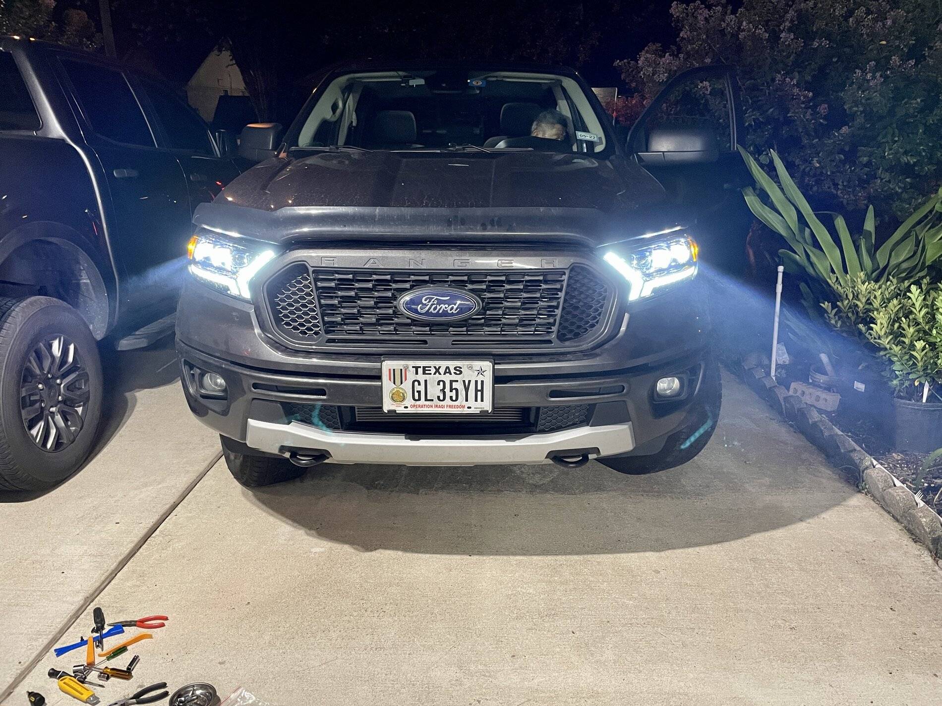

I am in the process of upgrading my wife's 2017 REFLECTOR lights to a 3 LED PROJECTOR light from CHINA. SInce her FORD RANGER XLS truck is a 2017 THAILAND RHD I ordered lights to fit 2015-2020 and I knew I would have to do direct wiring with MY PLUGS as her truck does NOT have the newer FORD PLUGS. Do these lights fit, YES, there are 2 HIGH BEAM and 1 LOW BEAM LED PROJECTORS plus 'built-in' DRL and 'FLOWING' TURN SIGNAL.
The DRL and TURN plug only has 3 WIRES, 1 for DRL, 1 for TURN and GROUND. it also came with that FORD HEADLIGHT CONNECTOR with only 5-6 wires. I am looking online for the PINOUTS of this plug and that was very easy to find when targeting a 2019 FORD RANGER. I haven't finished removing the PLUGS and wiring MY PLUGS in place of those but I am CLOSE to completion. These lights ALSO have a HEADLIGHT ADJUSTMENT MOTOR which is also a 3 PIN on each LIGHT but I will add that CONTROL, maybe LATER. The MANUAL SCREWS are there so I will initially use them.
There are MANY, MANY CHINESE projector lights replacements 'out there'. These are BUILT really well and are very BRIGHT. The original WIRING uses standard 2 PIN, BULB SPECIFIC plugs for LOW, HIGH, TURN. and I had added DRL and 'FLOWING' TURN to an OUTSIDE 'add-on' frame about 1 year ago (still works) but won't need them with these NEW LED ASSEMBLIES. In the LAST almost 3 years, I have purchased MANY CHINESE LED LIGHTS (because NO USA company will ship them to Thailand) and only had 1 DOA LED TRIM STRIP. Hope that helps!
