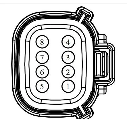

Ref: Headlight Connector
Using this as a guide - match up the OE Harness connector to the (Motto) Connector and from the (Moto) connector do these (Continuity) checks
Since I cannot see where they are tapping that (Tapped Source) we can find it by:
In (Ohms) scale: (Meter)
Pos Lead: To the Tapped (Extra) single wire from the back side of the LH Headlight
Neg: Lead: To each of the 8 Wires in the connector (assuming they matched OE) wiring.
and note which wire gives you continuity (Should be Pin #6) buy may also be (Pin #2) either only one of them or both.
Also - On this connector check for continuity between (Pins 2 & 8) and (Pins 6 & 4)
This will show the results that you should see on the RH Light assembly, so repeat the same for the RH light assembly and note any different (continuity) readings
These tests will confirm if you have a bad light assembly (or more specific) not wired correctly internally. I am more concerned about (Pin #6 to the Tapped Pigtail) that is hanging out of the back of the headlight assemblies (if the LH side has continuity and the RH side does not) then it's not wired correctly (internally) and this is why the Start-Up sequence will not work (Auto-Dark)
