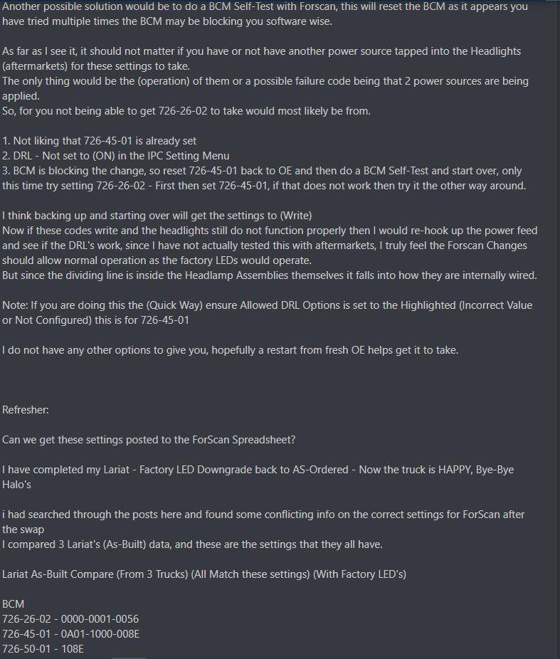

I agree - and now see, that if the (Morimoto's) already have power (Low Beams) triggered on by the (Low Light) conditions then the headlight (Sequence) cannot be initiated.
Its looking for (Initial) power up.
So, what I need to know is - Will the (Truck) let the start-up sequence happen, without starting the truck by just simply turning on the headlights, or is the (Switched) power source (REQUIRED)
Since, the focus has been on the (DRL) circuit tap, I am trying to isolate down how the headlight triggers the (Start-Up) sequence.
I am thinking that there is a (Internal) relay (Coil Side) that is powered by the (Tapped) source, momentary pulse to the (Headlight) side - The programming for that (Start-Up) begins with (OFF) then (Sequence-ON) Light 1-2-3, then if it sees power (Dark-Low Beams-ON) via switch they remain (ON) if (Daylight) and they do not see power on (Low Beams) the Start-Up sequence triggers the lights (OFF)
So, for the (Start-Up) sequence issue - it's the issue of the programming of the (Low Beam) needing to be (OFF) to begin the sequence.
I am working on (As-Built) programming to see if there is a way to get the start-up sequence to function (always) without the Headlamp switch needing to be (OFF)

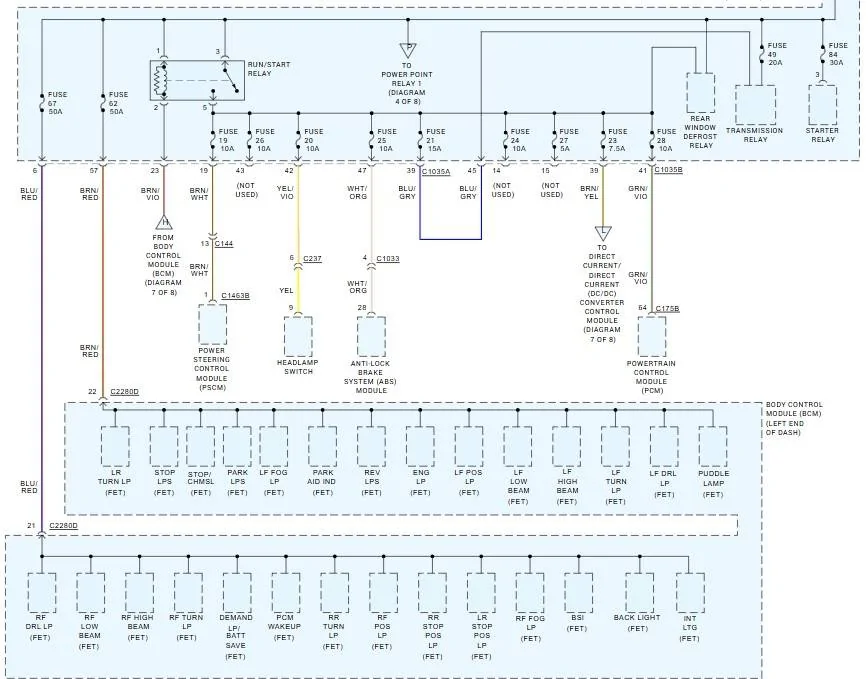

Here is the Run-Start Relay, it closes after the PCM Power Relay - Closes
So, this is showing (Switched Power) Note: Fuse 19 is here
But also note (Fuse 20) in this diagram it shows a fuse (Fuse 20) feeding the Headlamp Switch
This is (INCORRECT) in fact fuse 20 is (not used) and it is (not installed)
Further (Pin #6) of C237 is empty and (Pin #9) of the Headlamp Switch is empty.
So, it was mentioned above (race conditions) you have a tapped power source on (Fuse #19) switched power, that will always power up at (engine start) or (accessory mode)

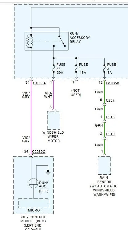

Fuse #3 - Rain Sensor - This is powered by the (Run -Accy Relay)

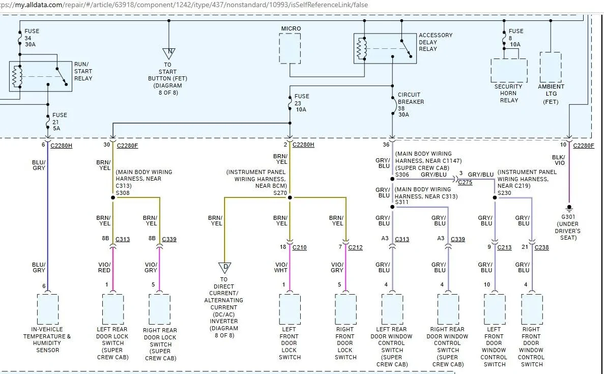

Fuse #23 - DC/AC Invertor & All Door Lock Switches - This is powered from (Accy Delay Relay)
Fuse #4 - Customer Access (For the Trailer Brake) wiring Drivers Footwell)
Fuse 6-7 - 3-Leg Fuse (Not Used)
So noted - that in order for (Accy Relay) to be powered it requires (Ign Key Power)
Note: The (Micro) feeding the (Ground) to the coil side of the (Assy Delay Relay)
This comes from (Ign Switch) Input or known as (ISP-R) Ign Switch Position Run

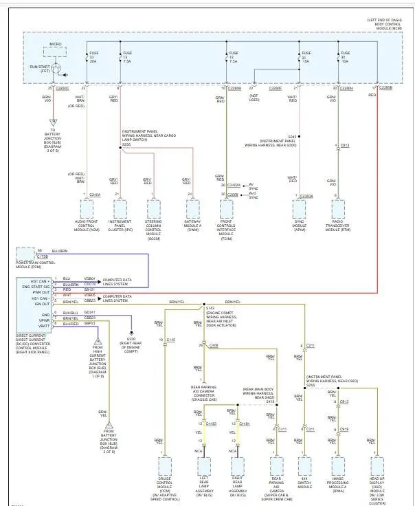

The Visual factors in (Remote Start) - What's not Powered
Can be mostly seen here:
The (Power Out) Leg is active with a caveat, power is (AVAILABLE) but the (ISP-R) is missing from the HS1 Can Bus, so the modules will not be commanded to power up until it sees (ISP-R) data.
The (Ignition Out) is not as you can visually see the (4WD) selector switch is dead, this also requires (ISP-R) data to provide power (output)
NOTE: The HS1 - Can Bus (Data Line) on the DC/DC Convertor
Also Note: That the (Micro) Relay in the diagram -This is the (Micro) that Grounds the coil side of the Run/Start Relay (That Feeds - Fuse #19)

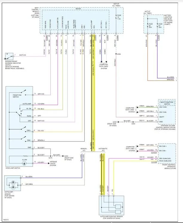

Headlamp Switch:
Since the wiring diagram is wrong about Fuse #20 feeding the Headlamp Switch the power is provided on all legs to the switch and switch position determines what circuit is grounded to complete the circuit.
I am guessing that this is a 5-Volt Circuit (for each position) and the BCM itself is providing the Power (No Fuses) - Power to the BCM is coming from the 125-Amp BCM Fuse.
So, if you visualize this as a (Relay) and the BCM is the Relay Coil, and the Headlamp Switch Position is providing the Ground for each separate circuit
Now we factor in the (Supply) side of the power, which is sent down another circuit to each light.
So, when the (Coil Side) control receives the ground from the switch, it allows power output to the lights.

So, you can see below that the (Autolamp) control is a (Micro-Relay) and if we are going down the correct path (in assuming) that the Low Beam circuit is being powered up before the (Start-Up) Sequence or (Left Headlight) completes the sequence and the (Right Headlight) does not, tells me that the issue is in (The Race - As Mentioned in a Previous Post)
Being that (1) The Left & Right (Lighting) Outputs are on 2 separate fuses.
So, with the Headlamp Switch Position (In-Auto) or any position (it does not matter)
That switch position will send power (down 2 circuit paths) one for the Left Headlamp and one for the Right Headlamp.
As far as (Circuit) Run - The Left Headlamp will have the shortest run and will power faster than the right. (Milliseconds Here)
But that (short) time, period plays into account when you factor in (Tapped Power) source.
The BCM is winning the RACE.
Even the (Tapped) power source - the closest headlight to (Fuse #19) is the Left Headlight.
Plus, you have to take into account that the (HS1) Can Bus, has to transmit the data of (Ign-Switch) Position ISP-R this is from the BCM and the internal Micro Controller.
You also have the (Accy Relay) that I have proven ties into the Headlights
So this may be why you get intermittent outcomes for the (Start-Up) sequence, sometimes the CAN BUS can be fast or slow (just like any computer data transfer)
With That Information and thinking about As-Built Data for the (Ambient Light) sensor
BCM: 726-26-01
Factory OE: - 0100-0003-0058 ---xxx1-xxxx-xxxx
0=Slow (15-Seconds)
1= Fast (2-Seconds)
This is the only setting I can find for (Timing) of the (Auto-Lamps) and it states Sensor Type, so unsure if this is a (part-number) thing as for (Auto Climate) Control this Ambient Light Sensor is also the (Sun load) Sensor so it has double duty.
With the (Manual) climate system - it only functions as the (Ambient Light Sensor)
So, I don't really see how this would affect a (Start-Up) sequence at engine start, as 15-seconds is a long time. I think this is more for (driving in daylight) and (driving into a tunnel) how long (time period) does it take for the sensor to react and trigger the headlamps on, vs 2 seconds of driving under a dark cloud (cloud shades) the sensor and triggers the headlights on (Briefly) and then back off.
So that leaves us with the True Unanswered Question:
What is the Actual Circuit that the Morimoto's use to Tap Power.
We are assuming (PIN #6) DRL Power, and what (INTERNALLY) is happening to (TRIGGER) the Start-Up Sequence.
As the BCM (is Applying power the Low Beam & Parking Light when it is dark enough for the headlights to be on.
So, the (Start-Up) sequence not working may be not only from the Low Beams already being on it can also be from the Park Lights already being commanded on.
So, the logic in the Morimoto's is that that the (Start-Up) sequence already happened.
I have more to follow, but I still think that removing the (Fused Tapped) source and moving it to (Wire-Tapped) source may cure the issue.
