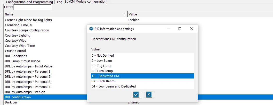

These are the settings for Factory LED swap from the Halo's, since my LEDs were deleted from the factory - I put it back to the way it should have been delivered as ordered with them installed.
I spent some time playing with these settings and they match the As-Built files for all Lariat Rangers with the Factory Led option.

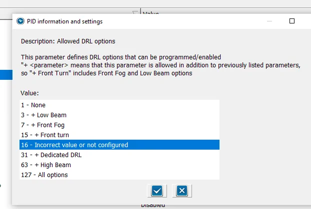

The various posts state an array of options on these setting but to get it to Factory LED (The LED Strip) as your DRL these are my findings
DRL Configuration to (Dedicated DRL)
Set this option to (16) Dedicated DRL - this will automatically set 2-Lines of Hex Code for you.
NOTE: the (16) is a Binary code that is converted to HEX (Inside of the As-Built) Files
Here are the 2-Lines of Codes it sets
BCM
726-26-02 - 0000-0001-0056 (Matches my Lariat compare search-As-Built)
726-50-01 - 108E (Matches my Lariat compare search - As-Built)
Now set Allowed DRL Options:
NOTE: The Paragraph at the top
If you have only (1) option for DRL, such as Factory LED Headlights, this will show due to the fact that it matches the (16) Binary code you set in DRL Configuration PLUS
This option ONLY modifies (In addition) (Plus) the standard factory DRL.
So, this normal - As I have not added any special (extra) DRL options to the configuration
So, with this selected, here is the last Hex Line of code that is changed (Automatically)
726-45-01 - 0A01-1000-008E (Matches my Lariat compare search-As-Built)
If you do not see this option (highlighted) then go into the As-Built File and manually change it, then when you go back to the (Module) Easy way, this will be shown
If you select (31) (+) Dedicated DRL here, you will see the As-Built Hex Line change to this
726-45-01 - 0A01-1F00-008E - ----This does not match factory settings
Others have posted that you need to set it to this, and it does work, as I have operational checked the Headlight's and DRL's using this one (1F00) and (1000)

I know there have been quite a few posts on this subject and I wanted to pass along my findings
to clear it up
These are the confirmed settings for the Lariat Factory LED Upgrade, now it should also clear it up for those who have installed the (aftermarket) options. With the attached pics, you can see it more clearly and visualize what changes you want to make
Here are the changes each selection makes to the Hex Line
726-45-01 - (0A01-XXXX-008E)
None: 0100
All Options: 7F00
Low Beam: 0300
Hi-Beam: 3F00
Ft Fog: 0700
Ft Turn: 0F00
Dedicated DRL: 1F00
Incorrect Value or Not Configured - 1000 (Factory Lariat Setting (LED)
Hope this helps
None: 0100
All Options: 7F00
Low Beam: 0300
Hi-Beam: 3F00
Ft Fog: 0700
Ft Turn: 0F00
Dedicated DRL: 1F00
Hope this helps

To sum it up, if you just Plug & Play with the aftermarket LED swap, you will have lighting and power issues. You MUST make changes with Forscan to get them powered and working correctly.
Cutting into the harness should not be required for this simple swap. It just needs programed source changes from the BCM
Theoretically, if you were to enable the parking lights as DRL option in Forscan, would it potentially enable you to make the turn signals also act as a DRL?
Yes actually. That's what I've done. I don't remember all the settings I tweaked but I have a 2019 XLT with the stock halogens and I've got it set up to use just the amber turn signals as DRLs when the headlights are set to auto mode.
