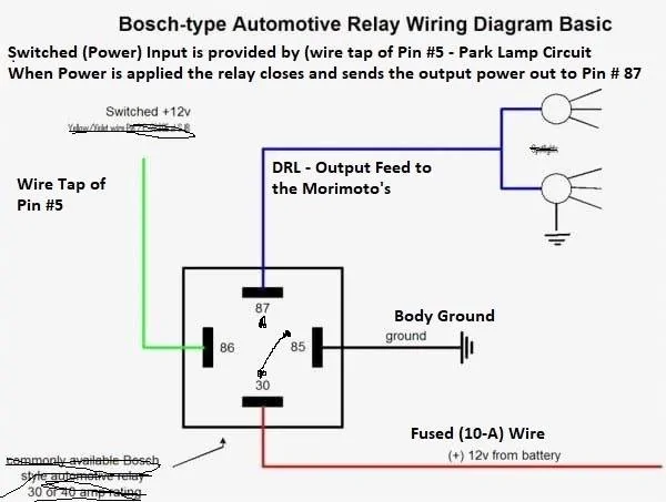

I have an idea:
Since I cannot find any specific (As Built) setting to get the Parking Lights and or DRL Lights to be triggered (ON) at engine start and in (Park) on paper anyways, as I would have to just try different settings on my own (Testing)
There is (1) exception (Remote Start) has an optional (As Built) setting to have the Parking Lights (ON) in the remote start operation.
The only settings I can find are (Include Park Lights) as DRL's, and then the Canada settings to force DRL's (ON) in all headlight switch settings (except Headlight position)
I think that even by switching to the Canada settings the (DRL) trigger will still be activated (Out of Park)
My thought would be keeping the (Tapped) power source but move where it's tapped from.
So, this would be (Direct - Power) from the Battery and using a (Wire Tap) to the park Lamp circuit as the Trigger.
So, install a 4-Pin relay.
1. Run a (10-Amp) fused wire from the Battery to (Relay - Pin#30)
2. Wire Tap (Pin#5) of either headlight harness to (Relay - Pin #86)
3. Run a wire to Body Ground from (Relay - Pin #85)
4. Hook up the Morimoto - Harness Tap to (Relay - Pin#87)
So, you are still using a Fused Tapped source but instead of (DRL Input Power) coming from a (Switched Power -via the Run/Start Relay) which switches with ignition (ON/OFF)
We would be using the Park Light circuit as the trigger.
1. The unknown is (How would this react) with the (Door Lock / Door Open) feedback on the circuit.
You may have to disable this feature, I am talking about when you cycle the Door Locks or open the door, the exterior lights (Flashing) as visual feedback.
It may be (a) the start-up sequence will complete or (b) it will not power long enough to finish
Hopefully this would add the ability of (Triggering) the startup sequence just by locking the doors or opening to doors.
2. When the truck is started - (Day) No-Start up sequence, until you move out of park and with (Include Park Lamps) as DRL's the (Start-Up) Sequence would trigger when the Park Lamps trigger on. (The unknown is - Bright or Dim?)
3. When the truck is started at (Night) the Start-Up sequence should trigger when the Park Lights trigger on (This hopefully will correct) the timing of the start-up sequence due to the fact that at night the Park Lights & Low Beams will trigger on at the same time, and the internal relay in the lights should delay the headlights from coming (ON) until after the start up sequence has completed.
4. You would be able to trigger the start-up sequence just by moving the headlight switch to Headlights or Parking Lights
This would be an alternative in finding a way to get the (DRL Lights) to be on (In-Park) and you are letting the BCM control via (Park Light) power when the relay closes.
I think this is the viable solution and I think it will work as the issue now is the fact that you have 2 separate power sources coming in and the BCM is winning the race providing the power and getting the headlights on (Hiding) the start-up sequence and by letting the BCM control the switched power (when the BCM actually triggers the Park Lights -ON) you have a evenly timed Start-Up sequence trigger.
So, you are still using the recommend way to power the DRL by the Fuse Tapped source you are just moving (when) the source has power and actually using the BCM to control it vs (NOW) the BCM has no control of that power and anytime Power is applied to (Pin#5) of the Park Lamp circuit the (Start-Up) sequence should trigger off of the added relay and apply power to the (DRL Harness) or if the pin was there (Pin#6) DRL Circuit

So, this brings us to a crossroad, The BEST WAY to (Bring Power) onto the DRL Circuit
1. Keep it as (IS) and Fuse Tap - Fuse #19
a. This is proven to be an issue, works fine until the BCM pushes power out to the Headlights (Pin#2) Low Beam Circuit.
2. Wire Tap (Pin#6) on the Harmes, anytime the BCM provides power to (Pin#6) the DRL's will light up.
a. This creates an issue with the (Start-Up) sequence function, it will only power when you take the truck out of park and its (Daylight)
b. FIND a (BCM) Programming setting that will allow power output on (Pin#6) when the truck is in (Park) with both (DAY) & (NIGHT) scenarios.
This will simulate - the Fused Tapped - Power
The issue, in the As-Bult files, I do not see any settings that will provide that (power) need.
3. My Theory of (Finding) an alternate (Taped-Power) source and let the (BCM) itself provide the power source.
a. Wire Tap (Pin#5) on the harness side of the connector (Either LEFT or RIGHT) with most of the complaints occurring on the (LEFT) I would try the (RIGHT) first
b, by using the (Park) Lamp circuit as the (Relay) trigger, anytime power is applied to the (Park Lamp) circuit will (Power) the (DRL- Tapped) power source (Pin#6) in the headlight wiring.
c, so this is (STILL) a Tapped Power source but you are (ELIMIMINATING) the (Ignition-Run/Start) relay bringing the power in and using the (BCM) itself to provide the power via the (Park Lamp) circuit.
d. This will cure (I Think) the Start-Up sequence not being seen at (Dark)
e. However, in (Day) the startup sequence will only function when you come out of (PARK)
so, a small caveat - you lose the sequence at start-up in (Day) operation only
f. In (Night/Dark) - operation the (Park-Lamp) powering up will close the added relay and provide the (Start-Up) sequence as the Park Lamps & Low Beams will be commanded on at the (Same Time)
Vs
BCM Powering First and winning the Race throwing the Headlight Relays (Out of Sequence)
I hope this makes sense, and since I do not have aftermarkets, I cannot actually test this out.
I am only going off of - the issues you both have and your findings in your test results thus far.
I am 90% positive that the timing of the (Tapped-Power) source is the cause and thinking that moving it (when its actually applied) will cure the issue and unless I can find the (HIDDEN) BCM As-Built data file that will (power-out) Pin #6 at engine start.
The adding of a relay on the (Park-Lamp) circuit as a (Coil-Side) trigger to close the relay and (Power Pin#6) will be the most logical option
Again - UNTESTED but in theory makes the most sense, as we are talking about (Milliseconds) in Time

Here is a simple diagram of what I am talking about
You are still using a (Tapped Power) source and a RELAY, but you are letting the BCM dictate when the power is applied and that is when the BCM turns on the power on Pin#5 (Park Lamp) power.
This should cure the issue of (Improper) Timing from the current wired setup where the (Run/Start) Relay is in control and letting Fuse #19 power after it closes.
With the BCM being direct power - its beating the transition of the (Run/Start) relay getting closed and also the BCM (Can Bus) Data transmission on (Ign Switch) Position (ISP-R)
By moving that (Input) feed (Power-Trigger) to the (Park Lamp) circuit, I THINK that this will provide a (BETTER TIMED) - Power Trigger for the DRL (Start-Up) Sequence
OK, if I read you right you are letting the parking lights control a always on power source. Am I correct?
If so, you are going to get a startup sequence anytime the parking lights activate. This will be when you lock/unlock the doors or open any door, just turn on the parking lights on. This thing likes to turn the parking lights on for everything. Not the way I want my headlights to work! I don't want to have to have to add any components and do any extra wiring to make this work, a simple Forscan changes maybe.
As I said before, I really don't have a problem with how they work now, except for the startup issues in dark mode. The DRLs being dim during the day is not and issue to me. It was my choice because I wanted the taillights on with the DRLs.

This theory can only be tested by (adding) a relay into the circuit and letting Park Lamp Power do it.
So YES, the DRL input - must be powered to begin (start) the sequence, if we let the (Park Lamp) input be the trigger it just (MAY) start the sequence up and the end result will (END) with the headlight's on in (DARK)
as for your testing this far has been using (Park Lamps) gets the (Start-Up) sequence to work, but if you go to (Headlamp) position or (Auto) position in the dark, the BCM has already powered the Headlights.
By using the (Park Lamps) Powering as the trigger, may let the (Start-Up) sequence happen before the BCM can take control and turn on the lights.

But with Relay (In-Hand) before I would actually Wire-Tap wire #5, I would Back-Probe) the connector first and tap power from that, then proceed with testing to outcome on (Back-Probing) both sides Left & Right to see if there is any time delay (In that circuit) which side will provide the result I want (if it matters) the best.
If successful then do the actual Wire Tap of Pin #5
