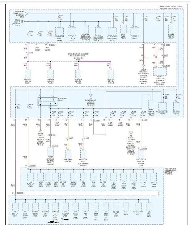

I will try to highlight what is happening withing the BCM and the (PCM Wake Circuit)
and what it takes to get (The Run/Start) Relay to Close and get power available on Fuse #19
Find Fuse #67 and follow it down - Look at what is powered off of Fuse #67
Note ALL RH Exterior Lighting - PLUS internal BCM circuits related to Interior Lighting (On Demand Batt Save) and (PCM Wake) are the (2) that I want to point out but FIRST this NOTE
Fuse #67 & Fuse #62 - are always HOT circuits as well as the circuits that feed the (Headlamp Switch)
Meaning if you were to leave your driver's window open and let the truck sit for any amount of time, you can reach in and move the Headlamp Switch from Auto to Headlamp and the Headlights will come (ON) they will remain (ON) without turning the ignition switch to start for 10-Minutes (The Batt Save Feature will trigger) and they will shut off
As I mentioned in a previous post, when the ignition is switched off there is a 10-Minute timed relay inside the BCM that will shut off exterior lighting.
My (Untested) theory is (That Timed Relay) is activated weather any lighting is actually on or not.
I can confirm as I use this feature regularly, I shut off the truck and listen to music, the music (SYNC) will stay powered for 10-Minutes and then shut off or (IF) I open the driver's door it will shut off immediately.
I played with this feature and while listening to music I moved the headlamp switch from Auto to Headlamp - and when the Music Timed out - so did the Headlights (Without Opening the Door)
I tried it again - but this time I opened the door, the music quit - BUT the headlights stayed powered for the remainder of the (10-Minute) timer that was left and then they shut off.
So, what this CONFIRMED for me was that the Exterior Lighting Circuit has a 10-Minute (Time Delay-Relay) incorporated into it from the BCM (Control)
This is something the service manuals do not cover and only found by my (T-Shooting)
This (Time Delay-Relay) MAY be part of the issue with the (Startup) sequence of the Morimoto's
I can only PROVE it is there but cannot prove its a factor for the issue.
Let's highlight why the RH side and LH Side - Timing plays a factor granted it is only milliseconds
Let's start with the (Bottom Row & Fuse #67 - Power Feed) and general focus on what happens when you open the driver's door.
1. The Door Ajar Circuit has triggered the Courtesy Lights (ON) - that power trigger has forced the BCM to supply power on that (Fuse #67) circuit and this also triggers the (PCM-Wake) the BCM then supplies a Ground to the PCM Power Relay and it closes, when the PCM Power Relay closes you will HEAR the noisy Wastegate Actuator Cycle through its (Self-Test)
Note: The PCM Power Relay will stay closed for (3-Minutes) and then open (IF) an engine start or ignition switch input has not been completed within that 3 minutes.
2. Let's say you just (Normal) open the door get in and start the truck, the Fuse #67 circuit has already been pulsed with power, the PCM Power Relay has already closed (via PCM Wake) circuit
and when you transition the (Ignition Switch) past (OFF) the Run/Star Relay will then close this is accomplished by (Can-Bus) data (ISP-R) Ignition Switch Position - Run
When the Run/Start relay closes (ONLY) then power will be available for Fuse #19
Disregard (Fuse #20) to the Headlamp Switch (That is not correct, and the diagram is WRONG)
that power is strictly supplied by the BCM (Internal circuits) and is not a fused source.
I only want t to highlight why the RH headlight can be powered (First) and it is due to the internal circuits of the BCM sharing the RH Lighting circuit along with the PCM Wake circuit as well as the courtesy lighting and I (THINK) this circuit design is PART of the problem as the RH side will power faster than the LH Side, and I think as far as the BCM power output goes the LH side will transition after the Run/Start relay closes - so even without the Morimoto's you already have a (SLIGHT) delay in the timing of the exterior lighting circuit (Transition) inside the BCM.
It is caused by the transition of all the relays and can-bus data transmission at the start-up
A slow data transmission of the (ISP-R) will be the most likely cause of a visual headlight on delay
If I am correct the RH lighting circuit sees it (FIRST) then the LH side.
It boils down to how fast the BCM can process the (You want me to apply Headlight Power Request) at (ENGINE START)
To compound the issue even further - you have a Tapped Power source coming in (AFTER) the Run/Start relay closes - Fuse #19

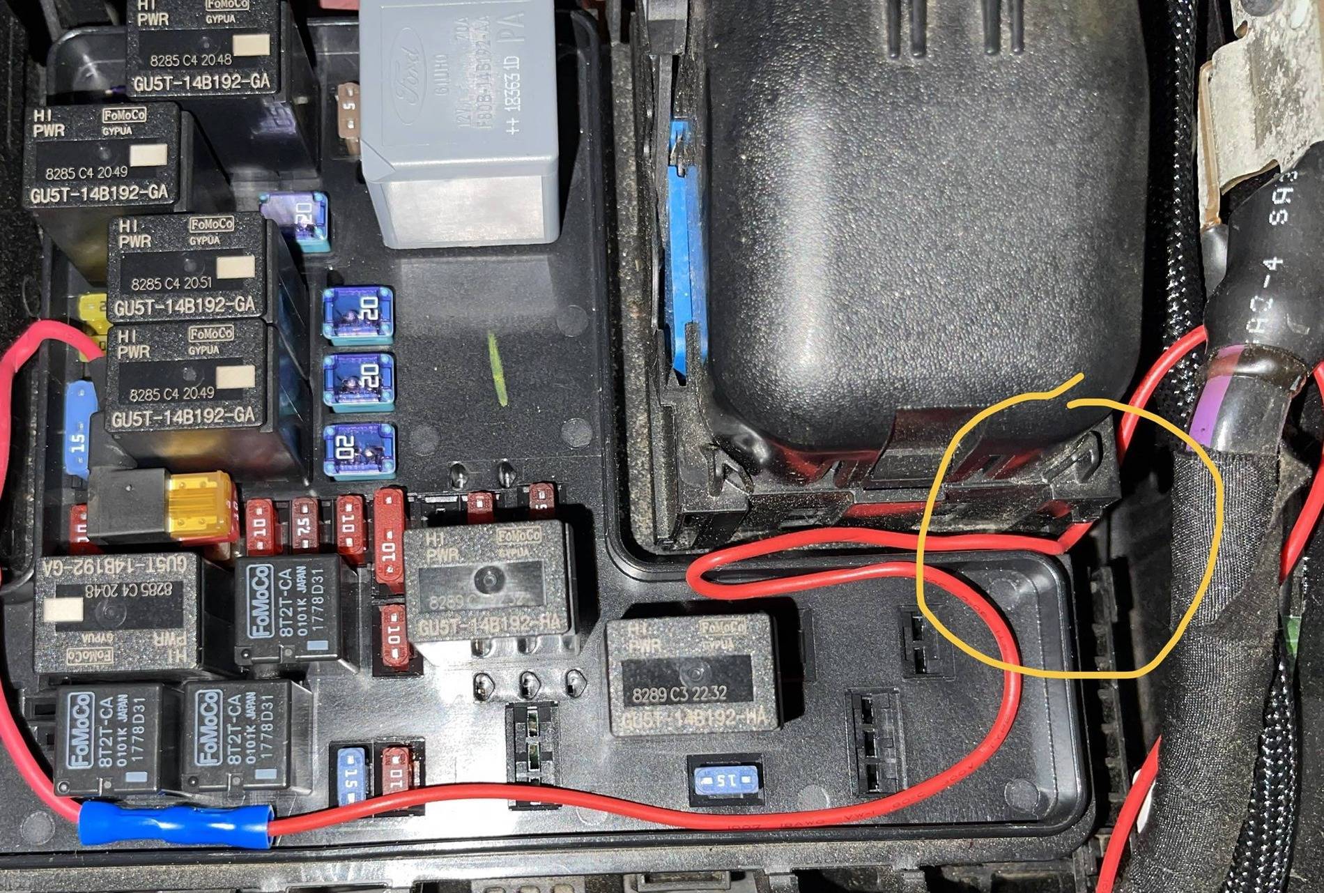

I do not know if it makes any operational difference or not, but I wanted to add something that I recently discovered and noted about the popular fuse taps - it's a combination of the design and the very limited fuse tap points on the BJB.
The Following is a Copy & Paste from my post in another thread, that MAY be related to this one.
The reason this MAY be related - Ref the video below, now Fuse #19 is not blowing but @ Engine Start & Start-Up Sequence pulling amperage across the (10-Amp) fuse may be causing some of the Morimoto's Start-Up sequence issues.
Ok:

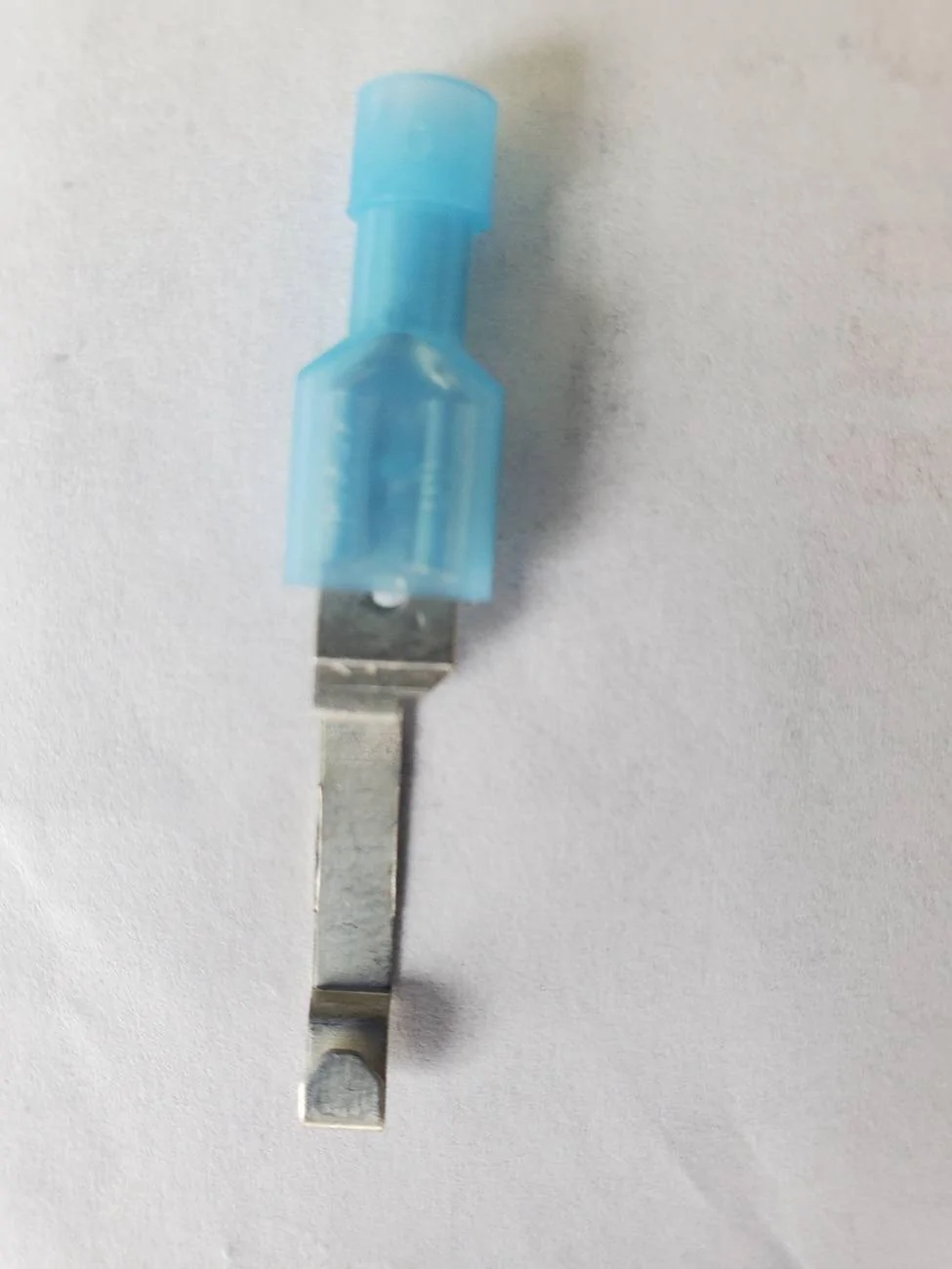

First, I have to disclose I have never really dealt with the newer style fuse taps and just realized the difficulty in Fuse Tapping the BJB (Engine Bay Fuse Box)
Moreso: The popular Fuse #19 Slot.
As I never looked into how those are wired and how they need to be properly oriented to allow proper circuit protection - I see why the Aftermarket Mfgs want to use Fuse #24 as a tapped source.
You can properly orient the Fuse Tap to pick up - (Source Power) on the proper leg vs Fuse #19 you have the relays blocking you.
First:
I have used this type of Tap on previous vehicles and actually had this type for my (Head Unit) (RAP) Power where it held all the presets/ clock etc.
I did have to (reseat) the fuse on occasion as over time the contacts in the fuse box were spreading from the extra thickness that is added by the tap.
So yes, they work, but they will eventually require you to spread the tap end out to take up any gap created as time goes by.

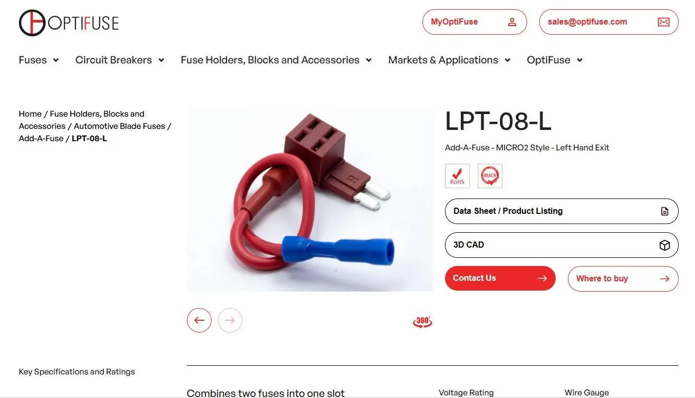

A Better Option - Same Idea of Tap is this

Note: You can easily make your own with a soldering iron and wire, this set they have done that for you.
I believe it was asked in another thread about this:
I did find this, note this is a Canadian Company, need to research deeper if the US can get this style.
LH - Exit - all others that I have found are RH-Exit
This will allow the same (Cube) the extend over to the right across the top of the other fuses, but you are still dealing with the wire & relay interference.
Note: As it appears the RH- Exit style is too long and will hang outside of the box enclosure if you were to flip it around to pick up the proper orientation as well as the (Relay Interference)
So, this style (LH Exit) only cures 1/2 of the problem - you still have (wire to relay interference)
I did not know this about this style of fuse taps as I never used them but in order for them to properly protect (2) circuits they must be (Installed) in the correct orientation.
The picture below shows (IMPROPER ORIENTATION)
Reason: The side that the (wire exits) is the (Output Feed) side of the fuse
This is tapped into Fuse #19 Slot
With the (Vertical) Fuses (pictured) the (Source Feed - Contact) is on the (Most Forward) Pin or the one closest to the cab.
So, with the below install the lower fuse is taking the current of both fused circuits
So, if improperly oriented (like below) if there is an issue on either circuit the Bottom Fuse could Blow and take both circuits vs separate circuits as the tap is intended.
I find it somewhat amazing that this is not highlighted in the install packaging or instructions from most of the manufactures of these taps and I only recently noted this from the latest posts about taps and locations, I never thought that these were (orientation dependent) but they are to get the (Full - Intended Usage) of the tap.

So Real World since I think all owners who have tapped (Fuse #19) with a fuse tap have not experienced the (fuses blowing) but however there are reported issues with (Headlights) and this tapped source, and this would Highlight some of the various intermittent issues with them as a possible (Fuse Tap) orientation from the tap (MAY) be the source of the issues.
Too much amp draws for the 10-Amp fuse feeding 2 outputs.
But other than that - it appears the circuit can handle being tapped improperly; it works but it's not as it is designed for.
So, to close, we are limited to fuse tapped sources in the Engine Bay Fuse Box, more highlighted in the 2020 and up Rangers who lost Fuse #24 as a viable tapped source.
To only way to gain it back would be to open up the fuse box and solder in a Fuse Socket, it would be nice to find the Part Number of one or get a salvage yard (pick n pull) fuse box with or without Fuse #24 present - Swap in the salvage box or use it as a doner box and swap the fuse socket over to the existing box if unable to find a part number for the (new socket)
Another option would be to - add an auxiliary fuse box and then just run your wires to that and skip all the (Fuse Tap) Limitations
