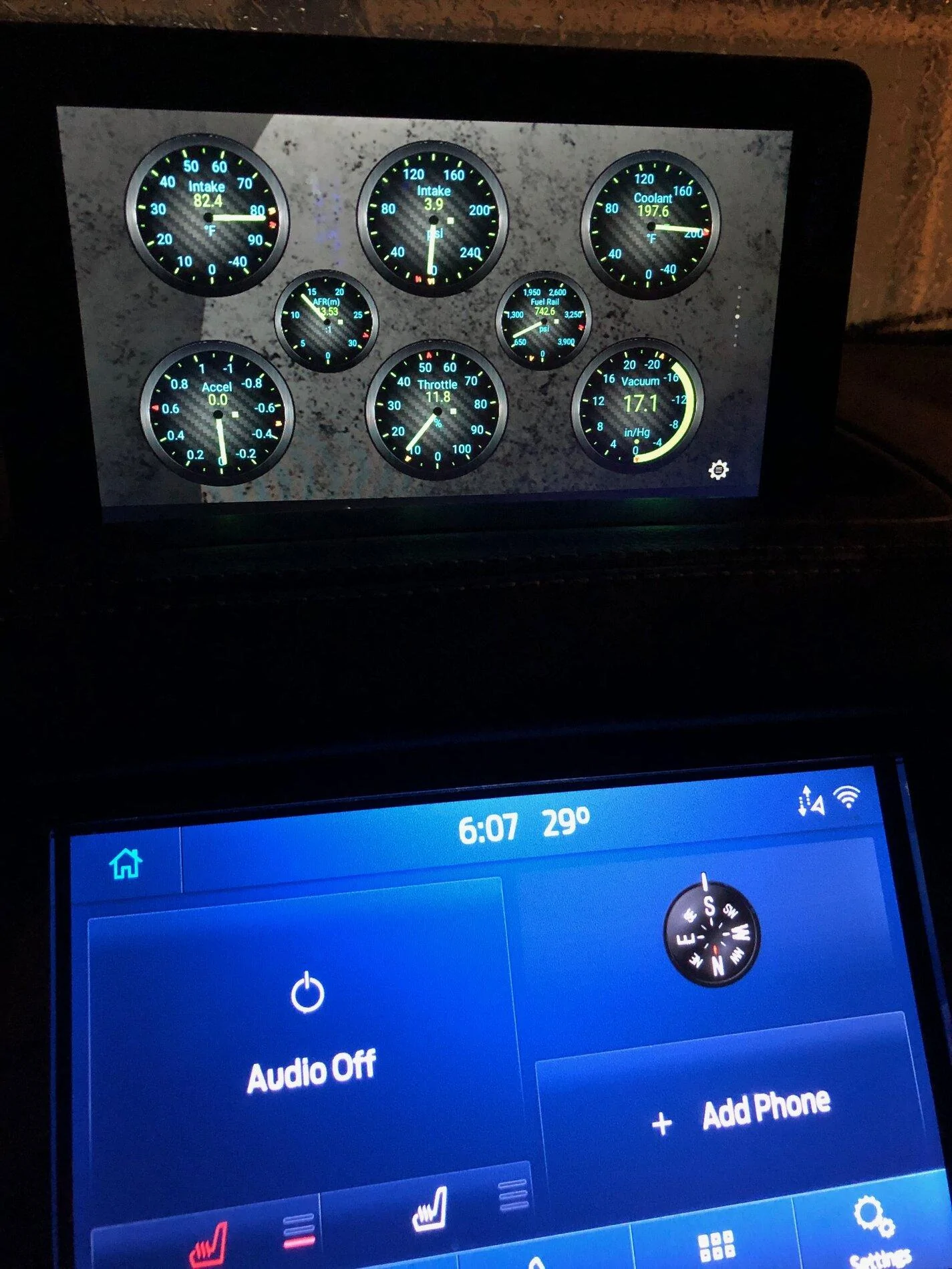

Here's my current layout:

how are you guys getting the gauges to come up on your sync screens?
By using OBD2AA on Android using Torque:
I use ODB2AA from XDA Labs. Here is a link to a video that explains how to get and use the app. costs like $2.00
If the link doesn't work just Google ODB2AA and scroll down till you see the Youtube links.
If I get a chance today I'll try and get a picture of my display.
