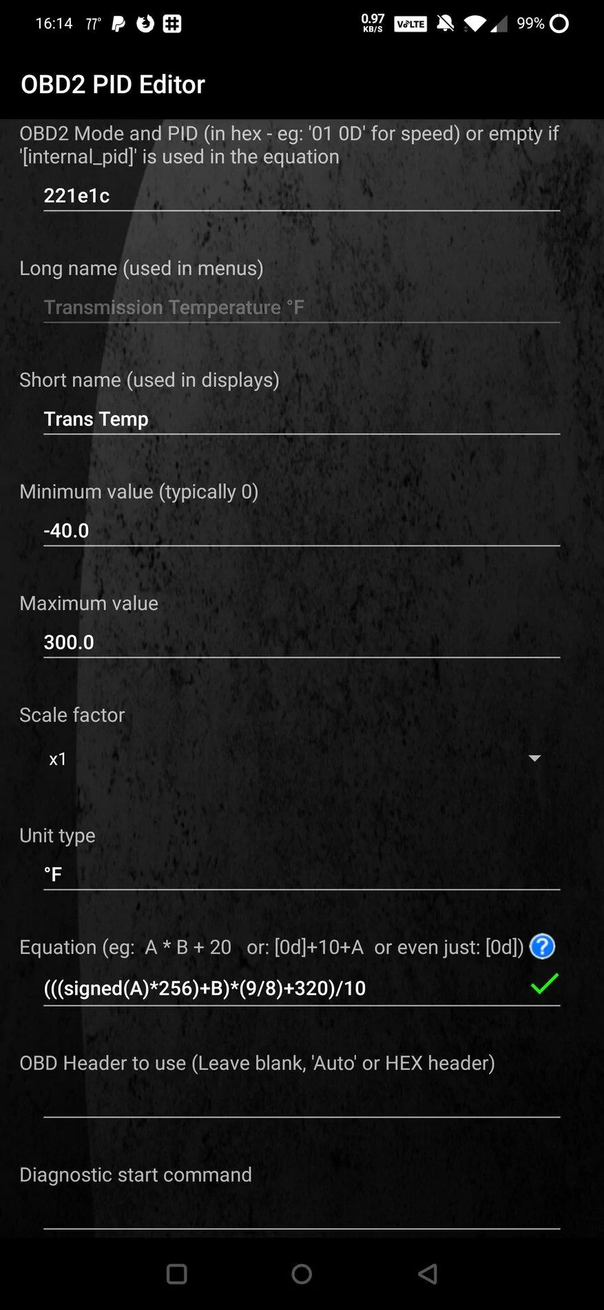

So I've been tinkering. I finally got Transmission Temp added to Torque once I looked up the formula.
Code for degrees Fahrenheit:
Code:
(((signed(A)*256)+B)*(9/8)+320)/10

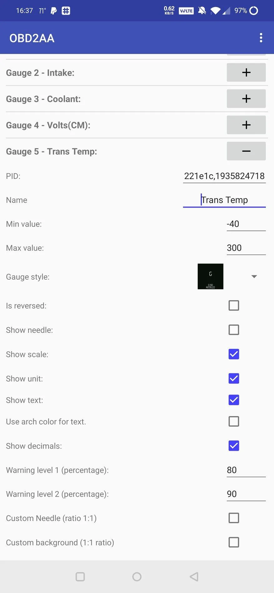

This works fine in torque. I tried adding it to OBD2AA yesterday, and it would show up, but never with a temp and would actually completely lock up OBD2AA until I wound up removing it. And just now I tried to select this PID again so I could take screenshots for here, and it's just not even showing up as an option anymore.
One thing I've noticed as well, OBD2AA will launch Torque and it'll run in the background, but unless I foreground the app (actually open it) it'll never connect to my OBDII adapter, which is weird.
******EDIT*******
And now it's picking it up again. This looks like what I had before that was causing it to crash (minus the gauge style, I had changed it for another PID).
Thanks for the info on this (Trans Temp formula)....works like a champ!!

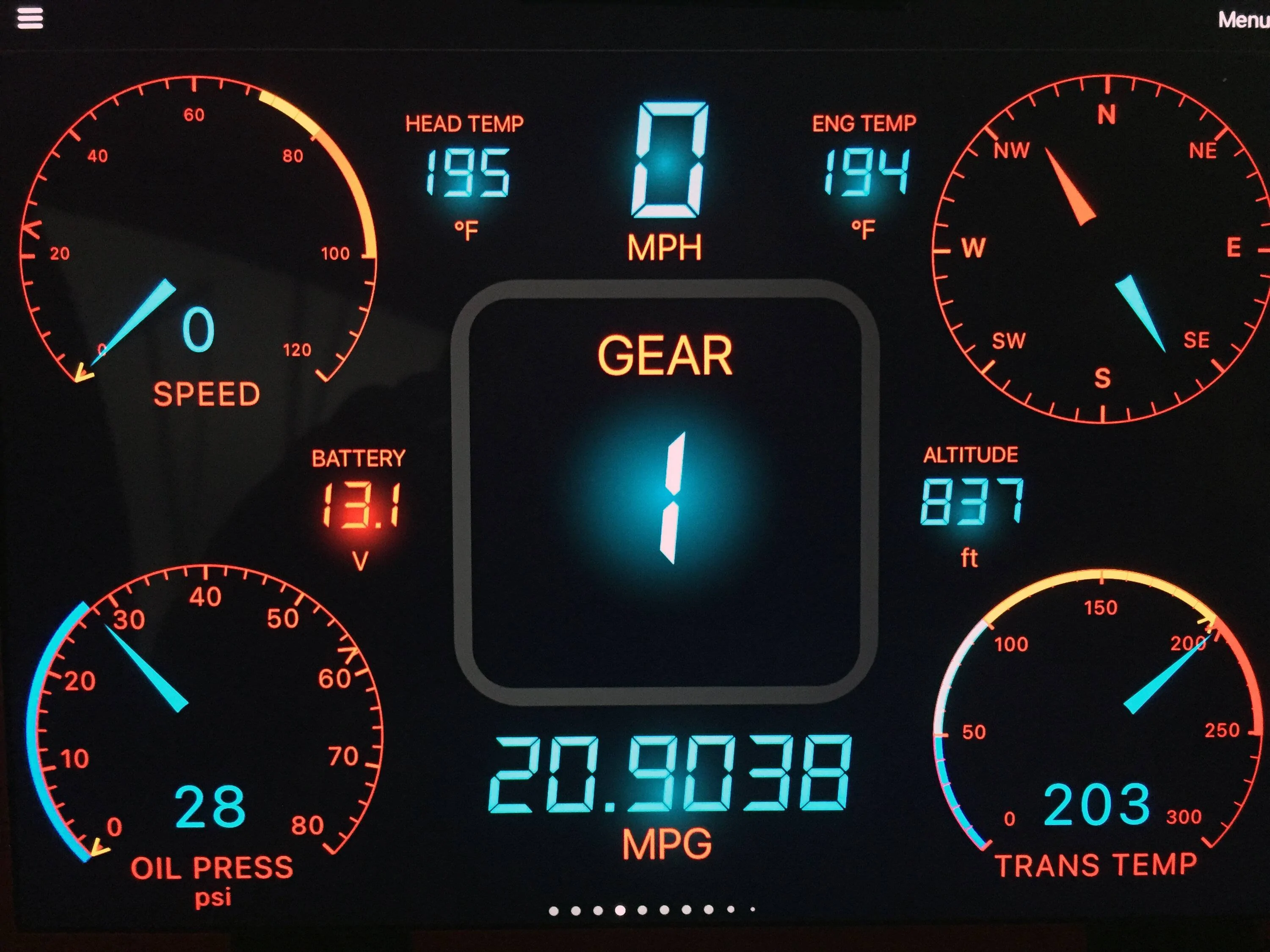

I may try out the XDA app but honestly....I like having the gauges running on the tablet in my dash tray. The magnetic mount I bought is very unobtrusive and works great! It gives the Ranger a cool look with the gauges up on the dash...especially at night. Plus I don't really care for the gauge "look" on the XDA setup. I have a Torque gauge setup for daytime and another for night that looks so awesome. Anyway, I do love the way you guys are running your gauges....that's pretty cool! Thanks for all the info!!! Big Blue too!!

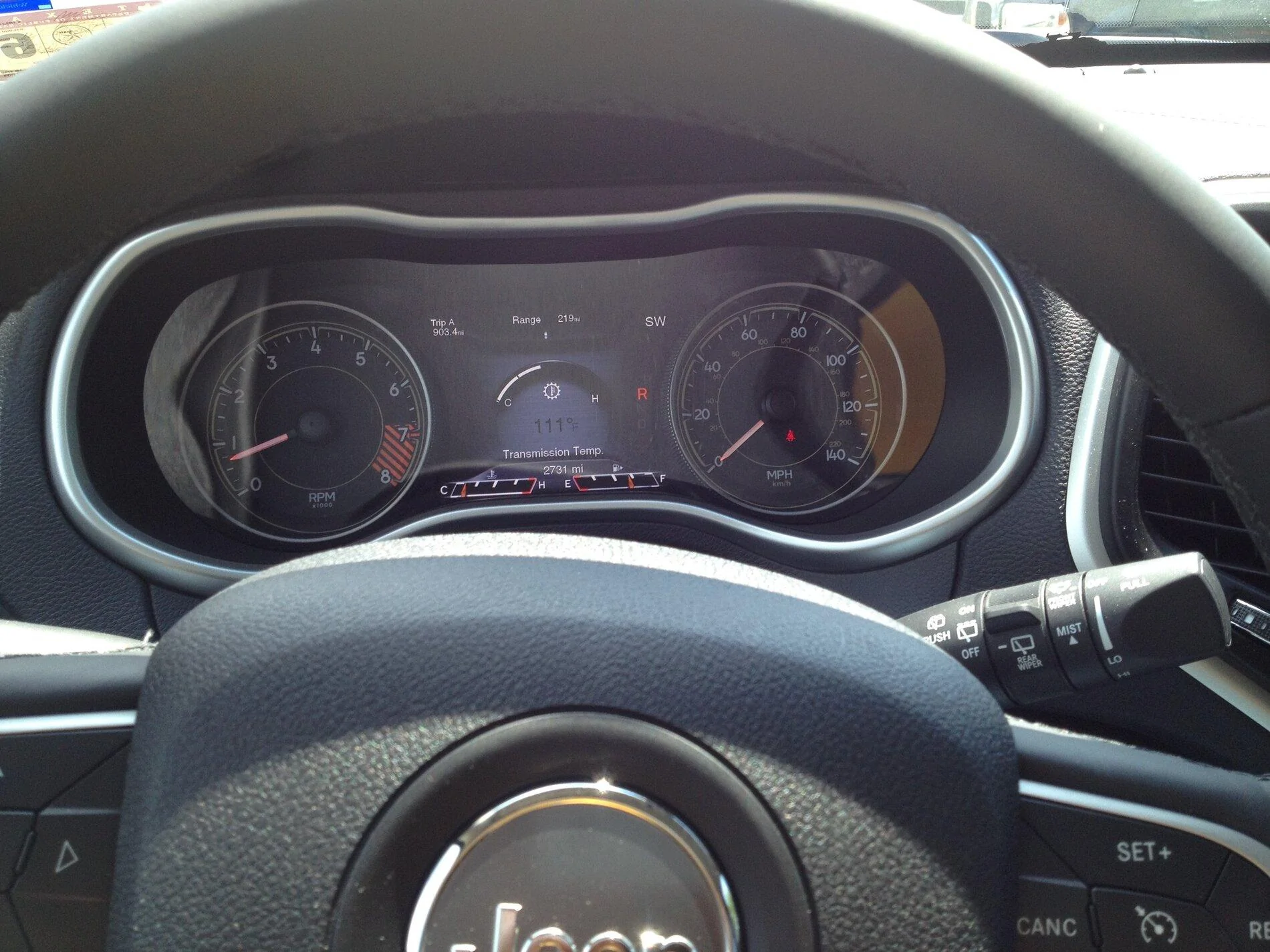

As much as I hate to admit it FCA got it about right with my old 2014 Jeep Cherokee Trailhawk. The center is showing trans temp and was configurable to other data including oil temp! Each of the smaller text surrounding data was also configurable.
