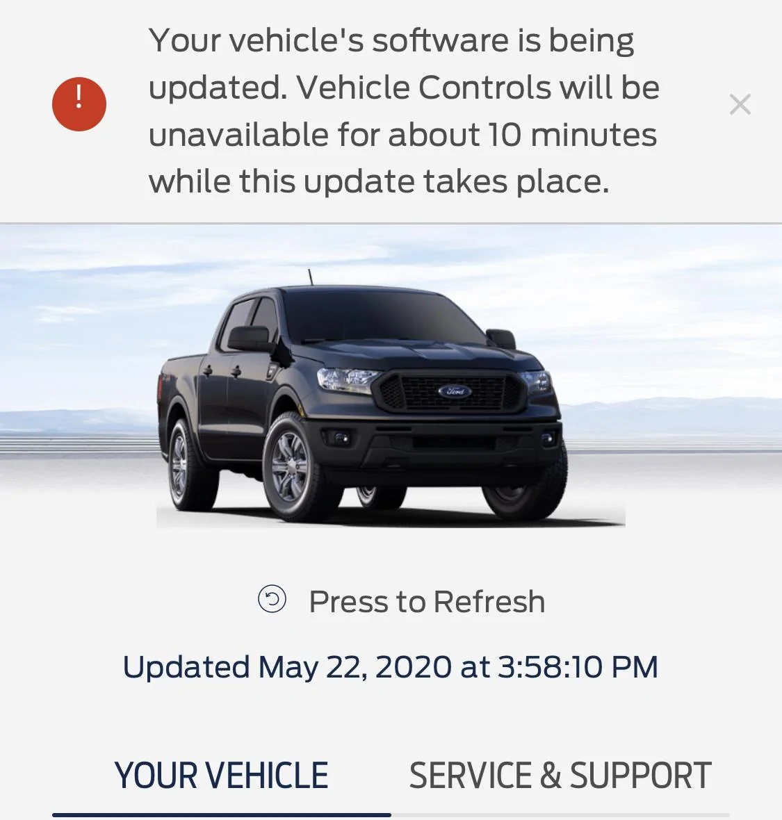

Noticed I can’t auto start my truck from the FordPass app. Seems it’s stuck on Old software. Tried to hook up a usb directly but no option to install or update. It just says wait 10 minutes. Last refresh back in May? Any tips?

Went to dealer. They said I needed to wait 24 to 48 hours once you remove your truck from the app to detect. Instantly I called b.s. This sounded like calling the cable company on an internet outage. But, I waited. Same message. No connection to Ford Pass.
I reset the master settings in the vehicle, tried again. Nothing. I turned everything on and off thru sync and Bluetooth. Nothing. Seems I’m high centered now. Shame. I called ford pass online customer service and had them walk though their protocol. Nothing. I’m done with it.

So just an update, I finally got the truck back to the dealer and they said the Telecomm Module was bad. It would not pick up the signal so they ordered a new one for me. Will take about 2 weeks to get the module and only 30 minutes to an hour to replace once it arrives. Dealer said they have seen 3 Rangers now since the March update that has this problem.
I just had this done as well 2 weeks ago. Everything back to normal now.
