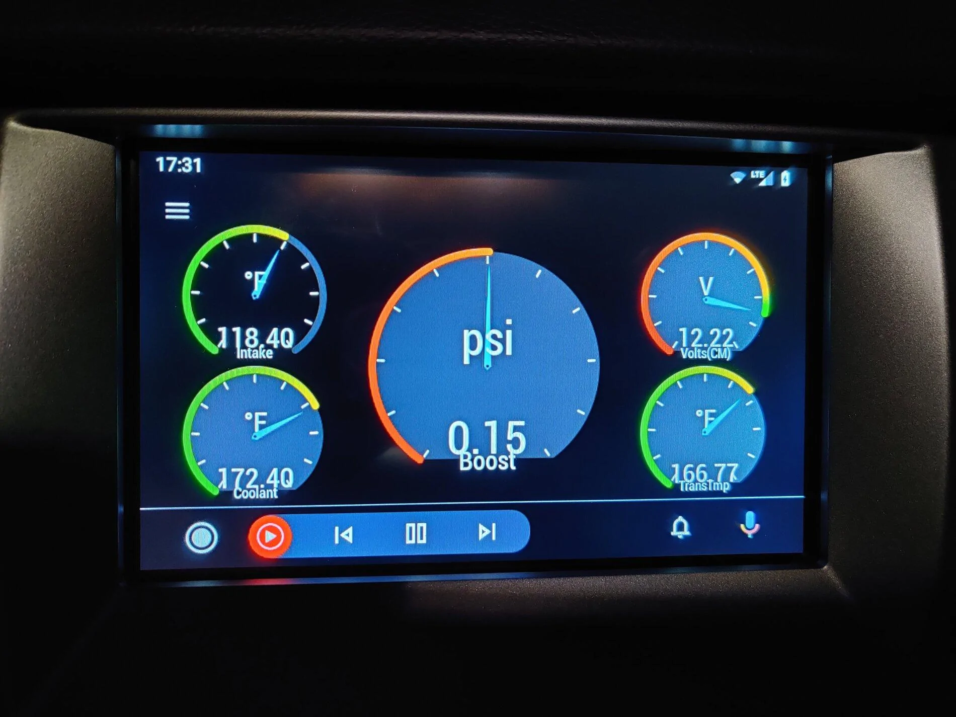

Yeah, I've used Torque for a long time, and I remember that. I just forgot to add them again since I switched phones. Thanks again for the help!
Looks like using the *FORD* transmission temp stops OBD2AA from crashing/locking up.
Here's my current layout:

Looks close to mine. Multiple screens with different gauge layout, like Torque would be nice, a guy can dream right. Have to look up the developer and sent him a wish list. Still beats having another display stuck somewhere.
Well now that we solved a couple of minor world problems we can sleep sound tonight. Wish I could of had a Wild Turkey or a Manhattan with my soak, but those days are gone, just have enjoy the spa tub. It was great by the way, back feels much better.
Agreed. I would love to have at least one more screen to swipe between (good for a road and off-road set of gauges for instance). It would also be nice if the TPMS screen worked and we could incorporate those even into the single screen (say around the main gauge?), but anytime I click on one of the fields it crashes the app.
