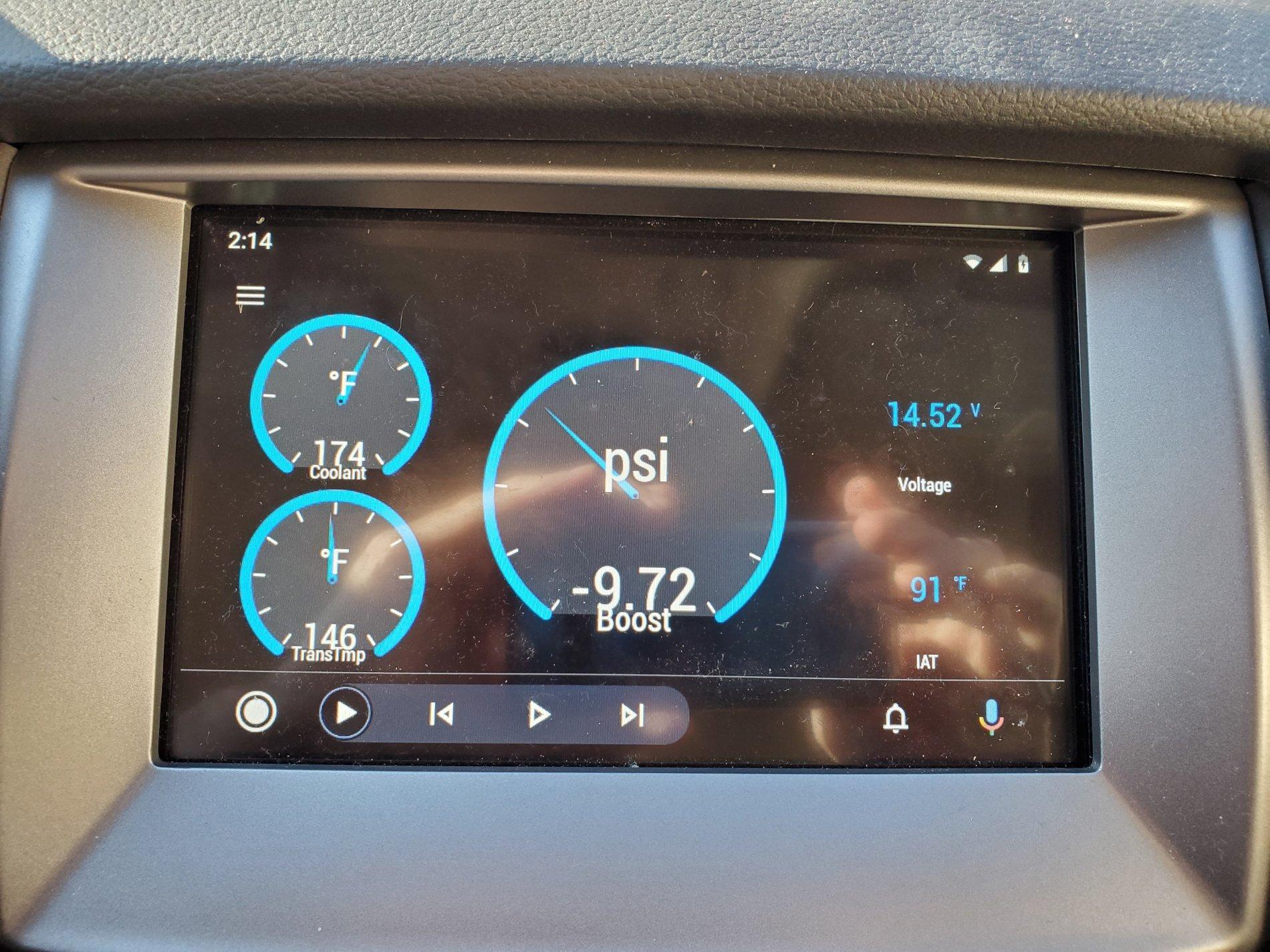

Finally got out to photo my gauge setup. Changed my arches to solid blue to match my truck. May add the warning colors back in for the temp gauges though. Work in progress. IAT temp was up because had it idling in driveway for a while and heat soaked the intercooler. outside ambient was only about 60F, it was a heat wave here in Wisconsin for November.
Very interesting there. My only question is do you need an OBD2 adapter or does it all go off of Android auto?
You need an OBDII adapter to read the data from the truck.
I use an ODBLINK MX adapter same one I use for Forscan. You need to have the Torque Pro app on the same phone you use for Android Auto.

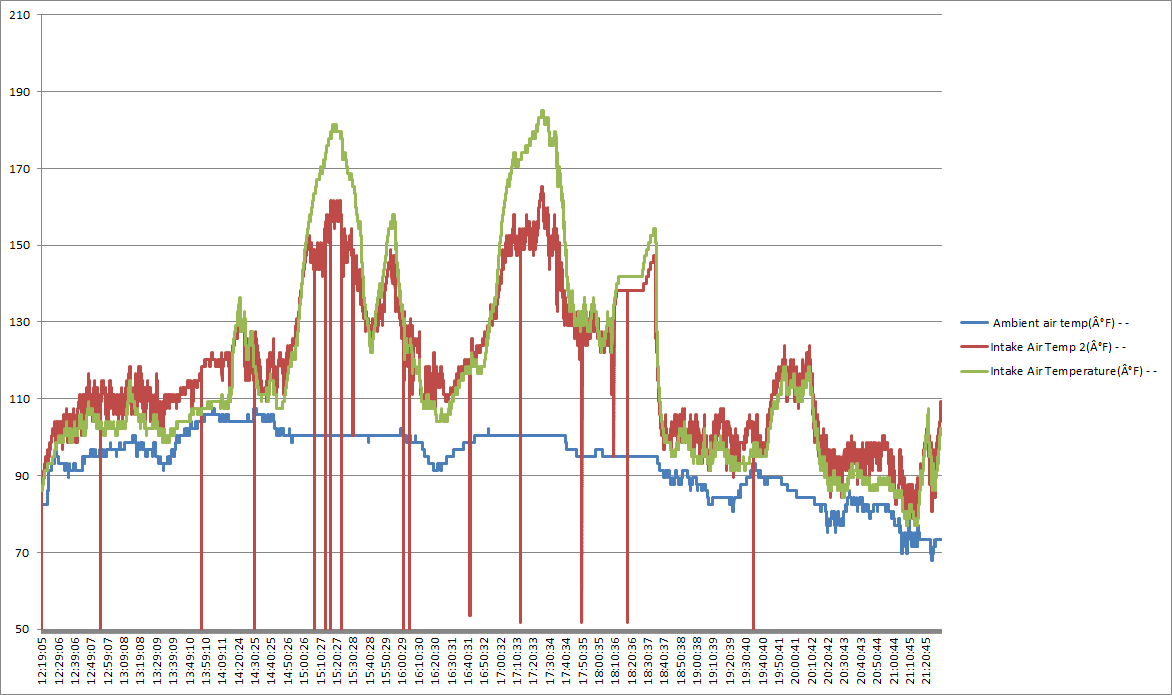

This is what one of my offroad trips looked like (ambient vs intake, ignore the dips):

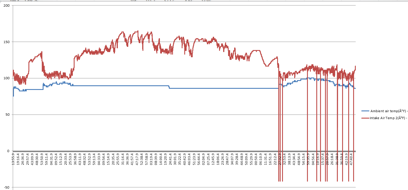

Here's another one of my trips. IAT2 is the "calculated" value where IAT is the "real" value according to Torque. Bet you can't guess when I was offroad? haha. Like I said, normally it's totally fine, but slow off-roading does a number on temps.
