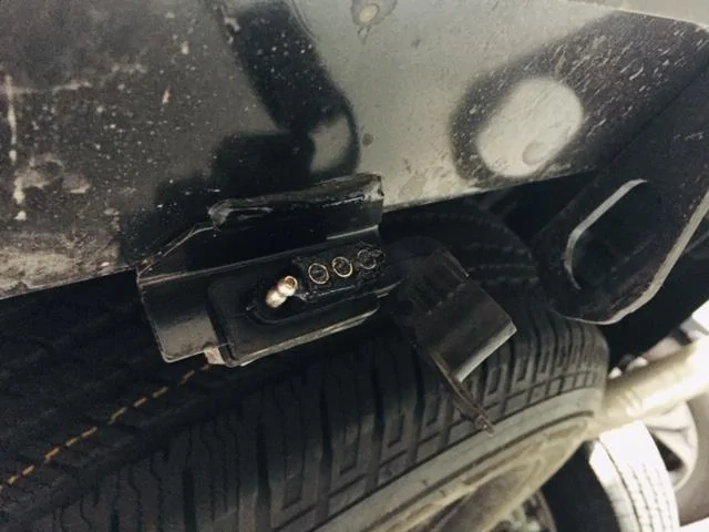

My 2020 scab XLT has no hitch, but has this 4 pin below the driver side rear bumper. How would you connect it to this Ford part? :
https://www.tascaparts.com/oem-parts/ford-trailer-tow-harness-connector-fu5z14489a?c=az0x
You'd prob just need an adapter like https://tinyurl.com/ye9d54y6 but I've not used one so not sure how it would translate power that's needed for some trailers. Also prob wouldn't work for powered brakes. If you need those, you'd need one of the wiring adapters I linked above.
Big Blue
Lee
May 5, 2020
3,946
9,442
Retired mechanical designer
Can't say for sure because mine has the factory tow package. I believe there is a harness needed to go between the 7-pin socket and the main harness that the 4-pin plugs into. You need to remove the 4-pin harness. That will connect to the brake wire under the dash and the 12 volt feed from the fuse block.
Please someone correct me if I'm wrong. If you use an aftermarket 7-pin adapter you will need to run your own brake and 12 volt feed wires from the front of the truck.
