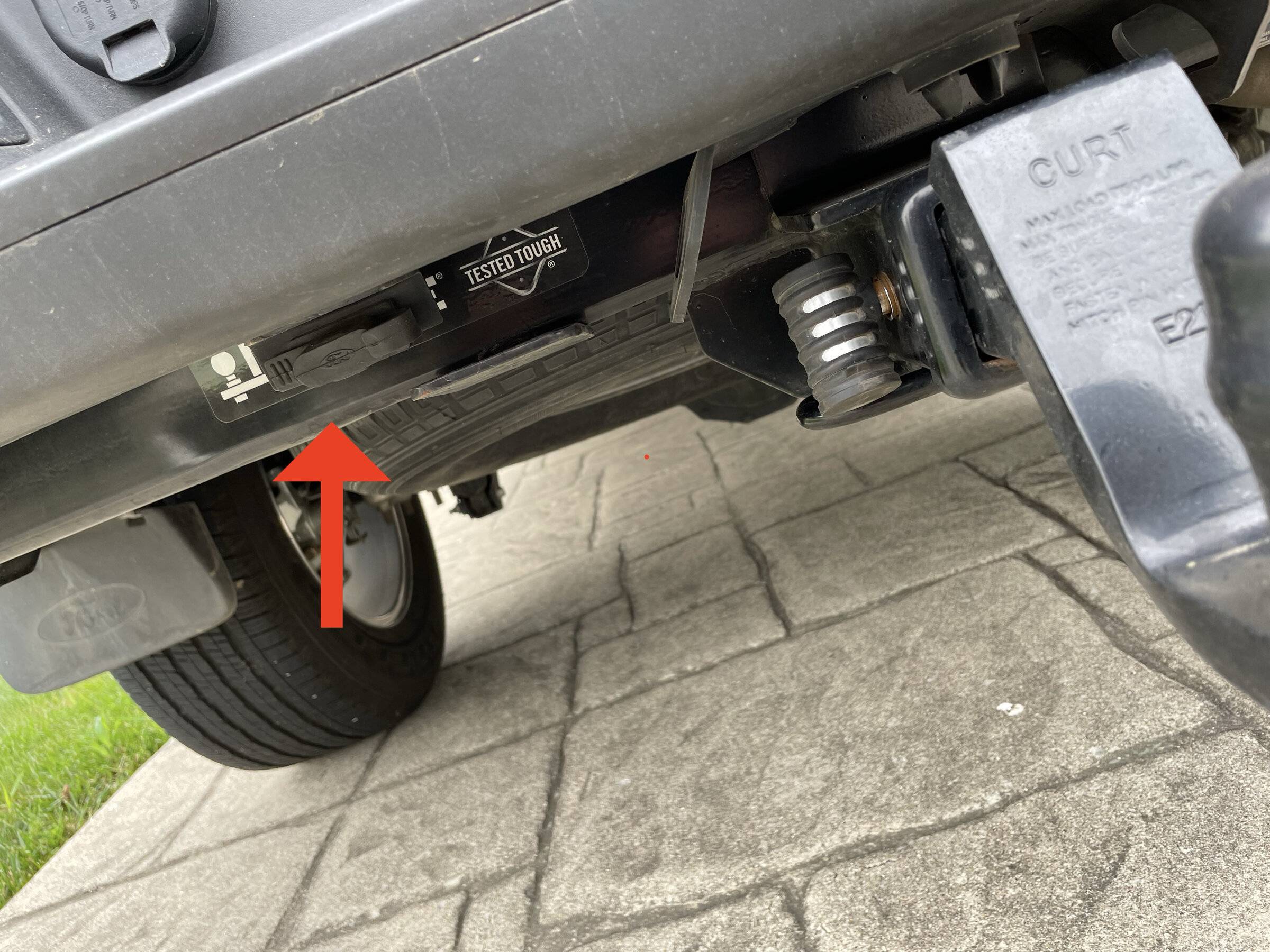

If the truck has the wires for the TBC under the dash, then I think it should also have the tow module. From what I've read here, all XLT's and Lariats have both.
My truck did not have the factory tow package. I bought the hitch, 7 pin harness and Red-Arc TBC from etrailer.com. The wires for the TBC were under the dash, the 7-pin harness was plug and play just behind the bumper and the hitch was a super easy install. Cutting the opening through the plastic for the OEM trailer socket and getting it to seat were the hardest parts of the whole install.
I guess, the easiest way to check if one has the trailer module would be to plug a 4 pin anything (even a tester I assume) into the 4 pin connector under the bumper. If the truck sees the "trailer" then the module is there. I have the OEM 7 way/4way next to my license plate, but use the plug under my bumper for my hitch-packer since the wire is less in the way.
