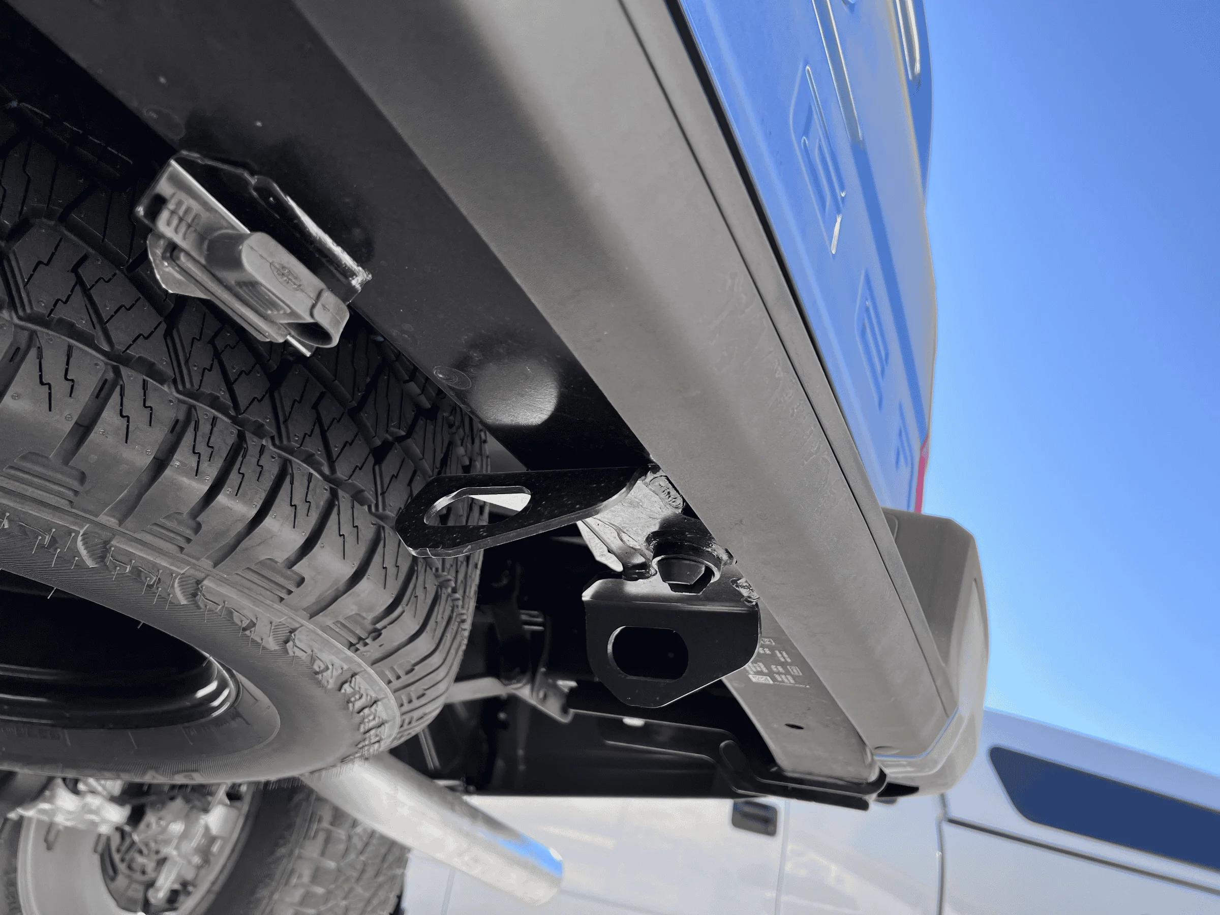

So got my 2022 Ranger by order with the tow package - truck has the receiver behind the bumper but doesn't this also come with the tow ball mounting bar as well or do I need to purchase that separately?
70
4,381
20,505
No hitch there, just the bracket for the safety chains and the plastic plug for a bumper ball.
Tow package would include a full class 3/4 two inch receiver and a 7/4 pin outlet located in the bumper next to license plate.
Even the bumper is different on the tow package.

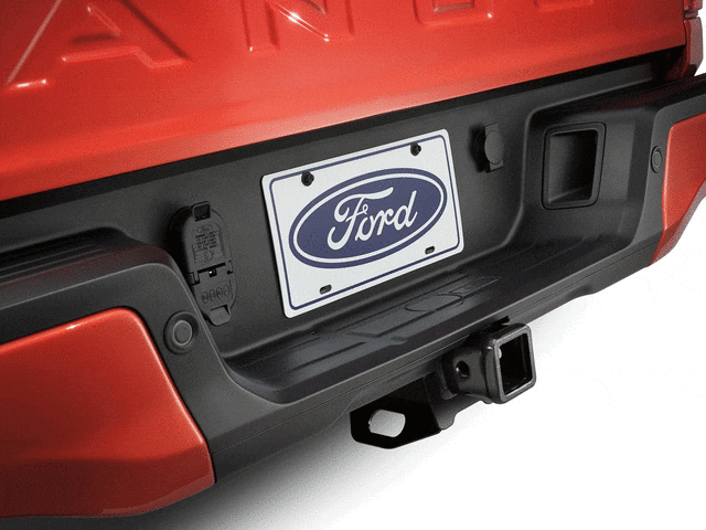

also looks like you have the 4 pin wire connector underneath the bumper as apposed to built in per Grumpaw's picture (the lift tabs to the left of the license plate).

You don't have the tow package on that truck. Also note you have the 4-pin trailer connection under the bumper, instead of next to the license plate (where it should be, along with a 7-pin on tow package equipped trucks)
