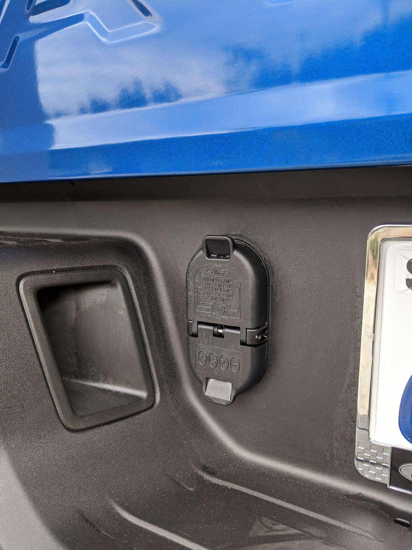

Hello, I would like to give the details for people with a 2019 Ford Ranger Base model and the parts needed to convert to 7/4 pin plug.
I just completed my installation and will provide the parts list, tools used and some photos.
Parts List:
  • 7/4 pin plug, part # FU5Z14489A
  • Wire Harness part # KB3Z15K868C
Tools Used
  • Blue masking tape
  • Sharpie
  • Flash Light
  • Needle nose pliers - to remove old harness fasteners
  • Dremel cutting disk for rough cut, then sanding drum for final details
  • Razor Blade
  • Small Flat Screw driver

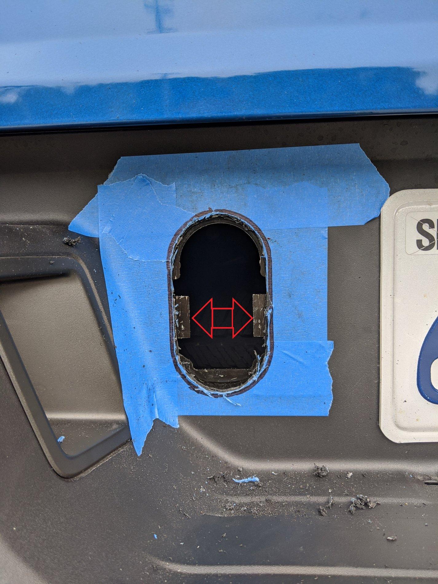

The installation is not that tough just cutting the hole small then slowly enlarging it to fit the 7/4 pin plug. I cut the plastic where the pre-marked. After cutting the plastic away, I realized the metal tabs (pointed at with red arrows in second image below named trim) were about 8+ mm further behind the plastic trim. Instead of bending the metal tabs forward, I decided to cut the black plastic trim to the max size. I used blue masking tape and a sharpie to outline the 7/4 pin plug the slowly sanded away up to the marked edge melting the plastic. I utilized the razor blade to cut away the melted plastic and finish the edge. I used the small flat screw driver to remove the silver color metal tabs from the 7/4 pin plug (see photo below) allowing me to test fit until it was firm within the plastic fascia.
I will be utilizing an all weather sealant around the edge to cover my imperfections from my trimming. Please let my know any feedback, suggestions or questions. Thank you.

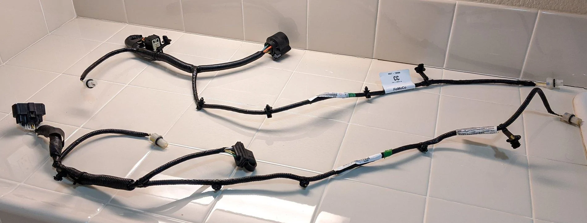

Comparison of old vs new harness, as you can see the harness also has the rear license plate light plugs.
Rough Trimmed area

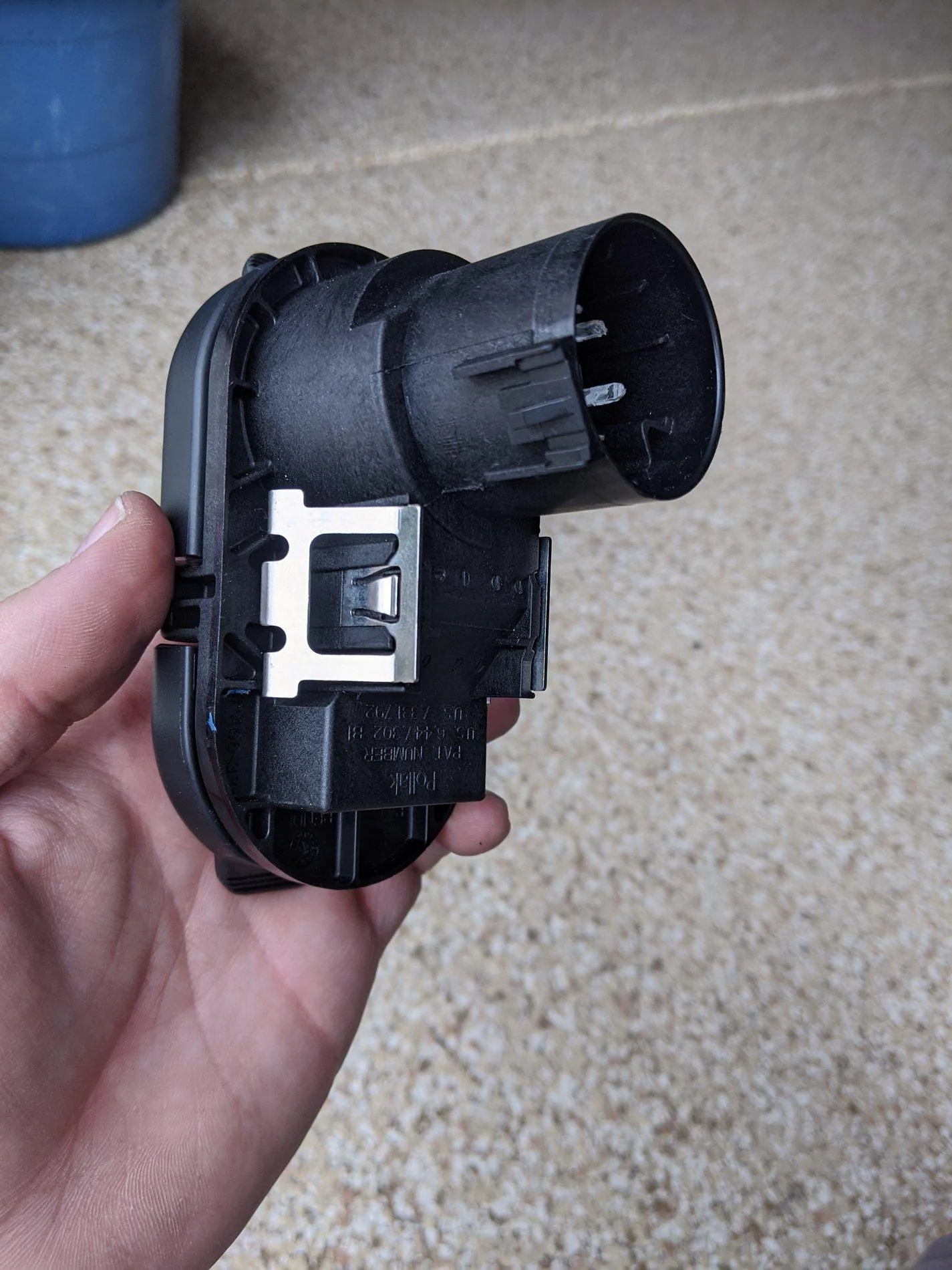

7/4 pin plug part # FU5Z14489A

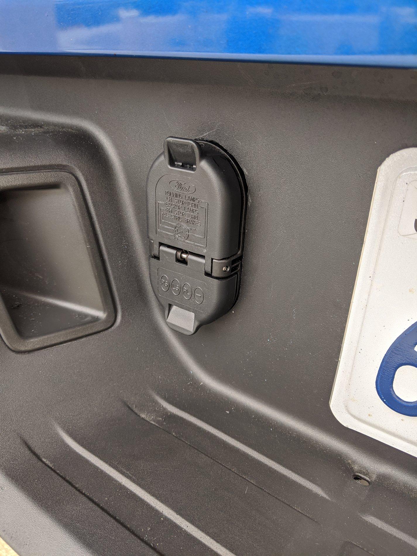

Final install

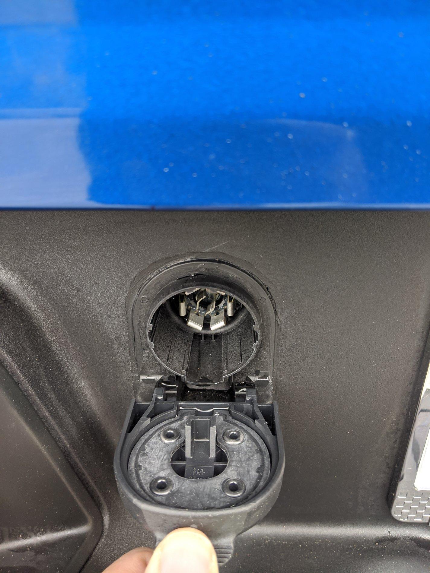

Update December 22nd
I finished the 7/4 pin plug install using Permatex Black silicone adhesive. I used blue tape about 1/8th inch away from the plug. Then spread a light coat to fill the edge where the plug and black plastic trim meet. First I spread it with my finger then used a piece of index card to even it out. The adhesive is very thick in consistency making me have to use both hands to squeeze the tube, once out it was very easy to spread with little to message and did not dry to quick allowing plenty of time to work with it.
