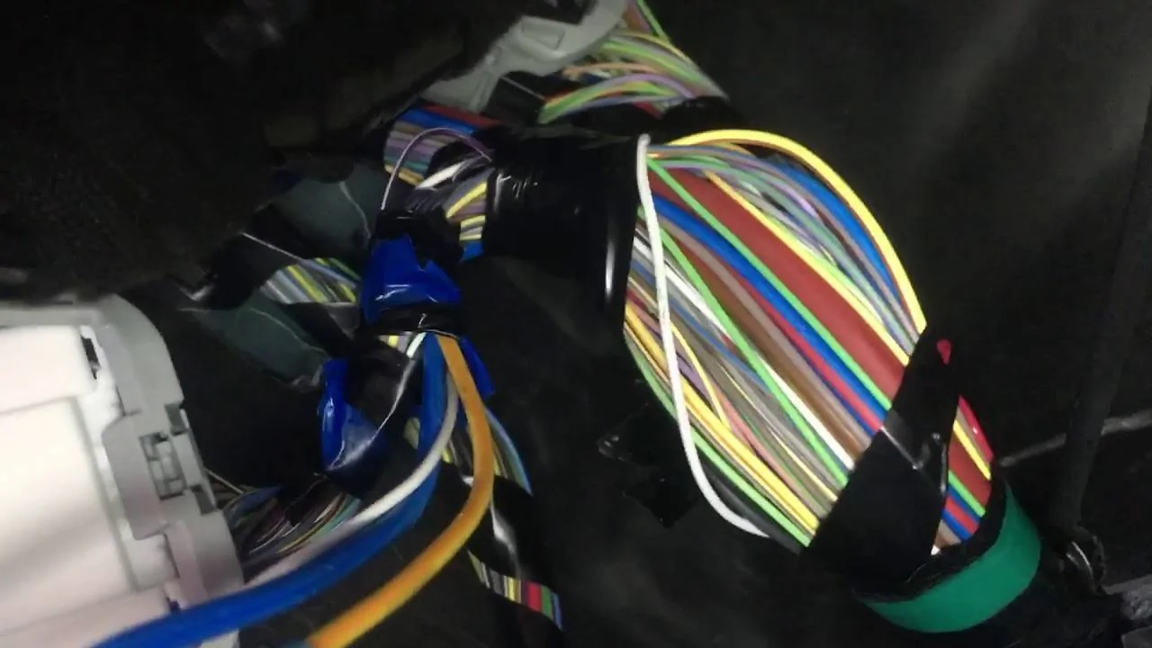

Does the non-tow package have the pre-wiring under the dash for the EBC?
IIRC, it depends on your trim level. XL does not (which I can confirm for my 2019), but XLT and Lariat do.
Do you have the tow/haul mode button on the console? Sounds like to get the full tow package they'll have to swap out the bumper and maybe added some wiring.
The tow/haul mode button and functionality is standard on all models, regardless of whether or not the truck is equipped with the tow package.
6,060
30,267
The tow/haul button and its feature is standard on all Rangers, tow package or not.
The wiring for the brake control may or may not be there. Some without the tow package have found the wiring, some have not..
Wires your looking for are 4 small wires taped to the main wire bundle under the dash to the left of the steering column.
Pic shows them taped with the blue tape, but could also be black tape.
