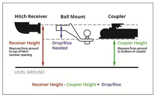

You want the top of the ball to be level with the top of the hitch cup on the trailer...
Back truck up to trailer, level trailer...measure from the hitch receiver to top of hitch cup on trailer.
That should give you an estimate of the drop shank you need. You are looking for the trailer to be level, or just a bit nose down.... trailer/boat rig is so light that if the trailer sits a few inches nose down, shouldn't be a problem.

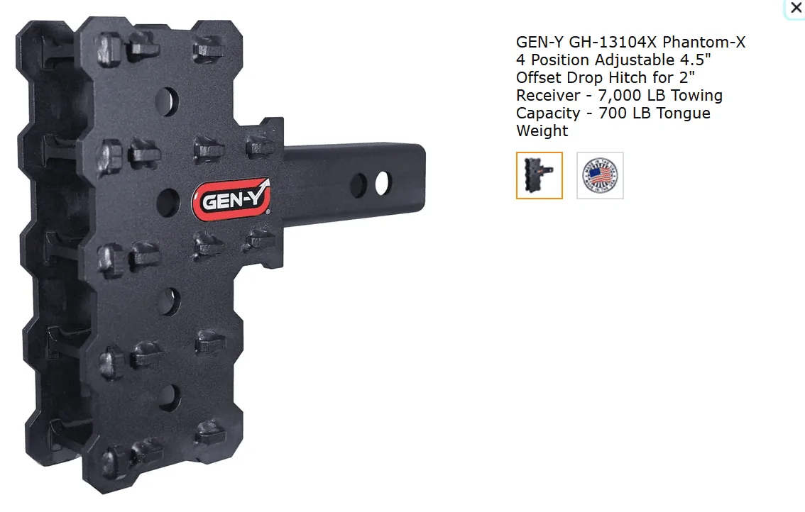

Your best option to avoid buying several shank sizes/drops is to get something like this...adjustable. Only thing you would need to add is the proper ball size.
This one runs around $100 bucks at Tractor Supply.

Rather than getting multiple hitches you might consider an adjustable height hitch. These are convenient if you tow multiple trailers as well, using a buddies utility trailer for the weekend, just adjust your hitch and go.
If your only choices are fixed drop I'd get the one with the bigger drop knowing I'll have to get something else later.

Also....contact the seller and just ask him to measure the distance from the ground to the bottom of the coupler when the trailer is level. You already have the truck so you can measure the distance from ground to top of hitch receiver. The difference will give you the drop.

yeah, there's no way to answer that question without knowing how high the trailer ball sits (every one is different)

I have a 1&7/8" ball trailer and a 2" ball trailer. I had hitches for my previous truck and instead of replacing them with different heights, and again with my next potential truck I bought a multi-height adapter which can be used in almost any combination.
https://www.amazon.com/GEN-Y-Rebel-Tactical-Hollow-Shank/dp/B08XBT3X4F/ref=sr_1_13?crid=2XOZIKDO9NZVW&keywords=gen+y+rebel+x&qid=1685719677&sprefix=gen+y+rebe,aps,96&sr=8-13
